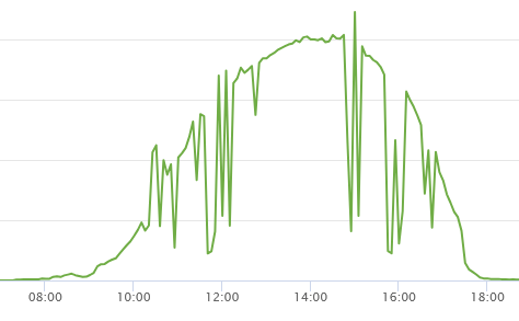

Before and after second battery.jpg Top with 3.2 kWh battery, bottom with 6.4 kWh battery. Clearly an improvement, unlikely to run out of off-peak or solar on most days, the 3.2 kWh gave me around 5 hours after off-peak or solar stopped, but 6.4 kWh clearly around double, so most days will reach the off-peak turn on time before the battery runs out.

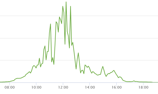

But yesterday for example 1729190416516.png just no solar, and battery needs some solar to reach when next off-peak starts. Now I only need two hours to recharge batteries from the off-peak, so I could switch off charging two hours earlier, but with bad days I would lose out.
2 hours = approx 1.4 kWh so only talking about the difference between the two rates, so 22.36p per kWh or 31p approx extra if we run out of battery, but loss is since not paid for export, hard to work out, today 4.5 kWh given away.

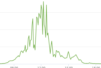

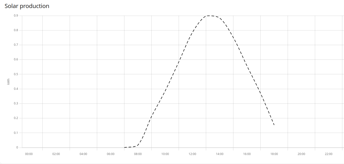

I put my coordinates and PV system details in to Home Assistant and it uses the weather forecast to predict solar production in the energy dashboard.
Never actually tested the forecast against reality. This is what it says for tomorrow:

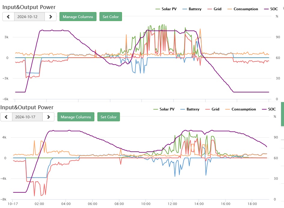

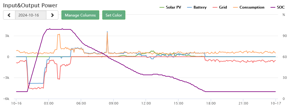

1729352164080.pngI look at yesterday, and today, yesterday after 13:00 we lost most of the solar, and we ran on battery until 23:17 when at 10% it stopped discharging, but today 16:30 and 10 kWh exported, battery full, still exporting at 1 kW.

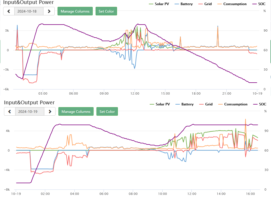

the problem are the drops outs when clouds come over, so I rely on the battery to bridge the gaps. And yesterday 1729368181200.png the way the sun failed in the afternoon, I ran out of battery before the end of the day. Yesterdays 7.8 kWh and today 19.6 kWh, but in the morning both days seemed similar. It was only after 13:00 that I lost the sun.
It is the purple line I watch, state of charge, ideally I want 10% left at 01:00, but the closer I get to 01:00 the better, clearly it is better for my heavy users the three washing machines to be run during the day, as at the moment day solar is free, as not paid for export, so better running the machines during the day.
However, if I misjudge, then it will cost more than running overnight at off-peak rate. 31.31-8.95=22.36p per kWh if I miscalculate how much sun, it does not seem much, but comparing Sept 23 to Sept 24 there was around £20 difference, mainly due to having off-peak now.
I have approximately 22 hours of battery power, clearly it depends on what I have been running, but if the heavy users, oven, hob, shower, dishwasher, washing machine and tumble drier are not being used, then if battery full at 15:00 then it will last with no more sun until 01:00 when off-peak kicks in.

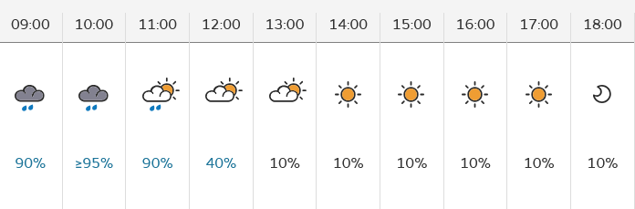

However, if full at that point, then likely I will also be exporting power for no return. So tomorrow met office forecast
looking at that, since sun 14:00 to 17:00 I should have plenty of solar power when it matters, never get much in the morning, due to direction at which solar panels face, but it is rare to run out of the off-peak power in the morning. Report is for Wrexham, and I am south of that. But tomorrow I will report what actually happened.

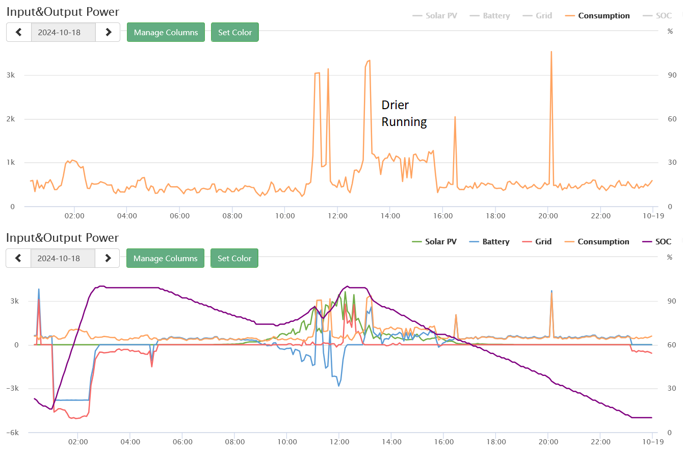

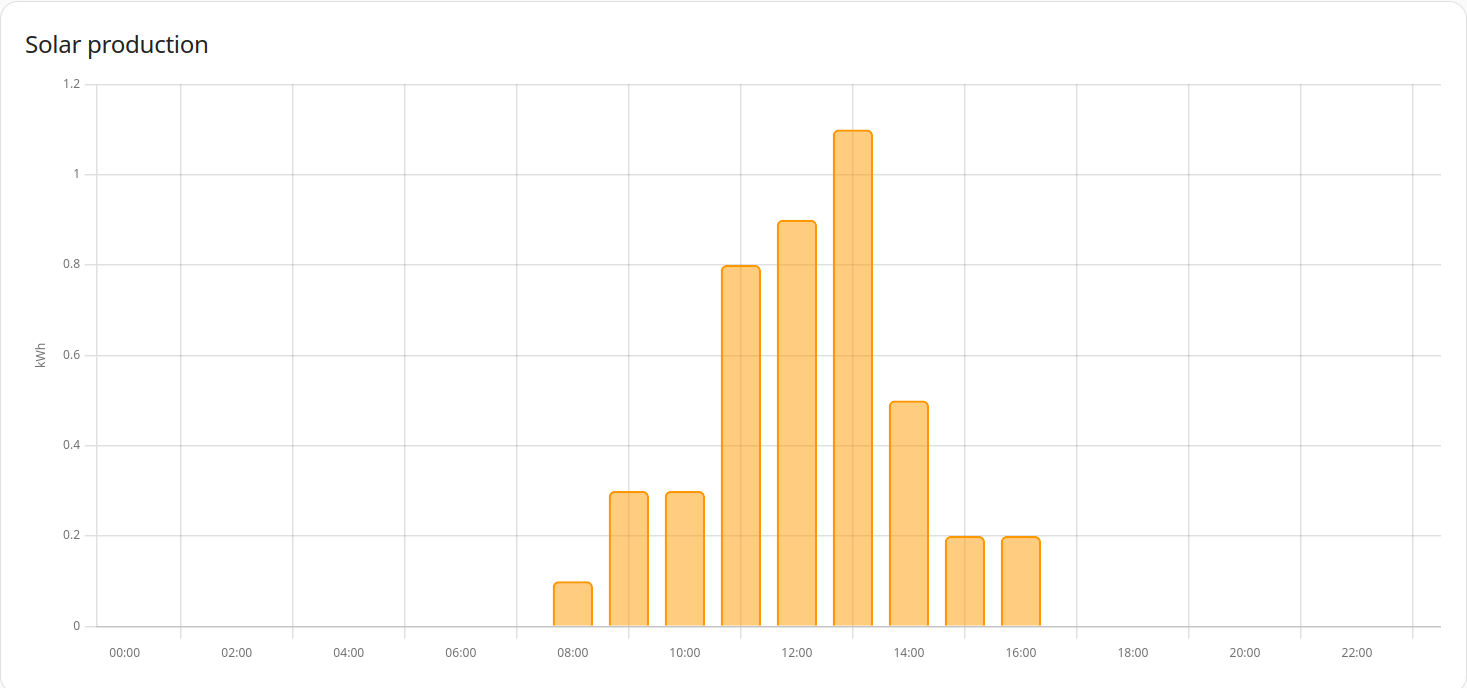

The drier was started when we had good solar, I had fully recharged the battery with solar, then the sun went in, 1729422379586.png what I want is afternoon sun, and it is a gamble.
