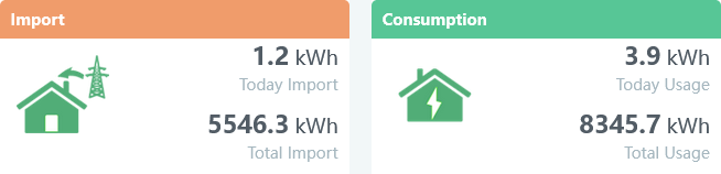

then that may be a good idea. But I found the charging from the grid, even with a fixed time off-peak rate, was costing more than a fixed all day rate. Yesterday I used 1.4 kWh from the grid, in spite of bad weather, so it says "As of April 5th, 2025, Octopus Energy's Flexible Octopus tariff, for customers who pay by Direct Debit, costs 24.50 pence per kWh for electricity." so 34.3p and to charge the battery (5.76 kWh) the rate would need to be lower than 6p per kWh to break even.

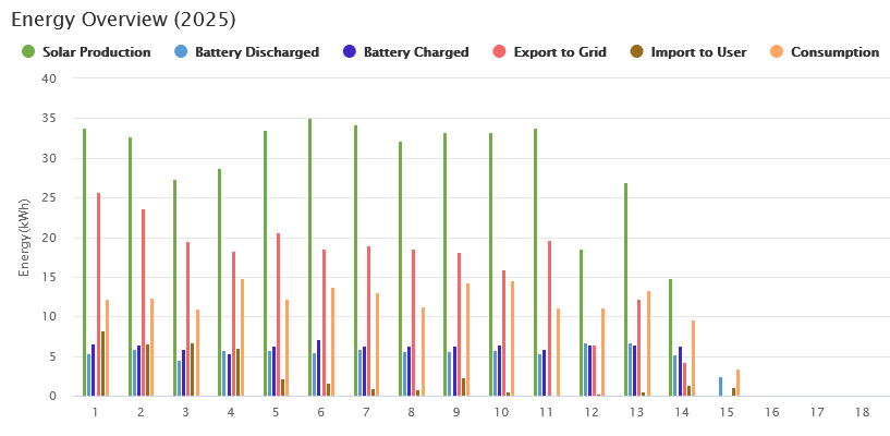

think I would prefer to watch TV! I note a new bit on the solar software
so at least now have an idea what we will get. Must check tomorrow to see how near.
