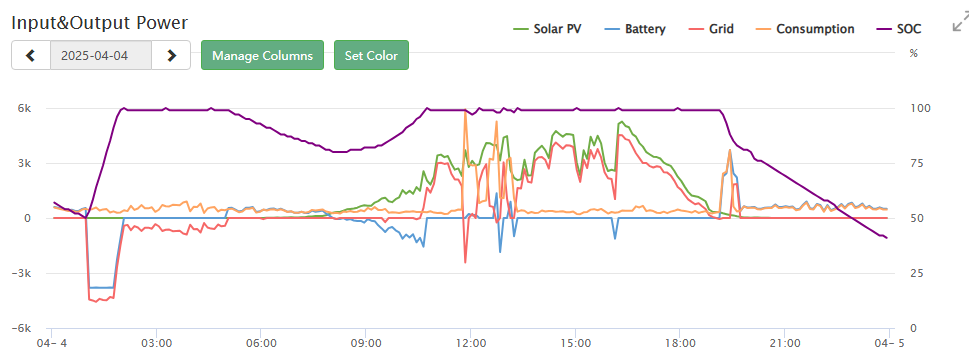

Two batteries with an useable capacity of 3.2 kWh each, but I choose to only use 90% leaving 10% for UPS should it be needed. One battery is needed to be allowed to export to some providers, and it stops the system flitting every time a cloud comes over from import to export, but charge rate 2 kW and discharge 3 kW so easy to have half charged battery and still export, or use just over the 3 kW so importing, so second means charge at 4 kW and discharge at 5 kW (inverter limit) so actually store solar energy when there, and can run small items as well as a 3 kW appliance.What's the usable capacity of the battery? - maybe that will help me understand...
What I had failed to consider was with off-peak, it would store more overnight so solar would be available before the batteries were nearly drained, this time of year half the time I will start getting solar before the batteries are fully discharged, even with no off-peak charging, so single tariff is best, but winter this all changes.
