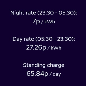

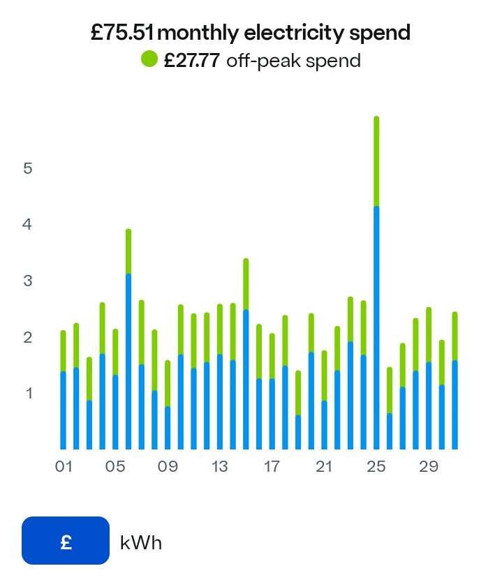

Since hardly any import this time of year, at the moment it does not matter. But December 2024, only 5 days, did I export, best 10.3 kWh, but many days down to just over 1 kWh. I use around 12 kWh, so to move 5.76 kWh from off-peak to peak time would likely help? But I am now well aware that last year I messed up.
I have tried looking at my records, but only this 1747047775538.png tells me how many kWh bought at off-peak, and how many at peak. I can see total for the days, but little breakdown between peak and off-peak. Total £75.51, Standing charge £18.34, Peak £29.40, Off-peak £27.77 so as kWh Peak 94 kWh off-peak 310 kWh.
So with a single rate, standing charge goes up to £21.13, and so the total would have been £123.67 remember this is the worst month. £121.59 if I consider the export.
But for December last year, I would have been better off with the split tariff (31.31p/8.95p) but this time of year, better off with single tariff. Last year 15th October fitted a second battery, so records before that date are not much help. And now getting paid for export. But November £62.98 with off-peak and £104.77 without it, that includes payment for export.
So it would seem Sept to Feb better off with off-peak, and March to August better off without it. But before was not being paid for export, now I am, and some tariffs mean export payments likely reduced. Was with British Gas last year, now with Octopus, and there are so many tariffs it is mind-boggling. And so easy to jump from the frying pan into the fire.
So the question is, what have others done?

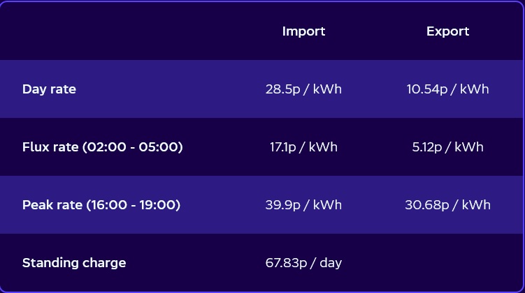

Ideal for me would be off-peak 11:30 pm to 1 am, that is enough time to charge the batteries, and also enough time between 1 am and solar being available to ensure a minimal amount will be feed back into the grid.
But the times are more like 2 am to 5 am, to have a reasonably cheap day rate (28.5p) but the off-peak is really not that cheap at 17.1p and should I run out 4 pm to 7 pm there is a massive 39.9p rate, that's the Octopus Flux. Oct Flux end April.jpg The Octopus EV rate seems too good to be true, 1747076138884.png I wonder what one needs to get it, maybe an EV, and it does not say what the export rate is. I tried to get answers from the website, and it seems some tariffs one has to give control to Octopus, so they tell your batteries when to charge and discharge.

Next is the control, I can set a reserve on the battery, so 10% is left for emergencies, and I can program it to charge from the mains at a set time. i.e. when I have off-peak, but not yet found a way to only 50% charge from grid, I must ask the installer. But also need to find what my options are with tariffs, the 8.95p/kWh I had with British Gas off-peak was clearly better than the 17.1p/kWh Octopus Flux offer, however on the peak rate, 28.5p/kWh Octopus offer is better than the 31.31p/kWh from British Gas, the worry is the 4pm to 7pm 39.9p/kWh.
17.1-10.54=6.56p/kWh loss is better than the 8.95p if I end up re-exporting it. But also 10.54p is a lot less than the 15p I get now, and it seems the suppliers just like making the maths a problem, and I reach out to @Munroast who it would seem has the same problem. Hopefully once worked out, we can just sit back?

4th April 2024 to 15th October we were charging 2.88 kWh (26p) every night so it would not run out before the sun started producing, after 15th October that went to 5.76 kWh (52p). This was OK until March, although we were exporting for no payment what we had imported, not all of it, until April when we were loosing £16 a month.
Since flux pays for export, it would be a 38p per day loss, so £11.71 a month loss. The problem is to move to Flux payment drops from 15p to 10.54p it seems looking at pennies, well we are, but when I look at a month rather than a day, then I see winter bill raise by £20 unless I go off-peak.
