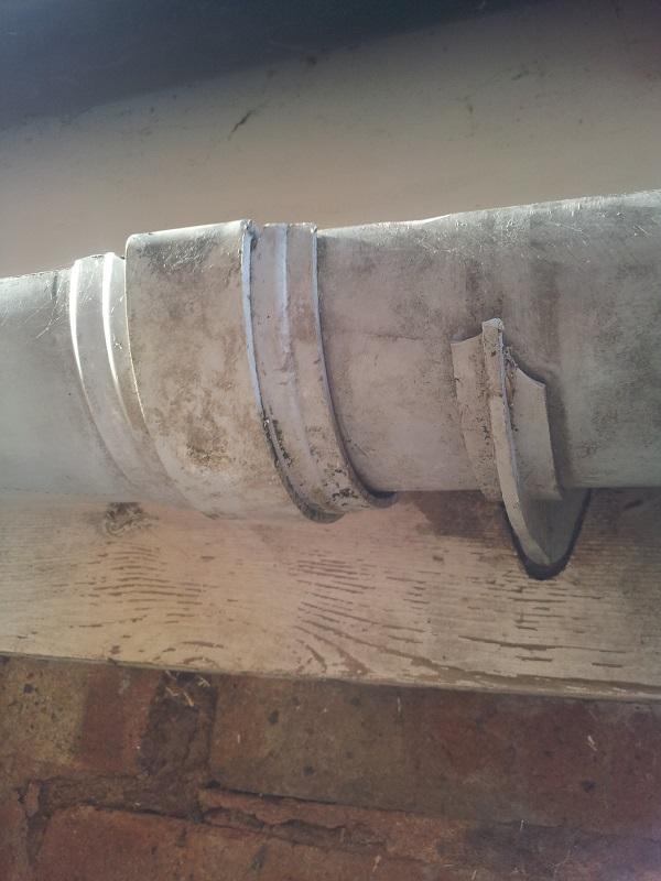

I need to replace 1 6ft section of gutter. I've searched online and asked at my local wickes but can't find a gutter with the overlapping join at one end (as shown in attached photo). All the ones I've seen have clean cut ends with a join attached separately.
I would rather source the existing type so that the repair has a better finish (its 1 section of about 8 ).
Does anyone know where I can find this type of gutter or even what it is called?

to the left of center of that fitting looks like some sort of adapter to me.
and it doesn't look like its part of the gutter to the right of it.
That`s Marley 4 inch gutter - it was a PITA back in the 80`s ( you need a special notching tool for the ends) and it`s not available now :cry: Why do you need to change a whole length ?
There is an adapter but underneath is part of the gutter with the steps
You're right, that's the bracket which granted also needs changing.
Yep, 4 inch inches in width. That's it, thanks. 1 6ft section out of about 8 is leaking. I was hoping just to swap out that piece to get the gutter working properly.
It's on the side of the garage, so I think I'll have a go at sealing it first. Otherwise, I guess I'll just have to change the lot.
Thanks for the help.
