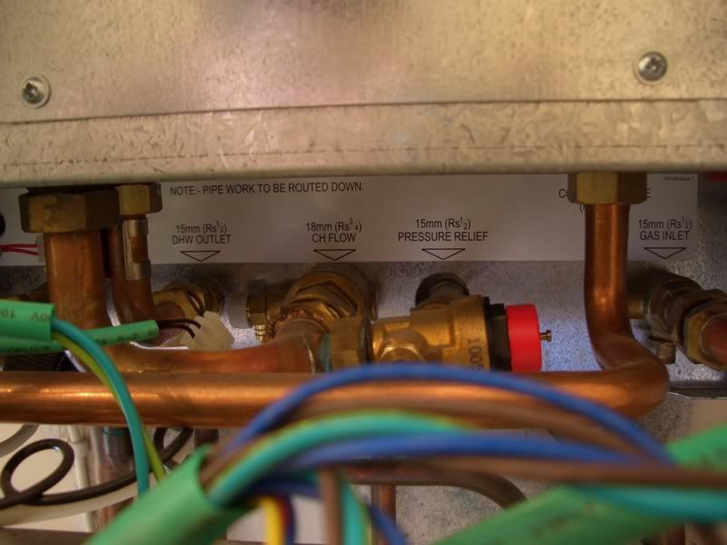

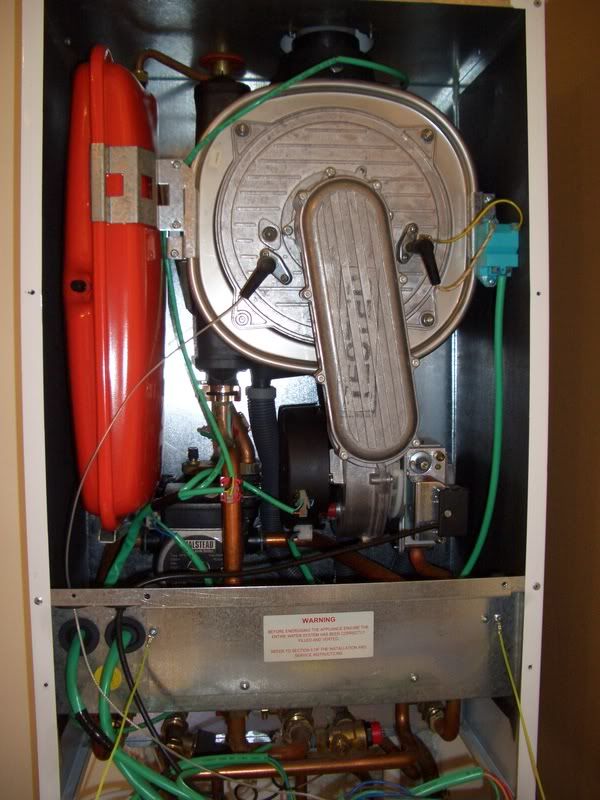

This is the boiler with just the front cover off:
I just snapped these quickly as I thought it might help

It will probably be the motor on the Hydro block, its not like an ordinary divertor valve its built into the pump assembly but very easy to change, and doesn't involve any draining or disturbing of the gas pipework. Just make sure you have the power turned off.

There is a small screw visible from the front, take this out and after you have pulled off the electrical connection the motor either drops out or pull it out, down the way. You can then get hot water if you turn off the isolators to the CH as the actuator is in the middle so water passes through the plate H/ex.
If you connect uop the socket to the motor it should position itself either in or out to push the actuator arm. If it doesn't move its at fault and a new motor required. If your not electrically minded it will show what is wrong without having to check resistance's. If its operating ok then I would go for the flow switch. Check the instuctions it will tell you how to change it.
