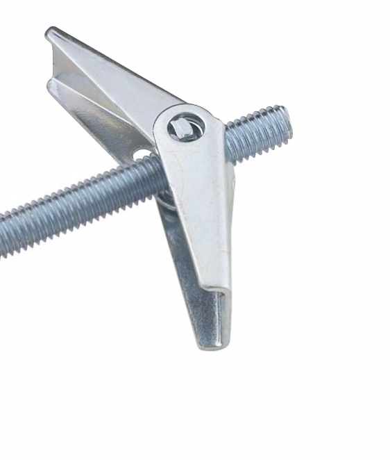

we've just done the same thing, we mounted a 42" smart tv onto a stud wall and used these
https://www.amazon.co.uk/snaptoggle...id=1494101535&sr=8-2&keywords=toggle+bolts+m6
Its a solid as a rock u could swing off it, the other toggle bolts suggested above were quite fiddly to use, as u had to press the two toggles together down to the screw before u put them in the hole,
the snap toggles have the drill bit supplied, as u put them in the hole, pull the white sticks forward whilst pushing the round bit into the hole, snap the long white sticks off and there u have it, put the screw in and hey presto its done.

Personally I think these are better
I'm not a fan of those myself, if you need to take the bracket down to paint the wall, the threaded bit falls down inside the wall and you have to buy some more! I much prefer this style...
The downsides of these is that you need to know beforehand whether the wall is single or double plasterboarded, to be able to buy the right ones and you really ought to use the setting tool with them, so more costly initially. I've found that with the M6 ones, they will clench up properly without the setting tool, because the flange and the spikes are so much bigger than on the M4 and M5 versions.

Used them as an apprentice, but I had the setting tool you mentioned, when i tried them a while back without the tool I pushed so hard the thing went through the board.
Though must admit they are ideal for putting a permanent thread in the wall.
I wish they didn't have that dual Phillips/slotted head. Torx or Allen would be so much better and prevent that happening. Even just a normal Phillips or pozi would be better! :rolleyes:
The M6 ones I last used were actually to put a threaded rod into with a nut and washer, they are so strong you can really sense how much they will take when using a spanner, I'd like to find out the horizontal pull-out force, but they always give the shear pull out strength, because it's the higher figure always.
I did clench them up with the cr@ppy screw provided initially though (just to clarify with my previous post about them clenching up fine without the setting tool).
Gaz :)
