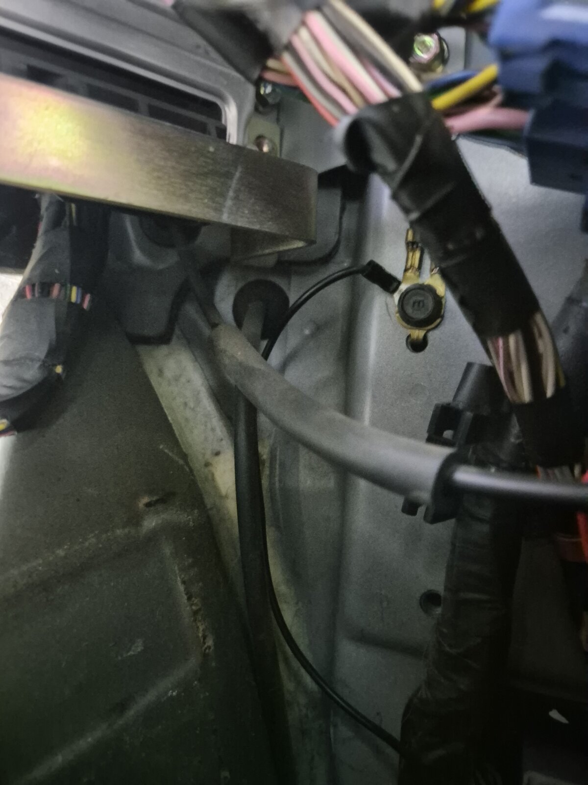

Hardwire dashcam not working
Yes, definitely.
That's why I linked to the specific video for installation in a Hyundai (although not the OPs Getz).
At @2 minutes in, he does a continuity test, showing the fuse board screws weren't grounded....
Even if the bolt went into metal, there is no guarantee, on modern vehicles, the metal has any connection to chassis. The only way to be sure of a proper termination to chassis, is to find a chassis earth terminal. Often this will be tucked behind a kick panel, on the inner side metal of the front wings. A bolt with lots of other cable lugs on it.
Thank you for all your help, I changes the earth to something on the chassis and it works!
