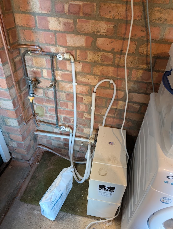

Hey folks, we had a new combi boiler fitted about 3 weeks ago - the existing boiler was an old gravity based one in the garage, and it was replaced with a combi - all pipes were available except hot water - so they went into the cloakroom (in pic you can see the pipe that has been recently filled around) to get a hot feed.
I've noticed since then, the water softener salt is not going down... So would I be right to say they have bypassed our softener? Not really ideal as I wasn't told about that - I know it's not the newest softener but it worked!
Both the white levers are turned to Open/Soft and the brass tap in the middle is fully open to the left (anti-clockwise).
The boiler is pretty much to the left of where the picture is taken from.
Would appreciate any advice before I go back to them to check, thanks in advance! :)

Going by the hose union tap it looks like new cold connection was made on incoming supply to softener rather than softened side.
If you can use softened water in your combi needs pipework altering. I'd be swapping those small flexi hoses for larger ones (connections are the same)
Brass stop tap if fully open is allowing mains water to by-pass rather than push the water through the softener. Close it to ensure softener works? It's there to allow the softener to be isolated for repair / maintenance purposes but still allow the house to have water to use.
What make and model of boiler has been installed? Check the manufacturers' instructions for any mention of softened water use (in domestic hot water and/or sealed central heating circulation).
Ahh - So I may need to close that tap instead! It's a WB 4000 30kW Combi

Mentions that artificially softened (ion exchange) water must not be used to fill the central heating circuit - that with inhibitor in. {Much as my hot tub says to fill with tap water}
The MIs suggest ways to provide the boiler filling loop with un-softened water.

Worth calling to ask if they had temporarily bypassed for filling the boiler... and forgot to re-close the tap, or????
They did say they would bypass it to fill the boiler - as you say they likely then forgot to re-close it - I am pretty sure last time I closed that tap we had no water in the house but i'll double check tonight!

If the top pipe (where there is a new tee off) is the cold mains to the water softener, and that new tee feeds cold mains to the boiler, then this branch is not softened, meaning that your hot water is not softened.
It needs to be determined if the combi allows the use of softened water for the domestic hot water, even if it doesn't allow it for filling the primary system for CH.
They are 2 different things.
If the cold supply for the boiler is softened and the boiler has in integral filling loop then, usually, the water softener has to be put into bypass mode when filling the CH system and boiler.
