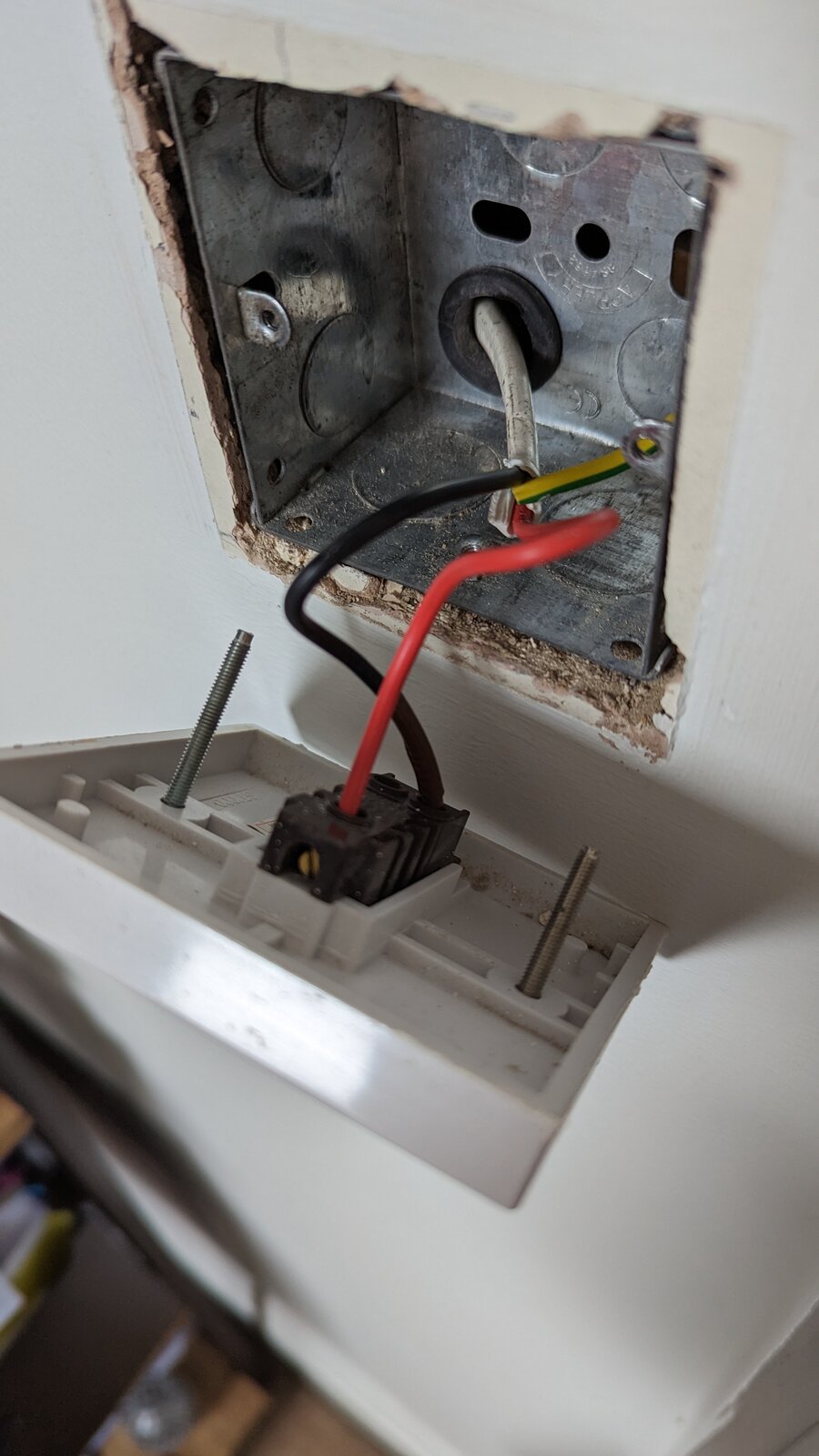

I'm trying to replace a 1-gang light switch due to a faulty toggle which keeps falling out of the switch plate. I've attached a photo of the existing circuitry, but it consists of fairly straightforward live and neutral in to the switch, and an earth cable which is screwed in to the internal metal housing.

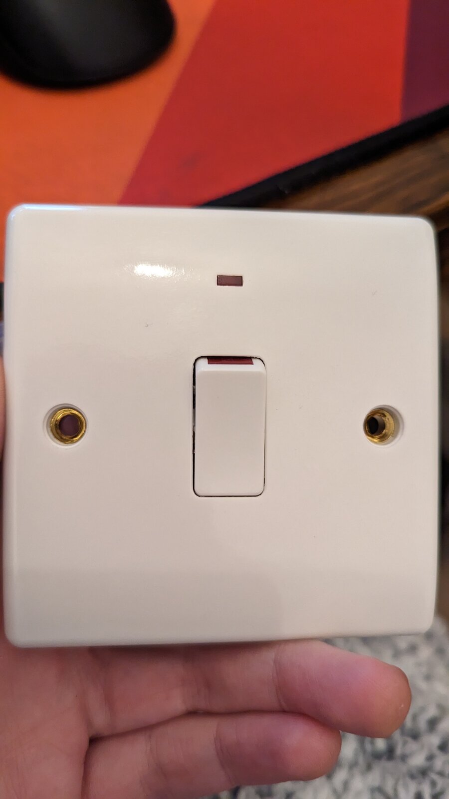

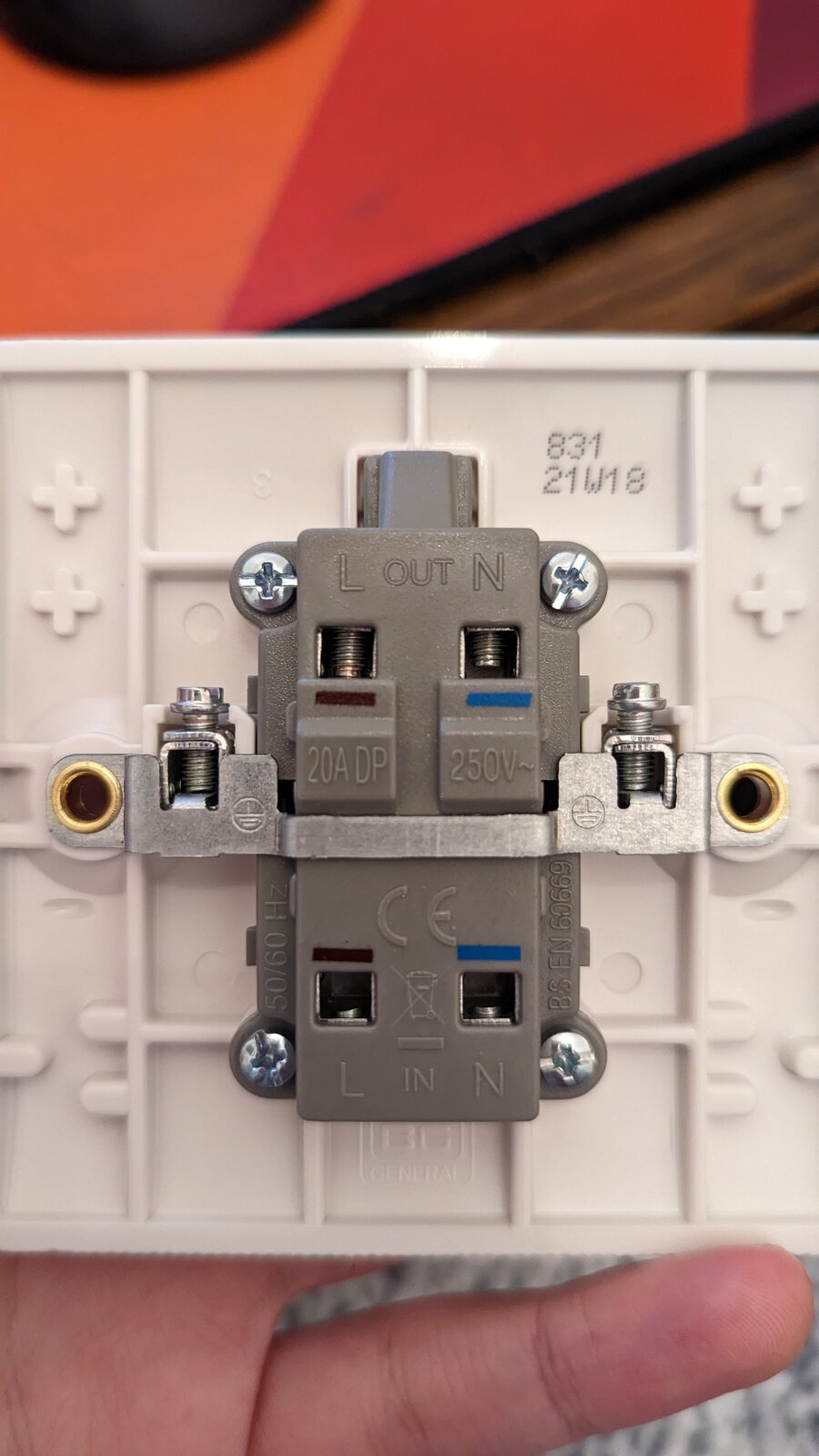

The replacement that I bought is also a 1-gang switch, but has a power LED, and it seems to have L and N in, along with L and N out. I've tried googling but all the 1-gang light switch documentation I've found only references COM, L1, and L2, so not sure what I'm supposed to do with my replacement.
:unsure: The black wire is not a neutral. It is the switched live.
It's not really the right type of switch, but if you like how it looks, put the red in L IN, and the black in L OUT. Leave the earth where it is.
If you were hoping for the LED to light up... it won't.

Put the red in L IN, and the black in L OUT. Leave the earth where it is.
Thanks. Yea, don't really care about the LED lighting up tbh, happy enough for it to stay off
