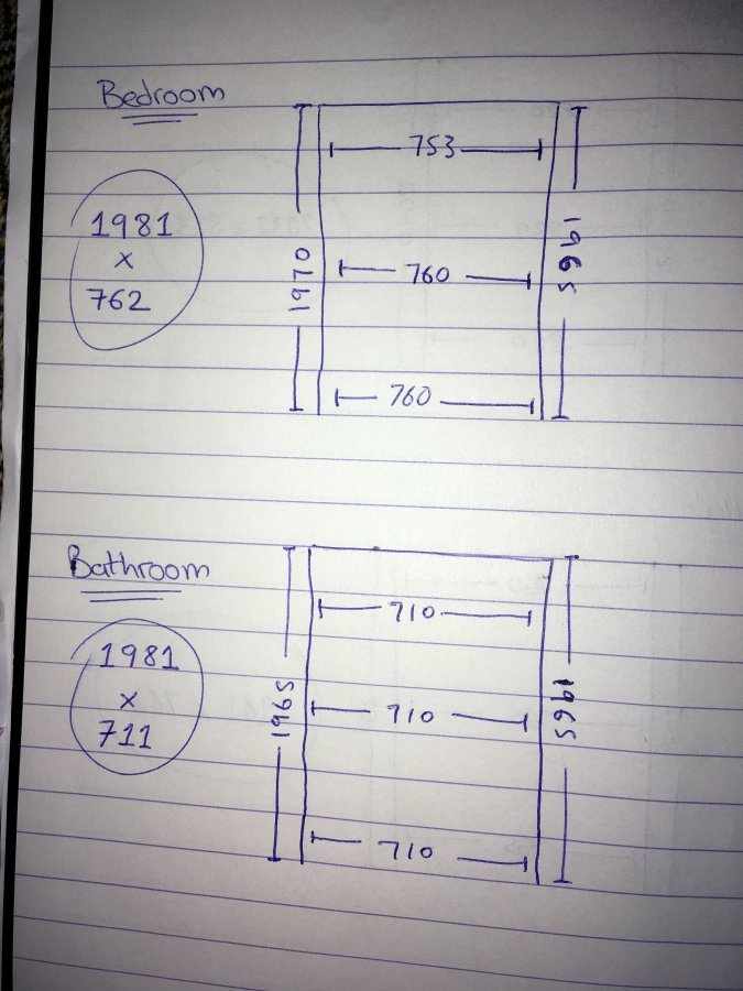

I'm gearing up to buy 4 new oak veneer DX30 doors and wondered if anyone with experience could tell me if the sizes I've picked look ok (if you turned up to fit them) please?
About the doors:
Trimming allowance: -
8mm (0.3") each stile
8mm (0.3") top and bottom
Lipping size: -
16mm (0.65") on all 4 edges
Note: I'll be packing out the cellar frame to lower it to suit the 1981mm door. I'll be re plastering and changing the arc anyway so it will be easy enough to do as there wasn't a 2032mm to suit the width.
Any advice would be really appreciated.
