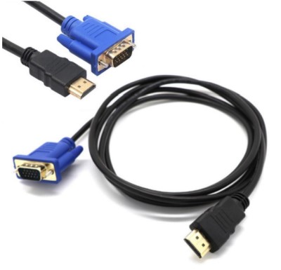

@Justin Passing , your info is a big vague on things such as makes and models but the image above does help.
HDMI out to VGA relies on active signal conversion. That means a simple wired cable such as the one in the image below won't work.

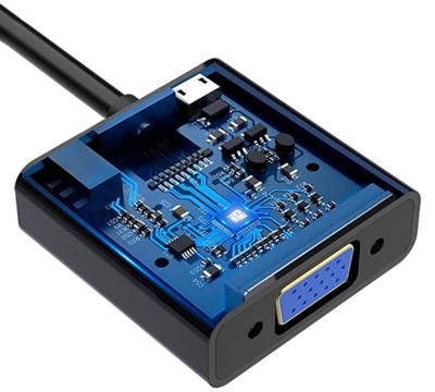

However, it looks like you've got something with active conversion where there's a circuit built in to convert digital to analogue. That explains why there's a power connector.
Regarding the power connection; HDMI includes a 5V power rail in the connection to power the receiver chip in whatever sink device an HDMI source is connected to. The idea was that even if say a display as a sink was not powered, then with the 5V rail power in the HDMI signal the source and display could do a handshake to work out a common set of display and audio parameters. More simply, the source asks the display what audio and video settings it supports.

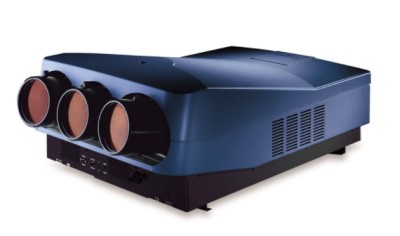

There are HDMI to VGA adapters which get around the HDCP issue by spoofing the source device in to thinking it has a valid HDMI-compatible display in the signal chain. I used to use these quite regularly to connect Blu-ray players and games consoles to high-resolution home cinema CRT projectors such as Barco Cine9s, 1209s, Ampros and Electrohomes.

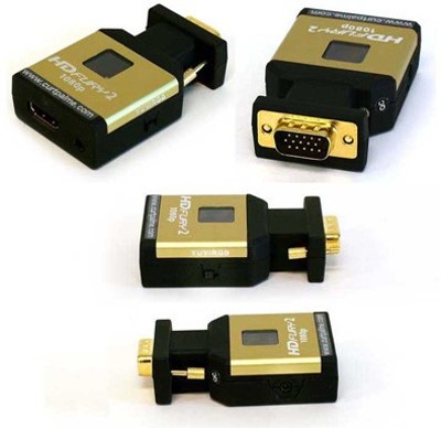

The catch is that these adapters weren't "a few quid" off Ebay or Amazon. The best known was the HDFury range. The models evolved as HDMI standards changed, but for cost you were looking at £200-£300.
The price was kind of acceptable since it was a unique solution, and in the context of getting Blu-ray to work with a £20,000 CRT projector it wasn't going to dent the owner's wallet too badly. For owners of second-hand CRTs though where they'd spent maybe £3,000-£5,000 it was a bigger ask. After a while I managed to find a cheaper alternative for around a third of the price. The image quality was good enough with all but the highest-resolution CRTs.

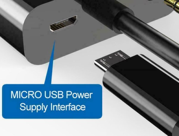

Read the text from the picture you posted
Power supply interface
Power. Supply. Interface.
Power
Supply
Interface
Getting the message yet?

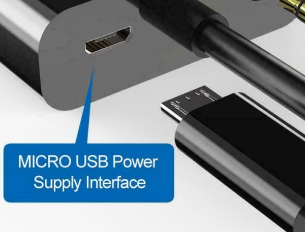

Power
Supply
Interface
