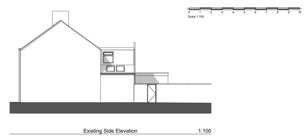

Hi all,
Would very much appreciate some advice. I'm considering the feasibility of a loft conversion where the initial head height availability is 2.3m. I'm (probably) looking at a room-in-the-roof conversion with Velux CAMBRIO style windows rather than a dormer due to Planning constraints. I've got an architect and from conversations with him I reckon that I can make the stairs work.
My questions are:
* If I'm willing to pay (reasonably) over the odds, then what's the most efficient solution from the perspective of maintaining head height; and
* People's general sense of the usability of the space post conversion (I should note that I live in Oxford, where houses are generally pricey and small).

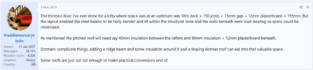

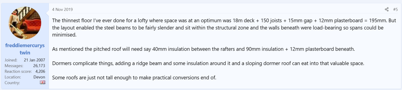

In terms of the spec, the most efficient solution I've seen from a joist perspective is the 195mm referenced by FreddieMercurysTwin in a previous thread (see attached). I *think* that's measured the the bottom of the current ceiling? If so I reckon that means that I'd only lose about 500mm from my current configuration...
In terms of the rafter insulation everyone seems to reference the need to use ~90mm Kingspan PIR style over the rafter, but is there a reason that I couldn't use Spacetherm instead? I haven't modelled it, but from looking at the technical details it looks to me like I'd be able to shave off at least a third off that, maybe a little bit more (since it incorporates a thin plasterboard).
If so, then my losses should be:
- 500mm from the floor joists; plus
- 600mm from the Spacetherm plus say 10 for the MgO board plus plaster.
Gives an estimate head height loss of 1000 to 1200mm? That'd leave a post conversion head height of about 2.2m along the pitch of the roof...

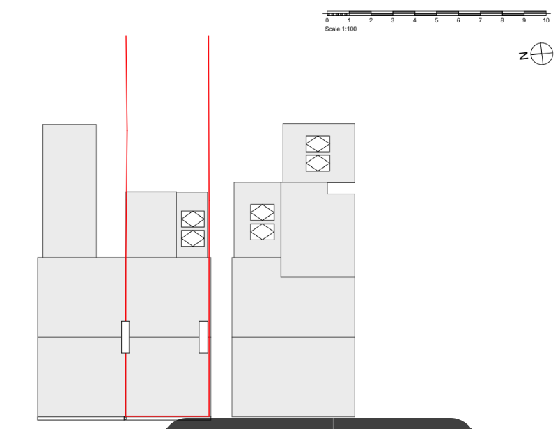

What planning issues do you have that prevents the obligatory rear dormer? Who will be using the loft conversion? Someone who's 6'6"? Do they spend hours of the day walking about up there or just get dressed/undressed? Otherwise why are you fussing about a few inches here or there.

I live in a conservation area and so Planning Permission isn't a given; I want to do a 1st storey extension also and have been advised that it's an either/or situation. Thanks for the other advice; I hadn't realised that the height above the stairs was the only real height requirement.
