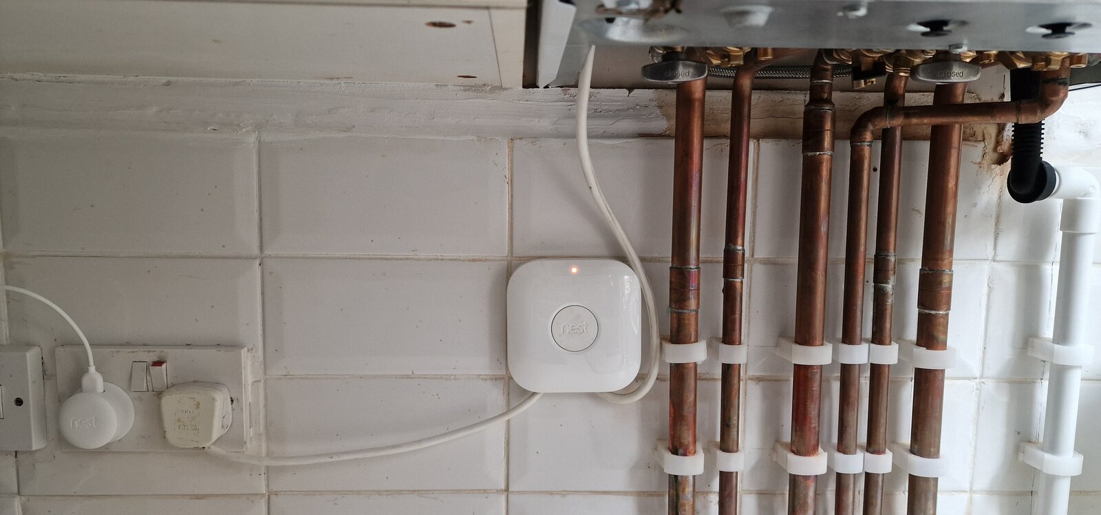

Just had a new boiler installed this week.
Part of the job description was to install a dedicated fused spur where the boiler will be powered from and also connect to the existing Nest controls (heat link and thermostat). I'm very happy with the plumbing aspect of the job. But, I'm very concerned with the electrical connection. Is the setup in the pics correct?
From what is visible nothing looks wrong. I am assuming 4 core or above from heat link to boiler? What is the boiler that is fitted?
With Nest Gen 3 one can connect the boiler using OpenTherm if the boiler will allow that, and in the main power goes to boiler then to heat link so it is supplied through the boilers own fuse, but there is nothing one can criticise from what we can see and has be written about on your post.

The heat link is plugged into the mains switched socket and the boiler in turn, is powered through the heat link. It's the new Vaillant ecoTec plus 832 model. In the manual it states that it should be connected to a 3amp fused spur, hence my post.

Nothing much wrong with it, except I would expect a single point of isolation for the entire heating system, and it's controls - that hasn't been done. The boiler has it's own supply, the Heat Link a different one.
The boiler is being fed through the Nest...
So it has got the single point of isolation.
It is acceptable for the boiler/Heatlink to be supplied by an FCU, or a plug, so that isn't a worry.

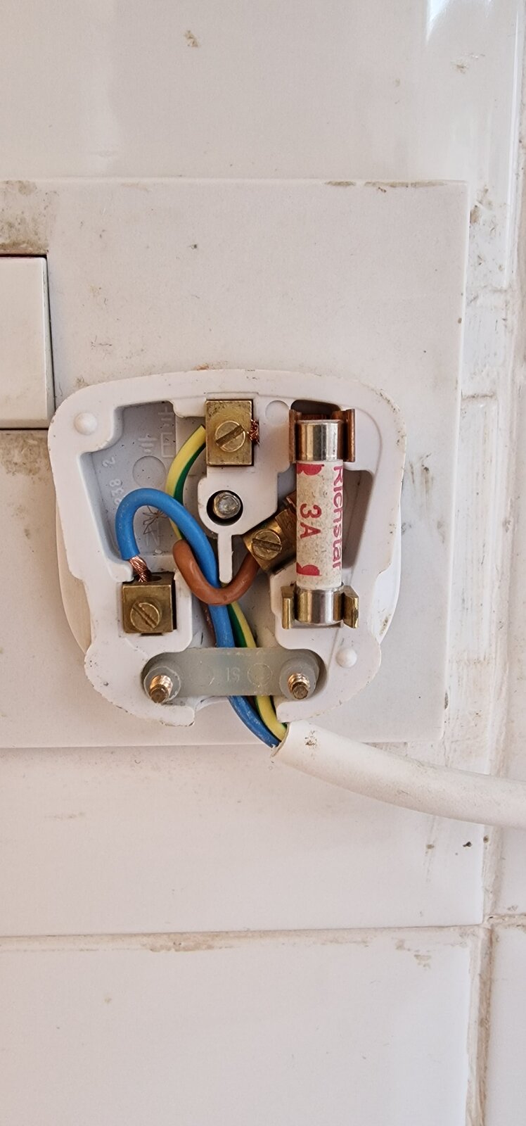

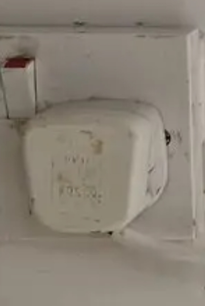

The problem is, the wiring of the plug has been done very poorly - they look to have reused the existing boiler plug and cable.
The cable is strained and it appears the inner cores are exposed.
Which may not say much for the rest of the wiring.

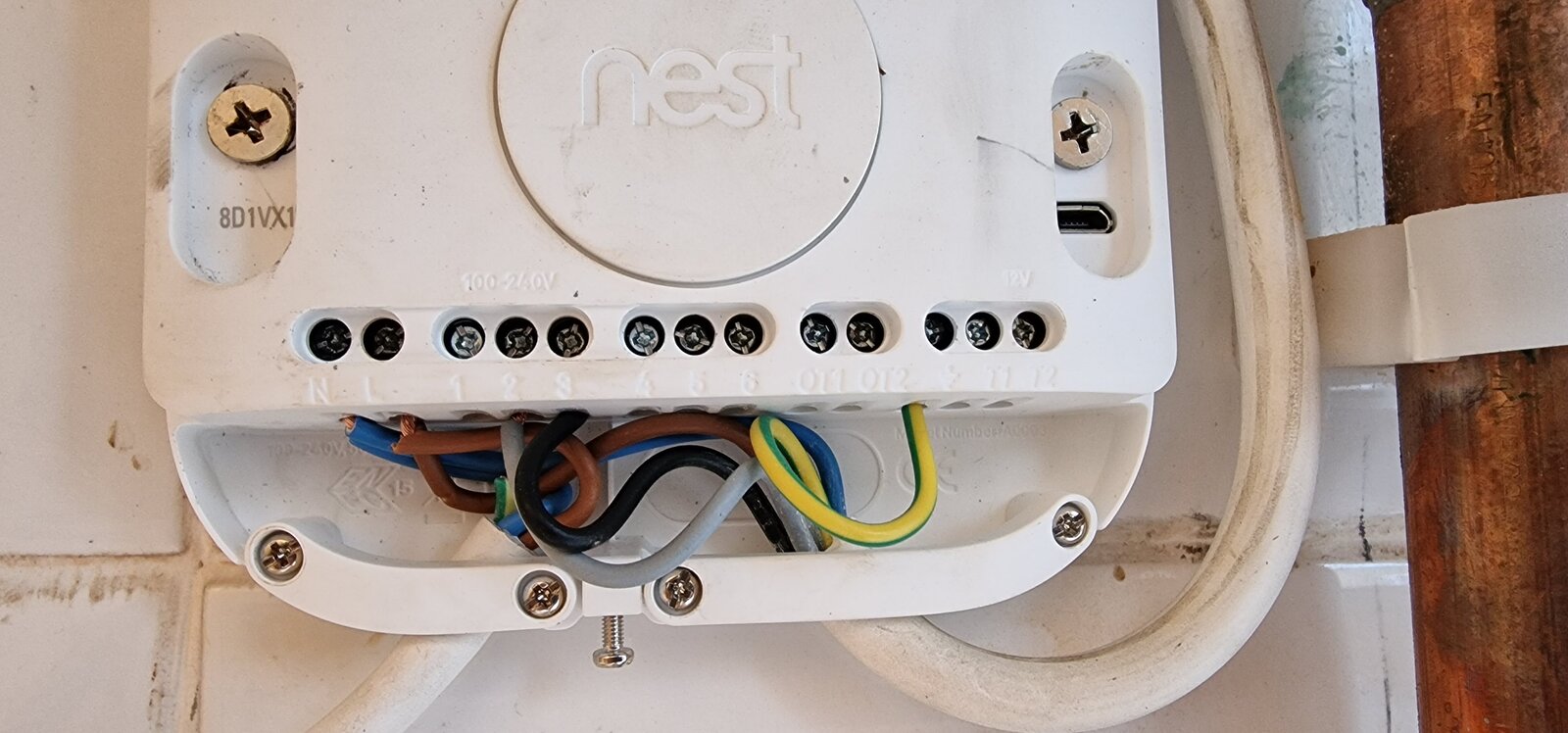

Can you remove the cover of the heatlink and show us a picture of the wiring behind, and one with the plug top removed?

Pics attached. I noticed that the heat link itself is not earthed, although the boiler is connected to the earth point of the heat link.
You've been left with a potentially dangerous installation, where the boiler hasn't got a (direct) electrical connection to the earth*, the inner cores of the lead are exposed, with inadequate cord restraint, and they haven't provided you with an FCU that was part of the quote.
Turn the boiler off, remove the plug from the socket, and if you feel you can trust them, get them back to do a proper job.
*It's likely that the boiler is indirectly connected to an earth through the gas or plumbing pipework - if it wasn't, the boiler would likely not fire up. Although this indirect connection shouldn't be relied upon!

The heat link is class II so does not need an earth, however any installed cable should have an earth, so there is provision for an earth for when the heat link is used to supply the thermostat, since your heat link does not supply the thermostat the earth is not required on the heat link, but it is required on the boiler, and it seems it has been cut off short.
