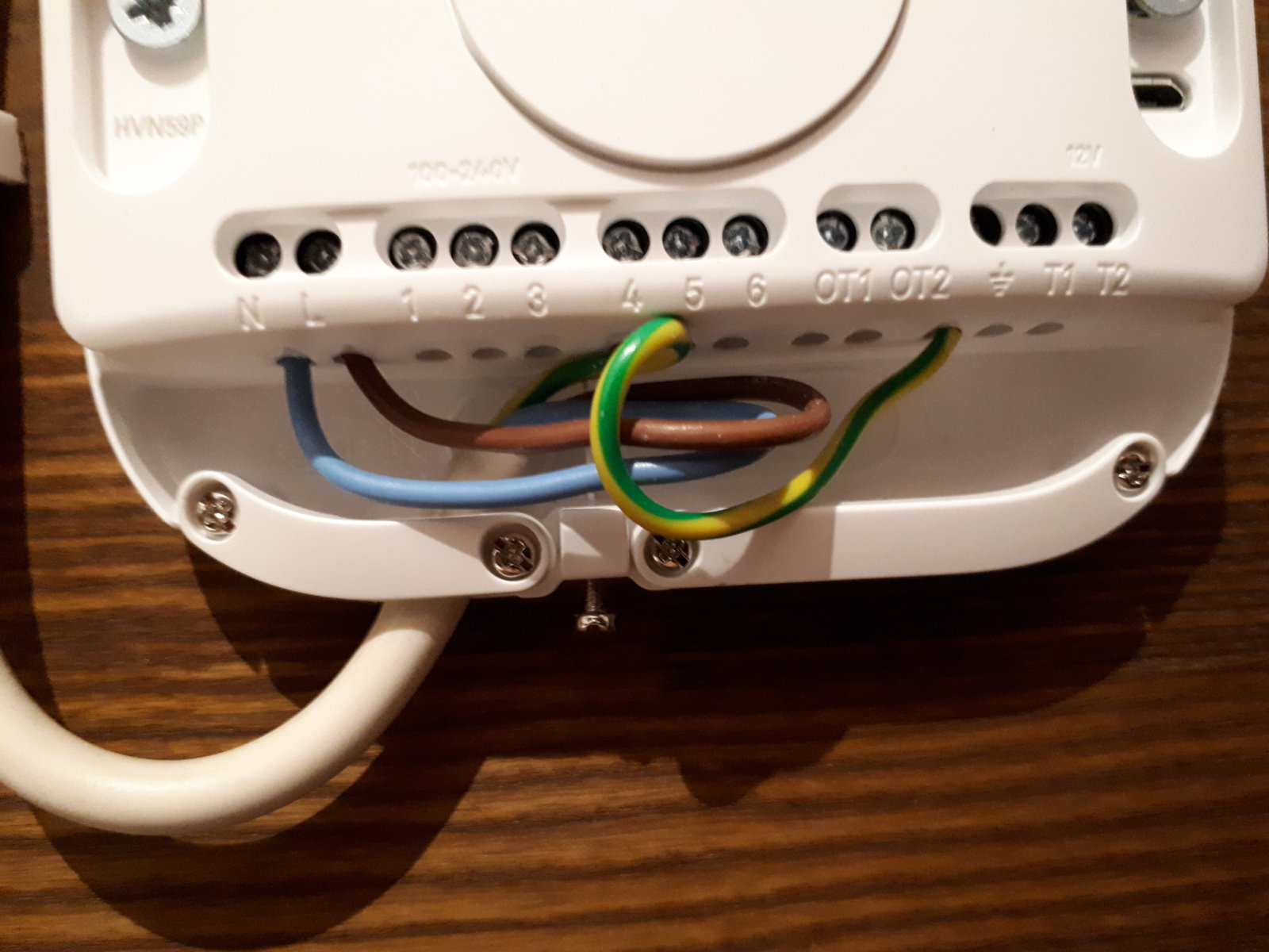

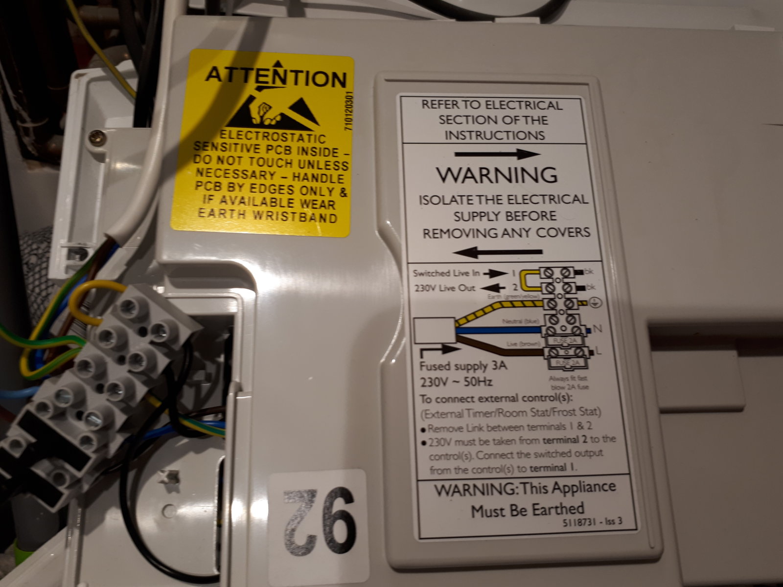

Afternoon All,
I've been trawling threads and Google for help. We've recently had an extension built and a new boiler installed. On asking the plumber to install the Heat Link he stated not his job and on asking the electrician he stated the same. This went on until electrician agreed. Any how in trying to set up the thermostat the Heat Link was found but unable to control. On Investigating the electrician had only give the Heat Link power and not connected any boiler controls.
It's a Baxi Duo Tec 33 and Nest 3rd Gen. I've attached some pictures and hoping someone could shed some light on which connections I need to make.
Many Thanks

Thanks for taking time to reply EricMark. Any idea on the wiring for Heatlink to Baxi Boiler?
The yellow link wire would normally go to switching device. It states 230 volt so the device needs to be rated at that voltage. For the I found this PDF however this shows one relay contact your picture shows two so I would assume yours also does hot water?
I looked into the idea of Nest and I must agree the instructions do seem to leave something to be desired, I found this
which seems to show terminals 2 and 3 would replace the yellow link wire, and T1 and T2 goes to thermostat. If the unit does not do the hot water, however if it does do hot water then the terminal 2 and 3 will likely go to a motorised valve for heating and 5 and 6 to the motorised valve for domestic water heating.
In fact often not as simple as that, job one is to work out which plan it follows, we have a selection of plans like W and Y most written by Honeywell and followed by most electricians and plumbers, some give priority and some simply share. I am guessing since yellow link in place you have not got domestic hot water from the central heating?
There are other methods but since we are really all in the dark as to what you have best option is only a guess.
The Baxi Duo Tec's I have seen have all been combi boilers, so if yours is a combi also, then the Nest Heatlink hot water terminals 4, 5 & 6 will not be used.
Then as ericmark says remove the yellow loop between the boiler terminals 1 and 2.
Connect boiler terminal 1 (Switched live in) to the nest terminal 3 (Heating call for heat)
Connect boiler terminal 2 (230v live out) to the nest terminal 2 (Heating common)
As there are no connections made to T1 & T2 at the Heatlink, the remote Nest Thermostat will need to be powered via its own separate plug in power supply.
Stem / EricMark - Many thanks for your answers. I wired up the Heatlink last night and the Nest thermostat now controls the boiler...:)
