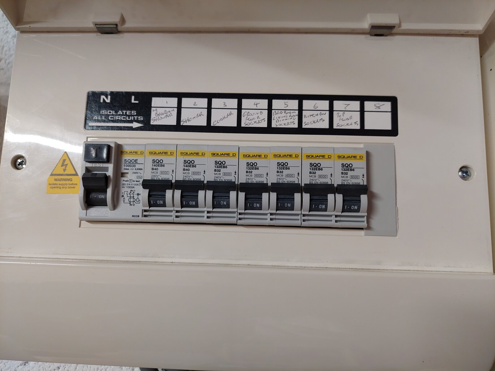

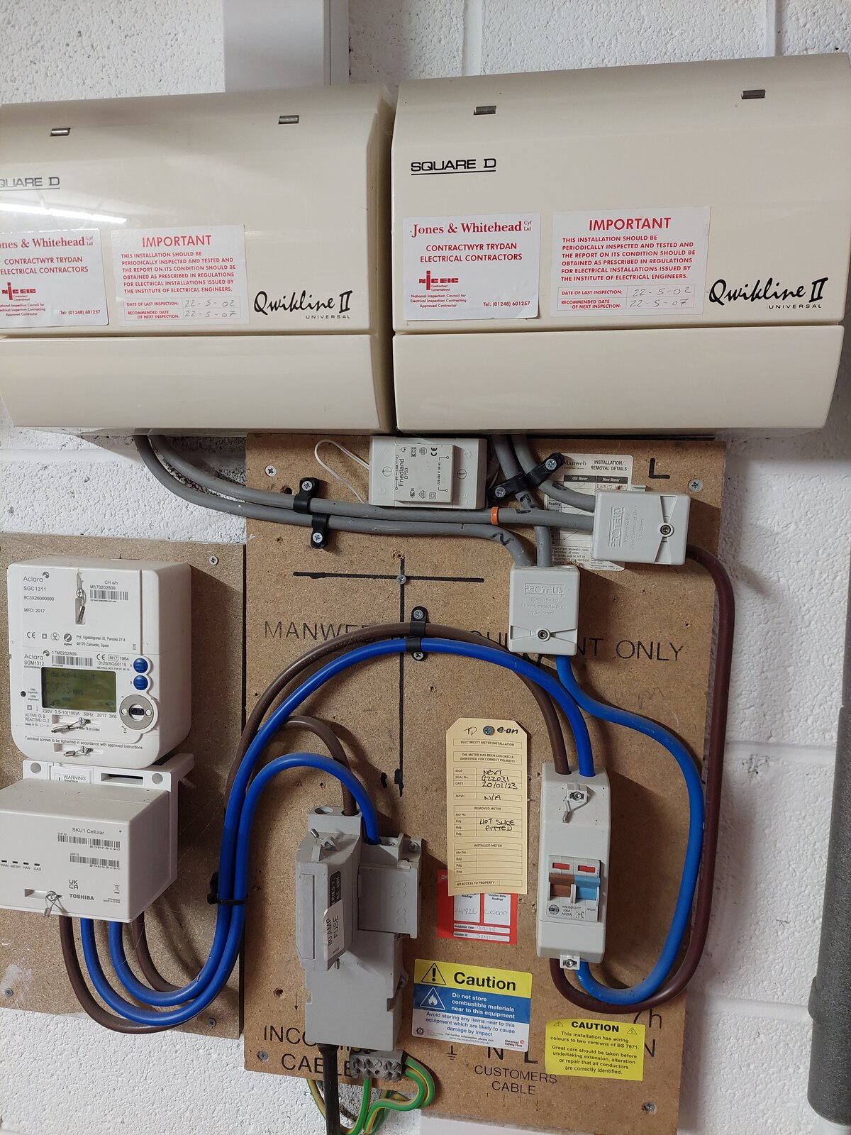

The device on the far left is an RCD.
Get a torch.
Press the "T" button. What happens?
The T (test) button trips the power. So an RCD?
Many thanks JohnD for pointing this out.
Then, just a standard FCU needed, plus a suitable flex outlet in the bathroom..
