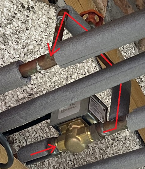

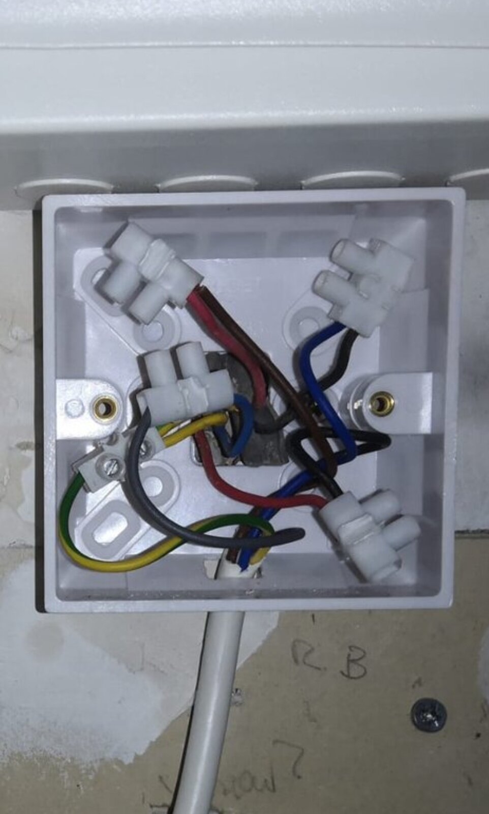

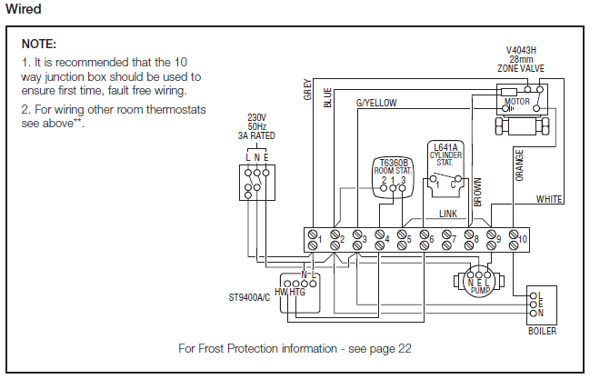

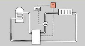

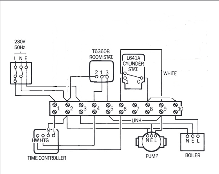

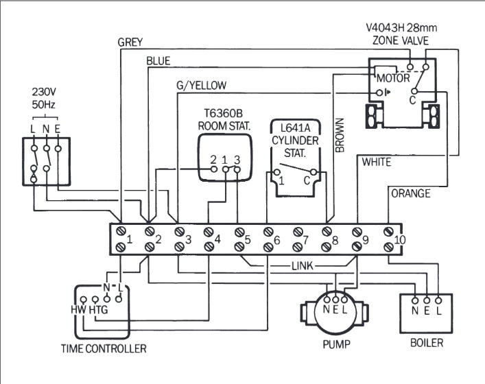

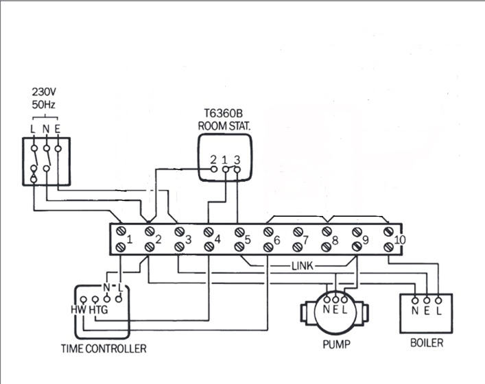

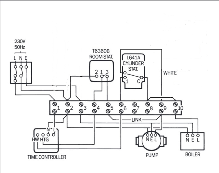

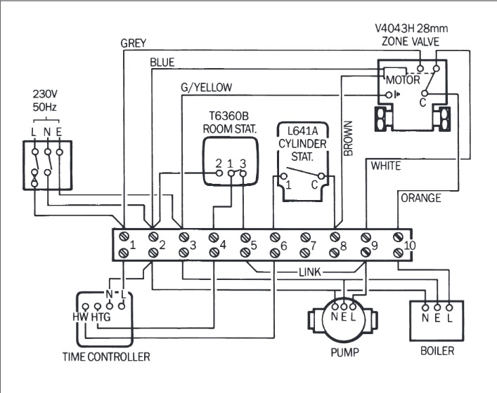

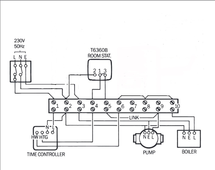

A C-plan still works this way (I think)Before the renovation work, we could switch on the heating independent of the hot water.

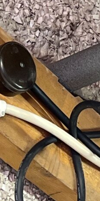

Yes, definitely. As I said though, if you trace where that black cable goes and trace it back to a wiring center or whatever you may just find the other one (if it’s not been removed)Is it possible that the plan was changed when the renovation work took place?
