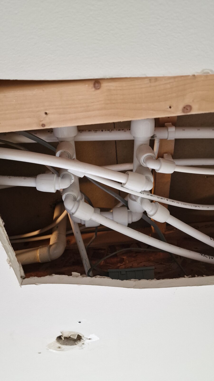

Please advise if flow & return pipe in 2 pipe heating system should be connected together, as per below sketch:
Main heating flow & return pipes are 22 mm with 3x 15 mm radiator connections on each, plus additionally the flow and return pipes are also connected together.
I will be grateful for your opinion if this is been done correctly or not.

If your diagram is anywhere near a true representation of the actual pipework the rads would never fill with water !

I very much doubt they are connected the way you think. Show us some pics of the joint / pipework
Hey @terryplumb,
Please see photo of one end. I will try to upload the other end too, but it looks almost the same (3x 15mm connection on flow and return).
Looks like a manifold .The top of it out of picture, does it have a 22mm pipe going in and one out ?

It is HEP2O manifold, with 22mm going out from the feed and connecting back to the return pipe. The same is on the other end of the feed and return pipe.
Please advice if it should be like that, or should both ends be dead-ended.

If your answer to my specific question is " yes ,there is a 22mm pipe going into and out of the manifold" , then where does each pipe go to ? One of them will connect directly to the boiler ,but where does the other one lead to ?
To be frank , your replys are not making much sense.
If the c/heating is working ok ,then I doubt you have anything to worry about.
