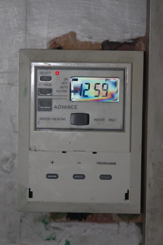

I'm hoping someone can explain some very basic information about how heating systems work in the UK. We've been here for a little while (from Australia) and are used to being more concerned about getting cool, not warm.
I know all systems work slightly differently, but I'm wondering if I can optimise our usage as first electricity bill was 200 pounds for the month (which seems a lot, but maybe that's normal? for here). In the basement we've got a Glow Worm 65-80 boiler and that's about all I know. I've attached a picture of our boiler controller.
Any advice on how to set this most efficiently? ie Should we not have it on all day, but rather set it for certain periods? If we do turn it off, then on, will there be a lag before hot water comes through? Other tips?
Any info would be great.
Thanks!
You have a gas boiler? But your electricity bill was £200 for a month? That is unusual but we don't know how big your house is.
Info about the UK:
1) Gas is about 1/3rd the price of electricity per kWh. Domestic UK gas boilers usually have an output between about 10kW and 30kW. Proper draught-proofing, insulation of lofts and cavity walls, and use of thermostats and timers cuts heat loss (hence gas usage) enormously. Leaving doors and windows open increases it. Look at your bills to see what you are paying per kWh.
2) For efficient usage, set the heating timer to come on half an hour before you get up in the morning, and go off hlf n hour before you leave the house; and to come on half an hour before you get home in the evening, and go off half an hour before you go to bed. Set your room stat for 18C - 20C. If you are used to Australian temperatures, buy some vests, jumpers and woolly socks. Be aware that women habitually say "I'm cold" every 30 minutes.

G'day, That boiler is probably 30 years old and no amount of tinkering with times on the programmer will increase efficiency much above 65%.Simple things such as loft insulation and draught proofing might help marginally.Make sure the boiler and system is serviced regularly and all rads are hot all over.

make sure your immersion heater is not switched on. Turn off the boiler and see if your water still heats up.
