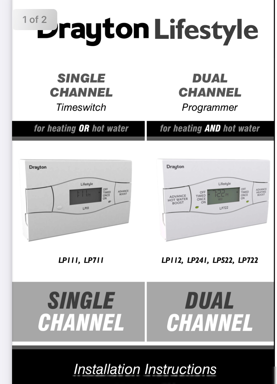

LP112 is only single channel so you cant separate switching times. If it is an S plan, then it has to be either a sticky zone valve on the DHW, or a faulty cylinder stat, (or a loose connection)
LP112 is dual channel that is what the 2 means, LP111 is the single channel
