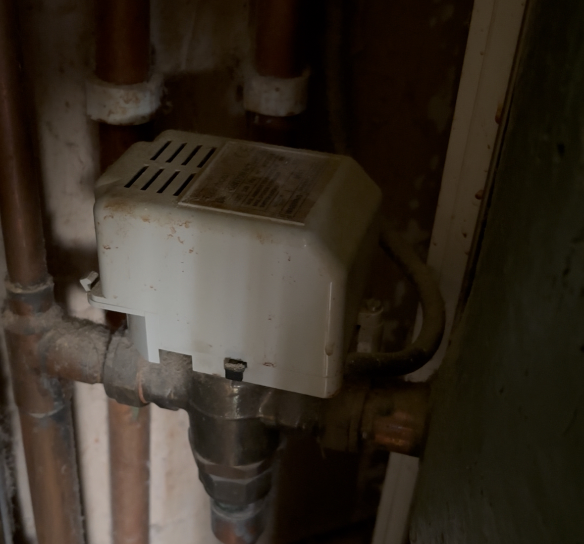

This thing in the photo started making a loud buzzing noise - is this an easy fix? …what is it?
Video in the link…

Looks like a zone valve. May just need stripping and cleaning or may have seized and need replacing.
