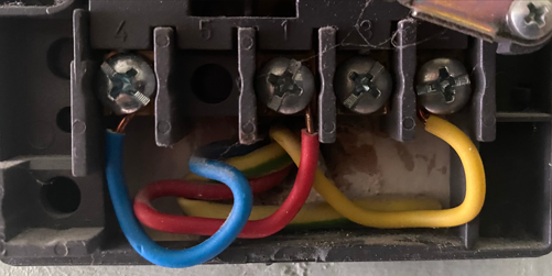

We have a Hive thermostat controller and have done for a while. I've decided it was time to remove the old thermostat from the wall in the utility. (Since we got Hive, it's always been set to max temp so always on, as such, leaving Hive to do the hard work.)
Removing the thermostat, I hooked up the live to the switch and isolated neutral. I'm guessing this was the wrong thing to do as I noticed the central heating pump was constantly running after 10 minutes, so I undid my changes and put the old thermostat back on.

Post photos of your wiring for the old room thermostat.
Here you go.
I connected red to yellow; left blue out of the equation.

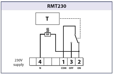

That looks like a Danfoss RMT 230, in which case the connections are as I would expect to see them.
Red L = terminal 1
Yellow SL = terminal 2
Blue N = terminal 4
Therefore, if you joined red (L) and yellow (SL) together, and isolated blue (N) that's fine.

It is yes.
OK, thanks for you help.
Good news is... I didn't break it.
Bad news is... heating doesn't work!
