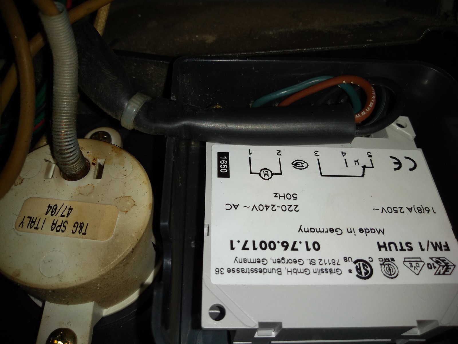

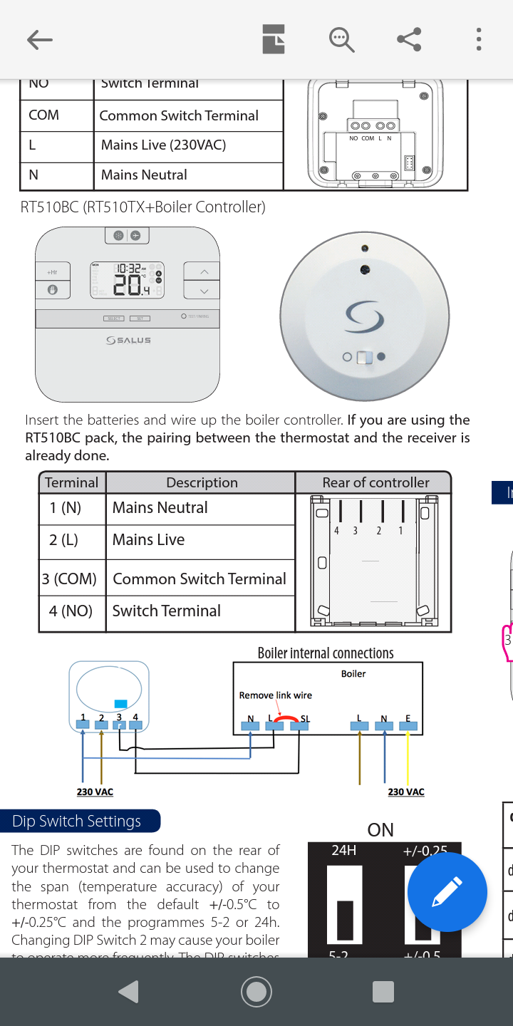

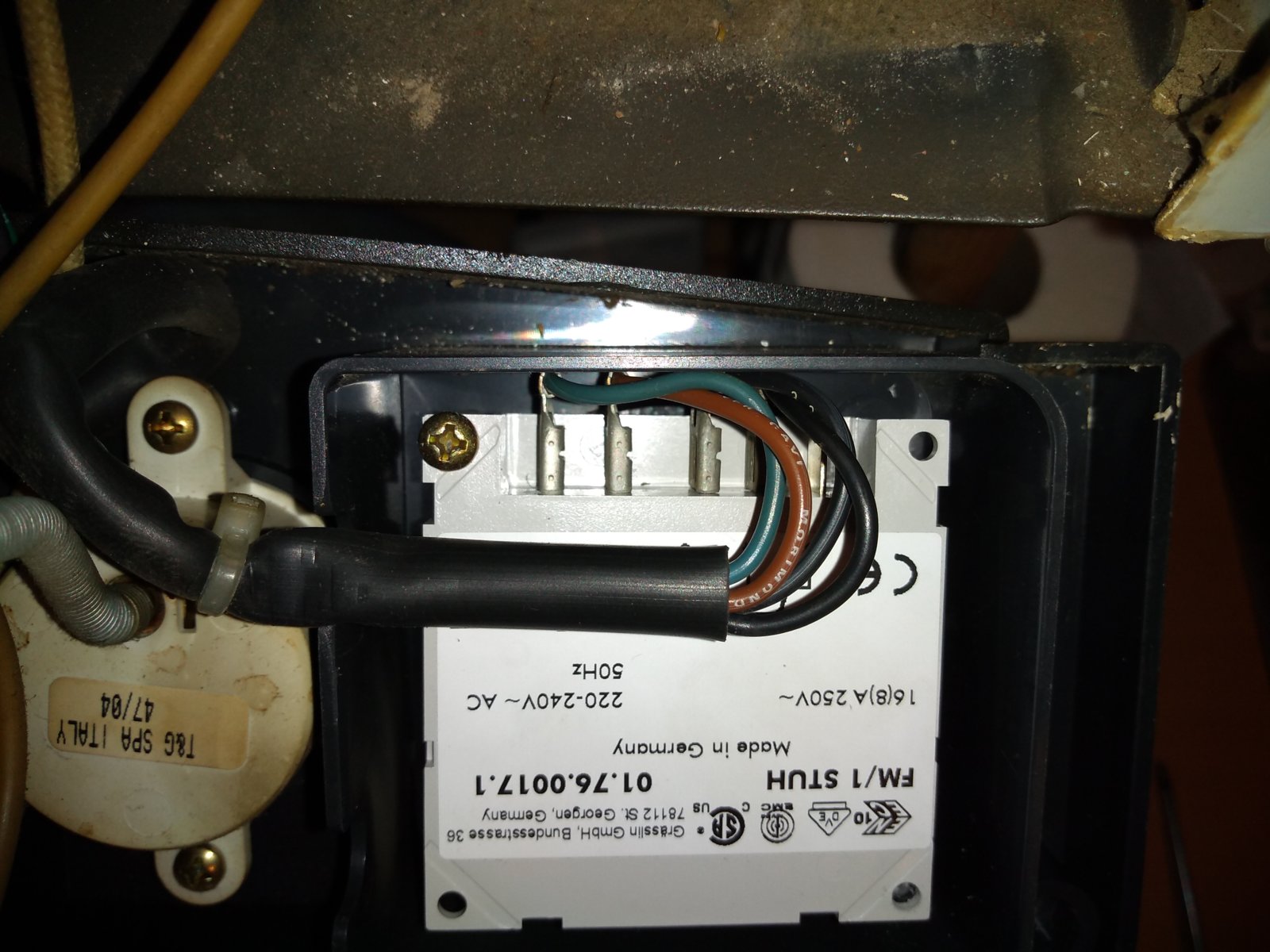

Salus Wireless Thermostat, White, would it be a straight swap for the existing timer (mechanical type where you select the on off times by pushing tiny switches)? I've had a look and it has spade type connectors at the back. I don't want to do anything too complicated!

Would the salus rt510bc thermostat be a straight swap? Just a case of swapping the spade connecters. Even though the numbers seem back to front on the salus thermostat compared to the mechanical timer I currently have?

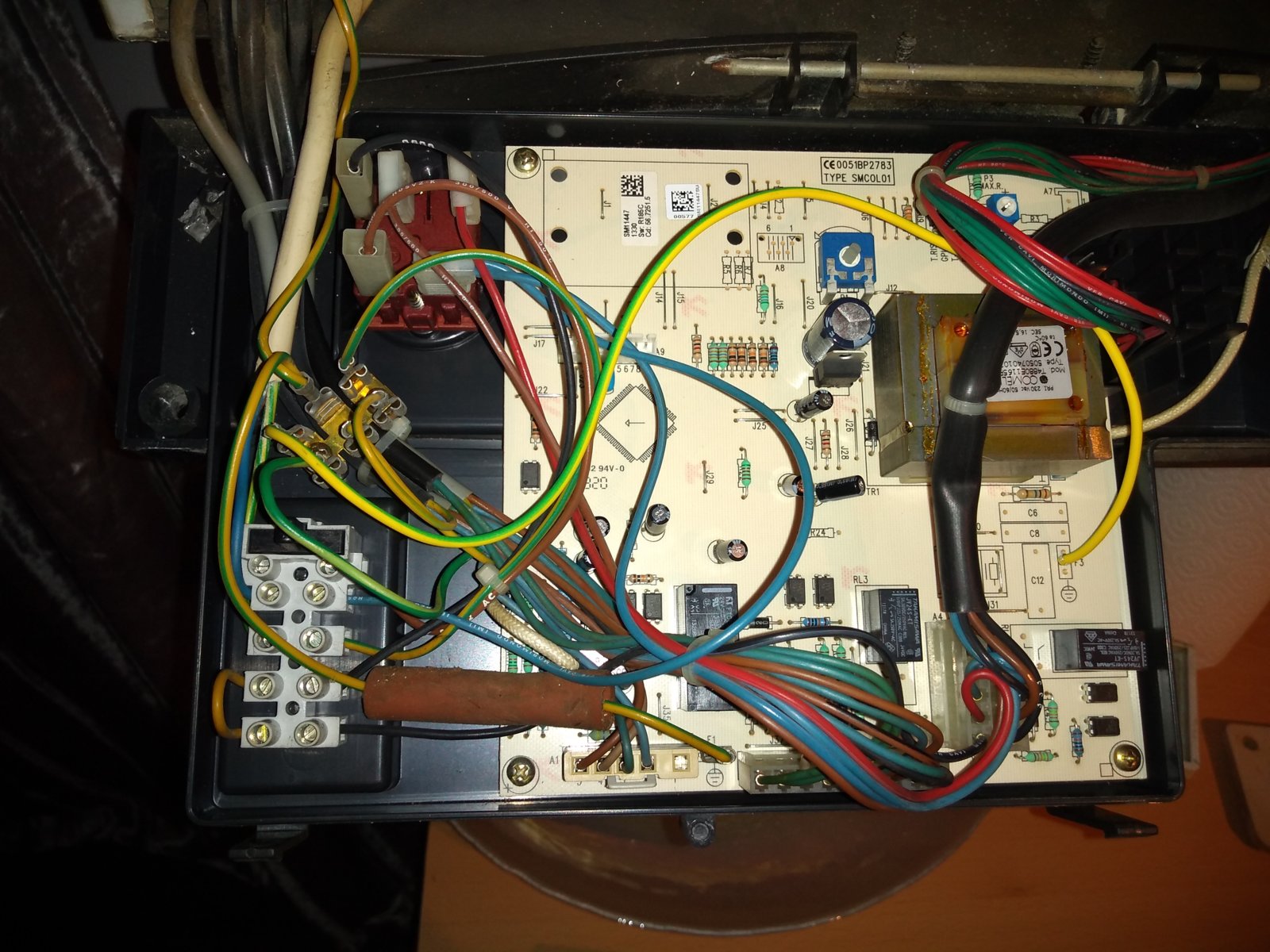

Are you thinking of removing the existing timer and putting the wireless receiver in its place? If so, that will work but the wiring is a bit tricky as the connection in the boiler is designed for a timer only. The work has to be done by a Gas Safe Registered person as you the job means working inside the boiler casing, so it is classified as 'gas work'.
Doesnt matter what room thermostat you fit, if it is just the pump that is running and the boiler is not firing you have a boiler fault
