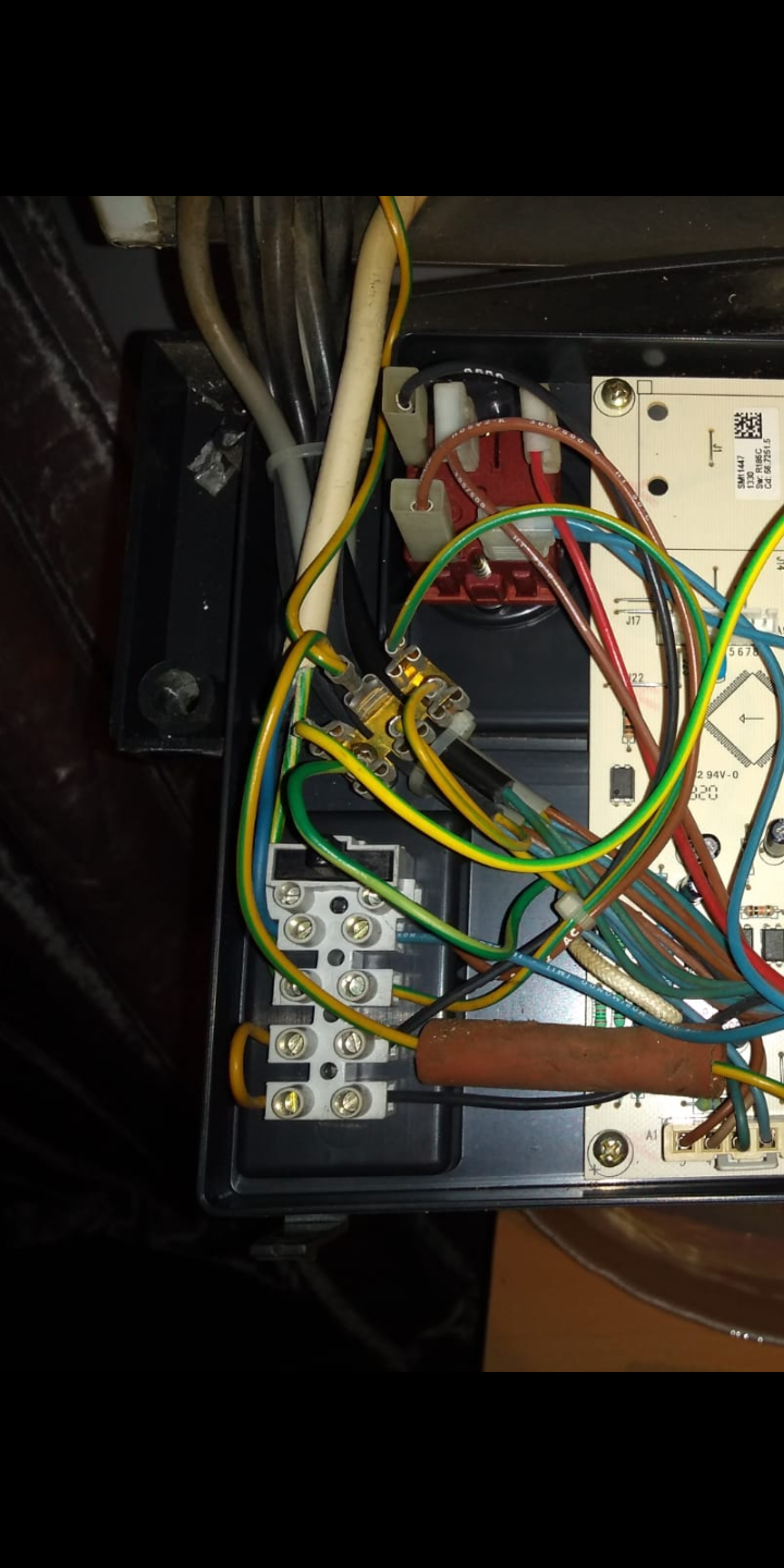

The OP has said he has no room thermostat, which is confirmed by the pic of the PCB in post #7, which shows the link still in place. So there cannot be any external control fault; the boiler is being turned on and off by its internal thermostat. So the anti-cycling process is being followed.

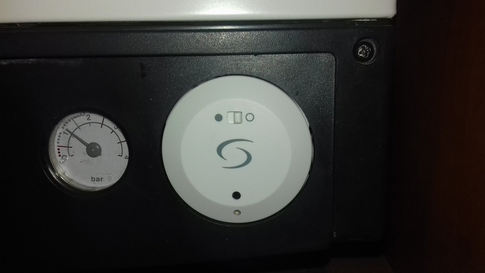

2 - no ideas on the water temperature. It's an analogue dial with no numbers on it.
The row of lights show what the temperature is - from left to right:30; 40; 50; 60; 70; 80 (Deg C)

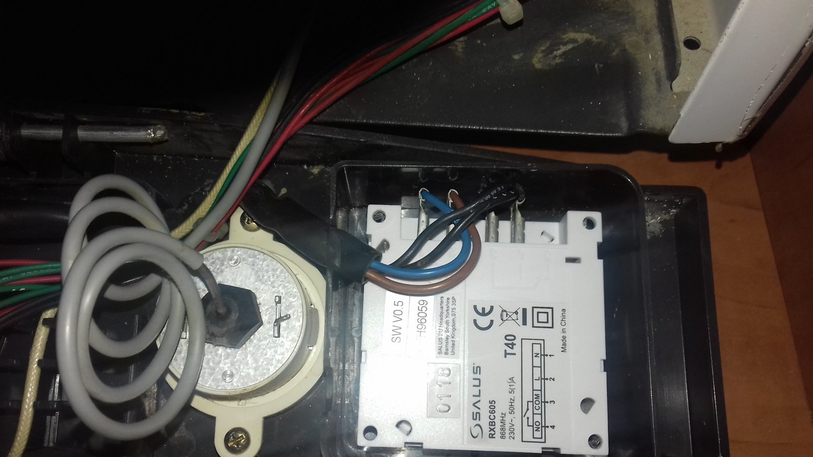

I've had a look and it has spade type connectors at the back. I don't want to do anything too complicated!
The integral mechanical timer is a straight out to the BC unit,use the existing 4 wire timer harness. Just swap the 4 spade connectors (y). That is all you need to do :!: remember the salus is a cheap programmable timer.

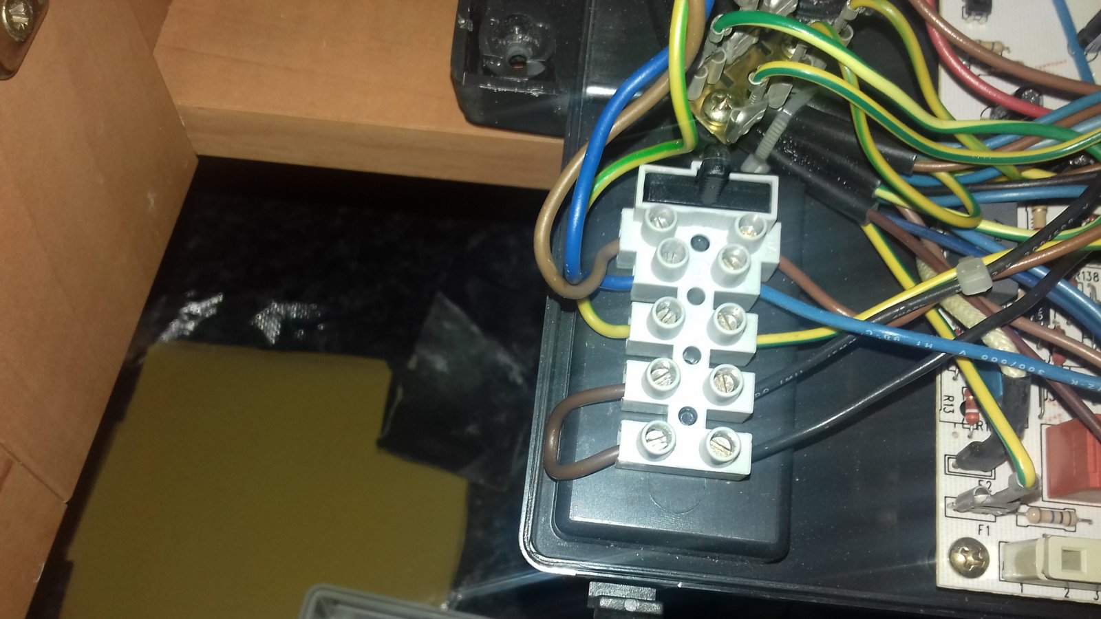

A link wire doesn't have to be removed then? (bottom left)
