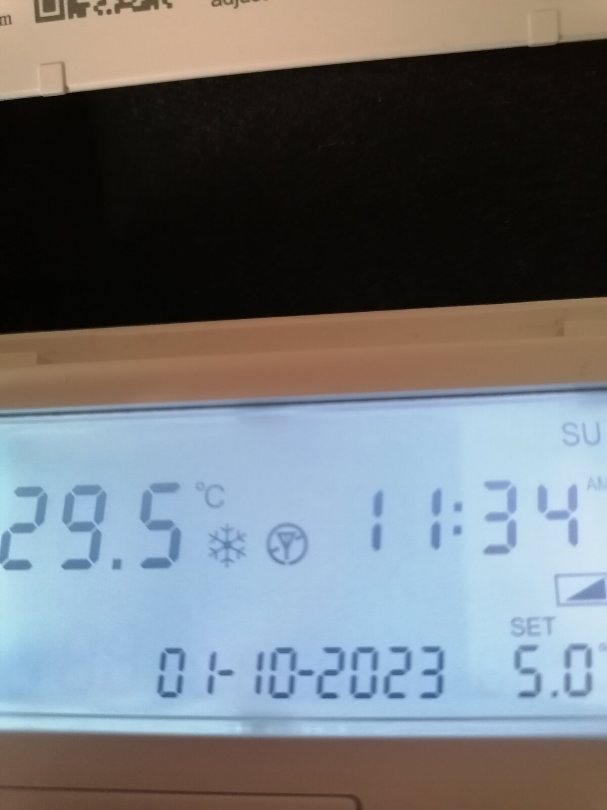

My mum's heating is on full blast even though the thermostat is set for 20 degrees.
I've turned it off for the moment and the frost override symbol has come up but I'm not sure what the symbol to the right of it means.
Can anyone advise?

The frost symbol could denote the stat is in winter setting ergo, heating and HW is on rather than summer HW only as against it's a 'frost setting' The glass with the line through it could be that it's 'not' in party mode whereby it would be always on.

To me the symbol looks like a pretend aerial, so I would guess no radio contact. Still, just a total guess.

OP, can you adjust the 29.5 degree reading
I suspect that is what is applying the demand

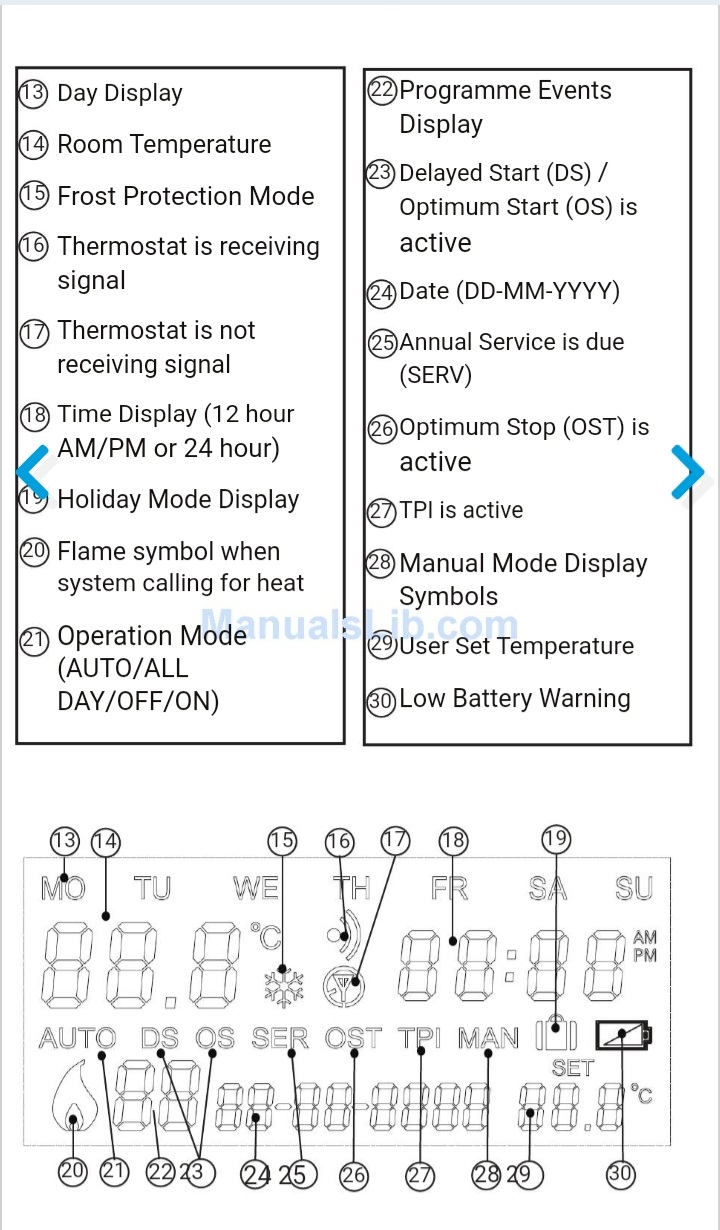

Looks like an ESI Esrtp4rf
And the symbol does show a loss of signal...
