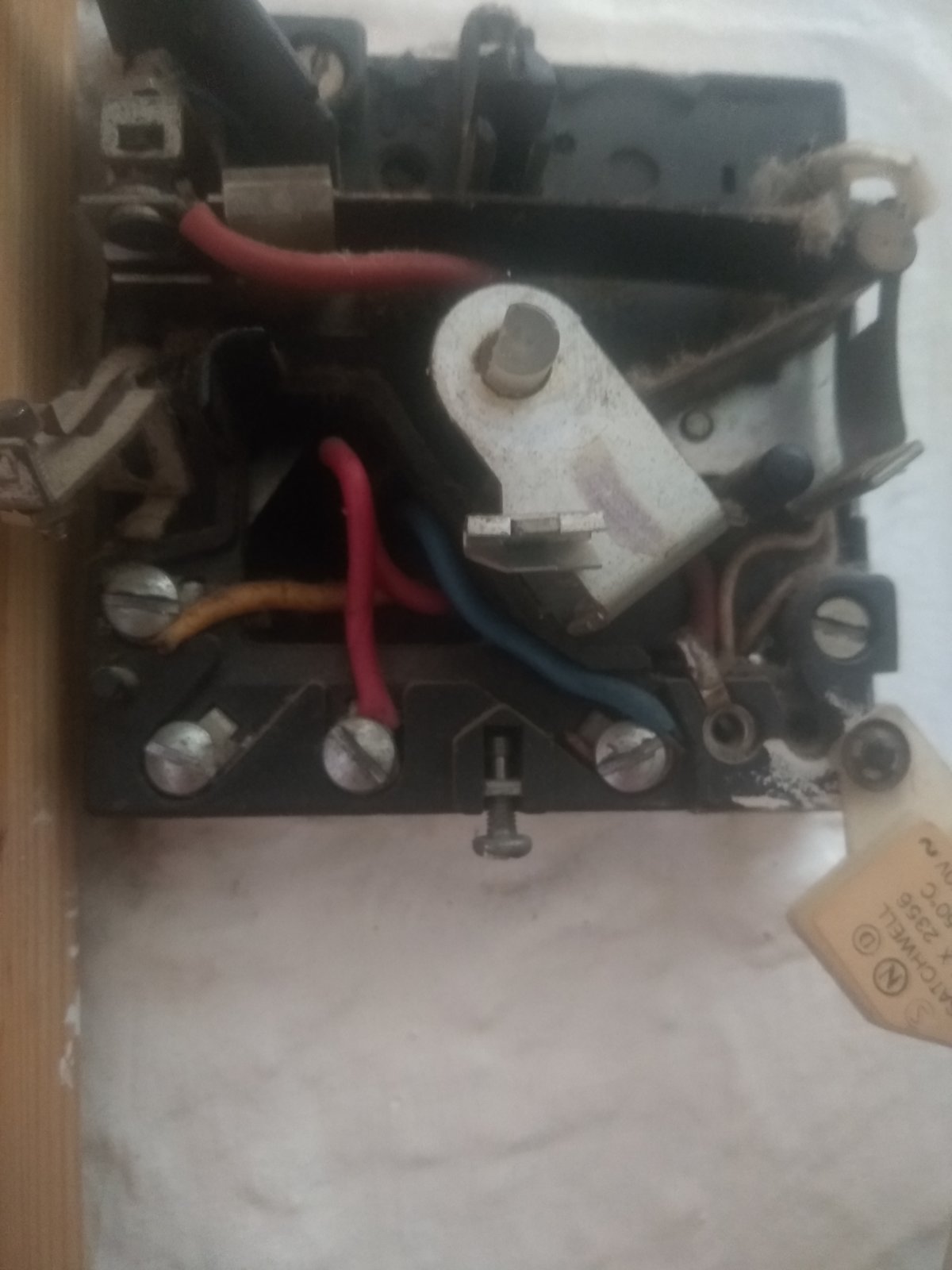

so was there a room stat already there and you have changed it for a dt90 ?
how many wires did you use and what terminals did you put wires into
Yes, it had yellow, red, blue and earth.
I have made blue and earth redundant
Red cable has gone into slot A on new thermostat
Yellow cable has gone in to slot b?

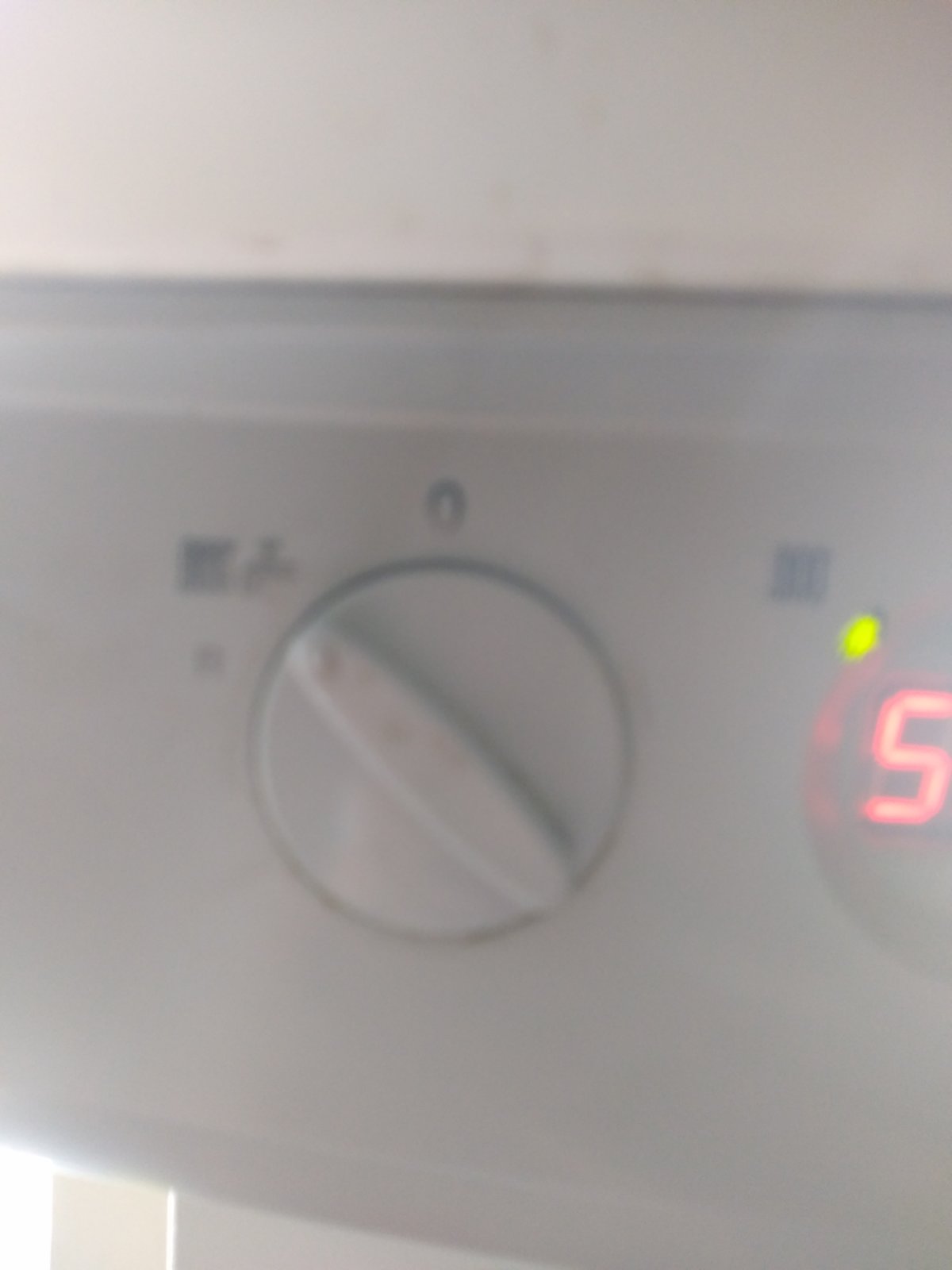

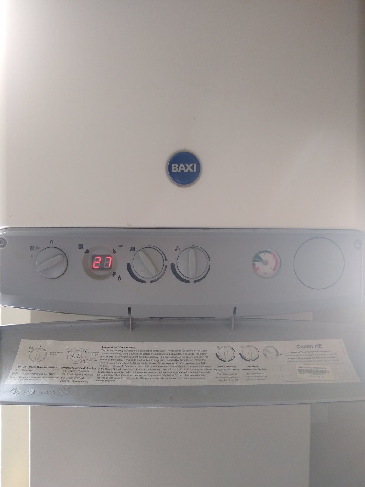

Doesn't appear to, here is a pic of th front panel
All I have elsewhere is the thermostat itself.
The wiring seems correct. You could disconnect the yellow at the thermostat and check the heating goes off. If it does it sounds like a problem with the stat.
Doogle, where did you see the wiring? I only saw the description from the OP. Are you commenting on a convention for colour coding? Could it be that the OP's wiring is not conventional?
OP, do you get the same results if you turn the new stat to a very high temperature?
