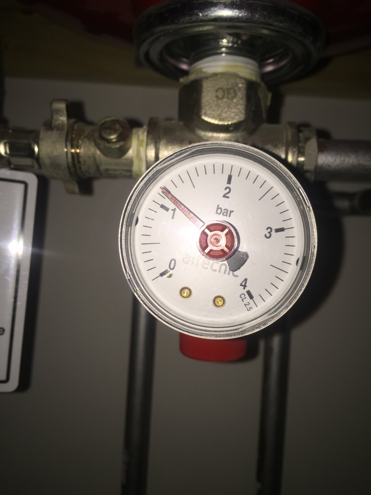

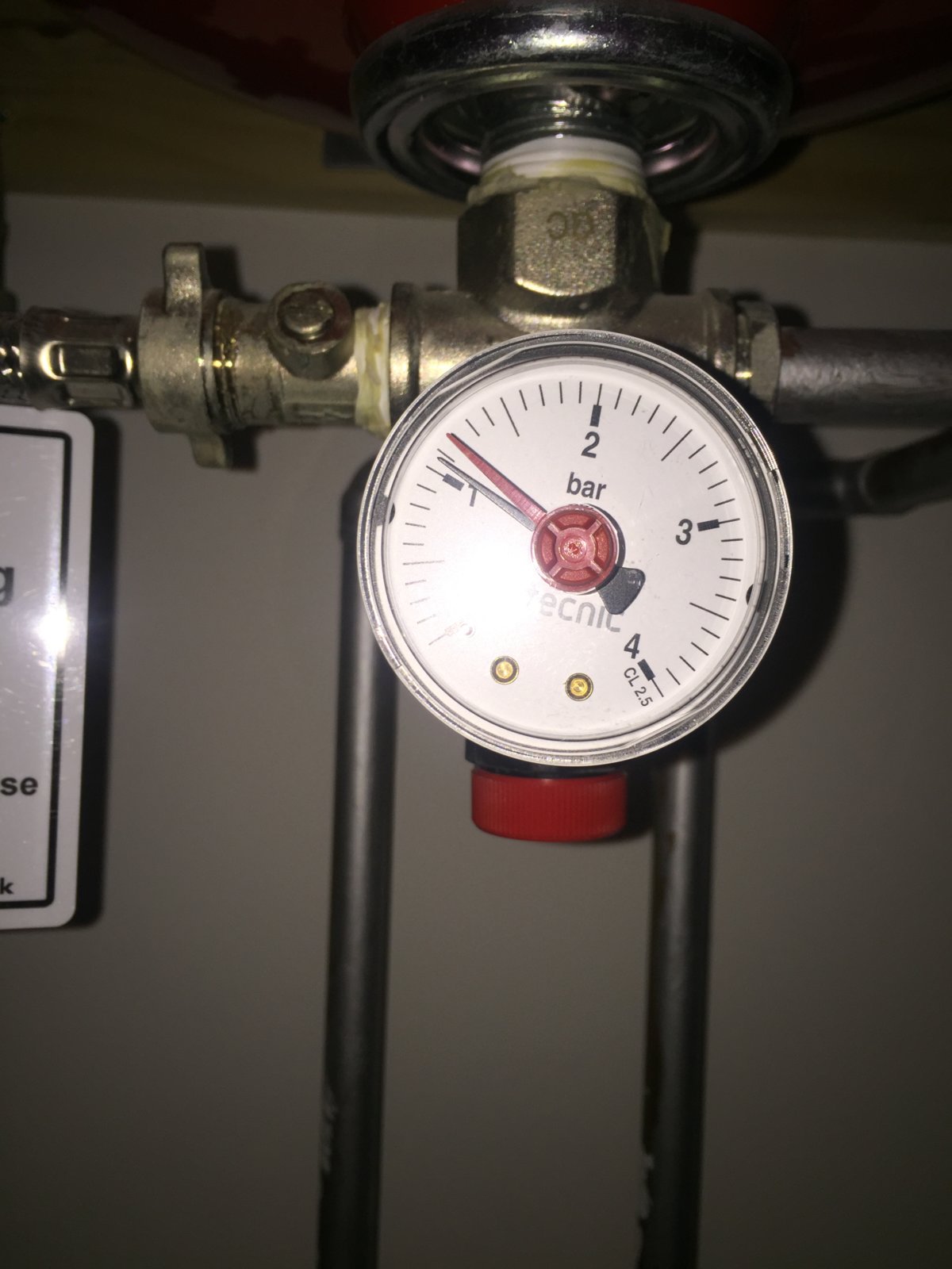

I have obviously had to top up the pressure since. The heating pressure seems to drop very slightly, but only after the hot water or CH has been on and then starts to cool down. I.e. it will sit at 1.2 bar when it is cold, goes up to 1.5 when it is running, but then goes down in very small increments to say 1.1 after having the heating on / off for a few days. I do not think it is the heating system as it does the same when i only have the hot water on too, i.e. drops ever so slightly after having it on.

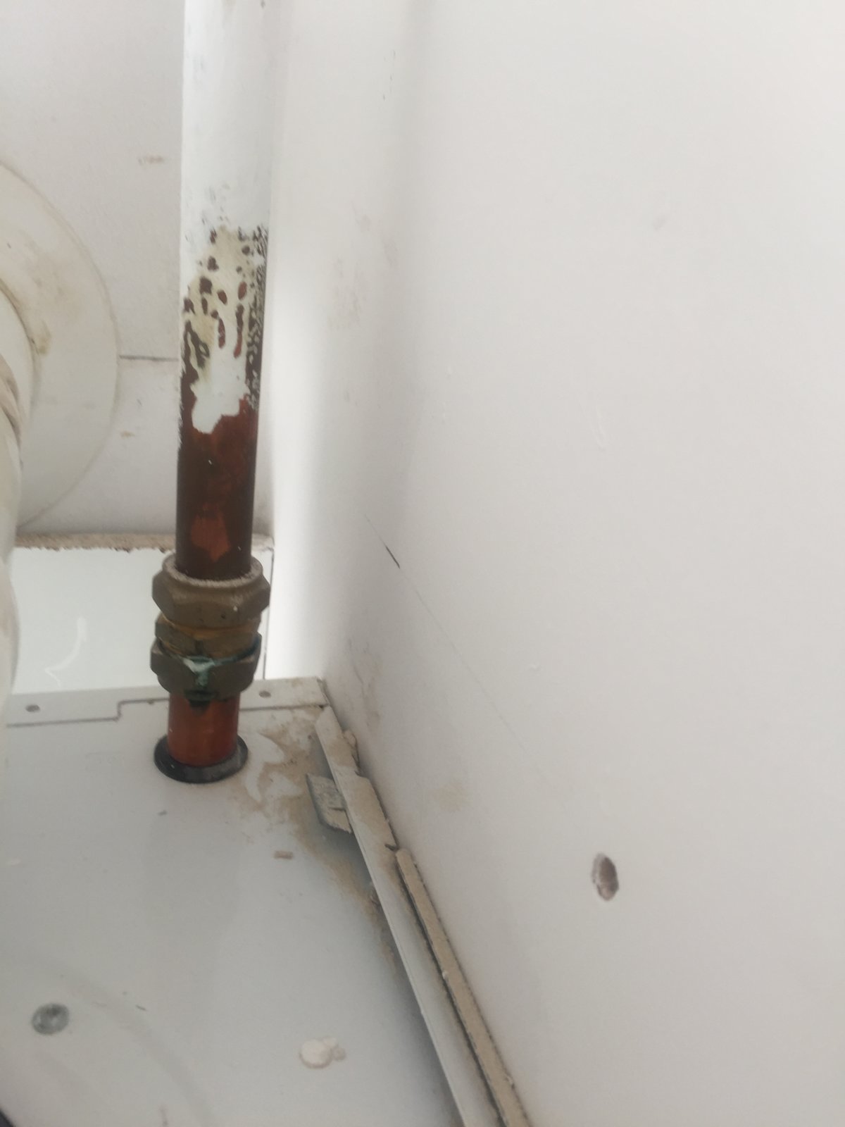

the only other evidence of a minor leak are at the boiler pipe on top of the boiler going up to the pump. Again this is dry, and even when the system is cold can't feel any moisture so not sure if this is a leak or just some old flux.
