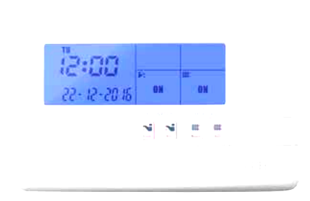

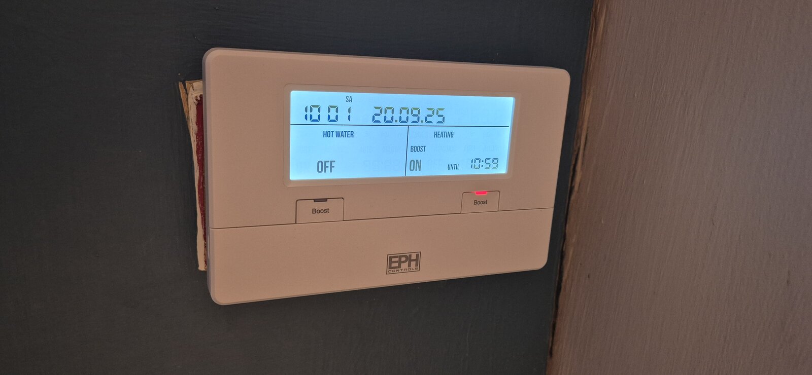

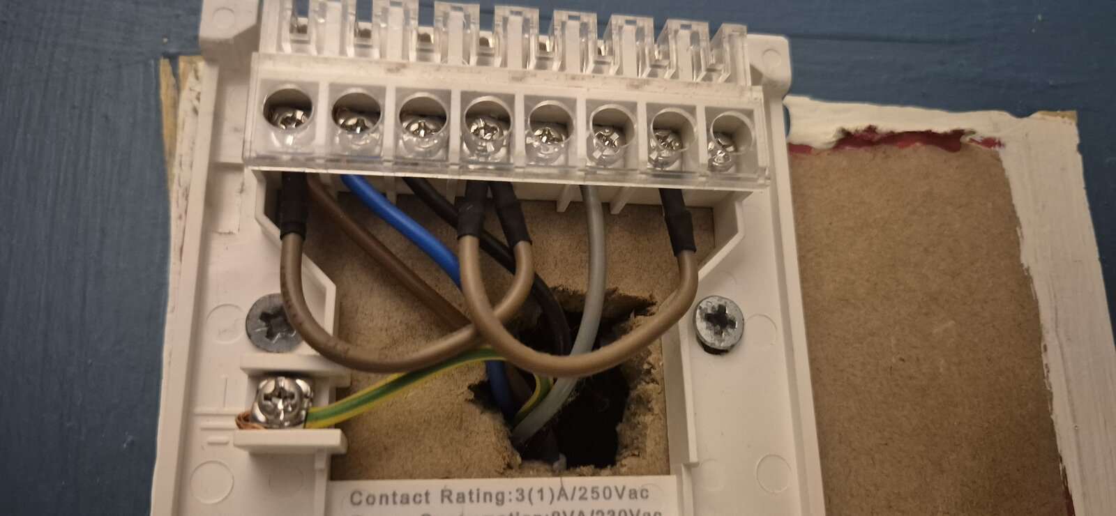

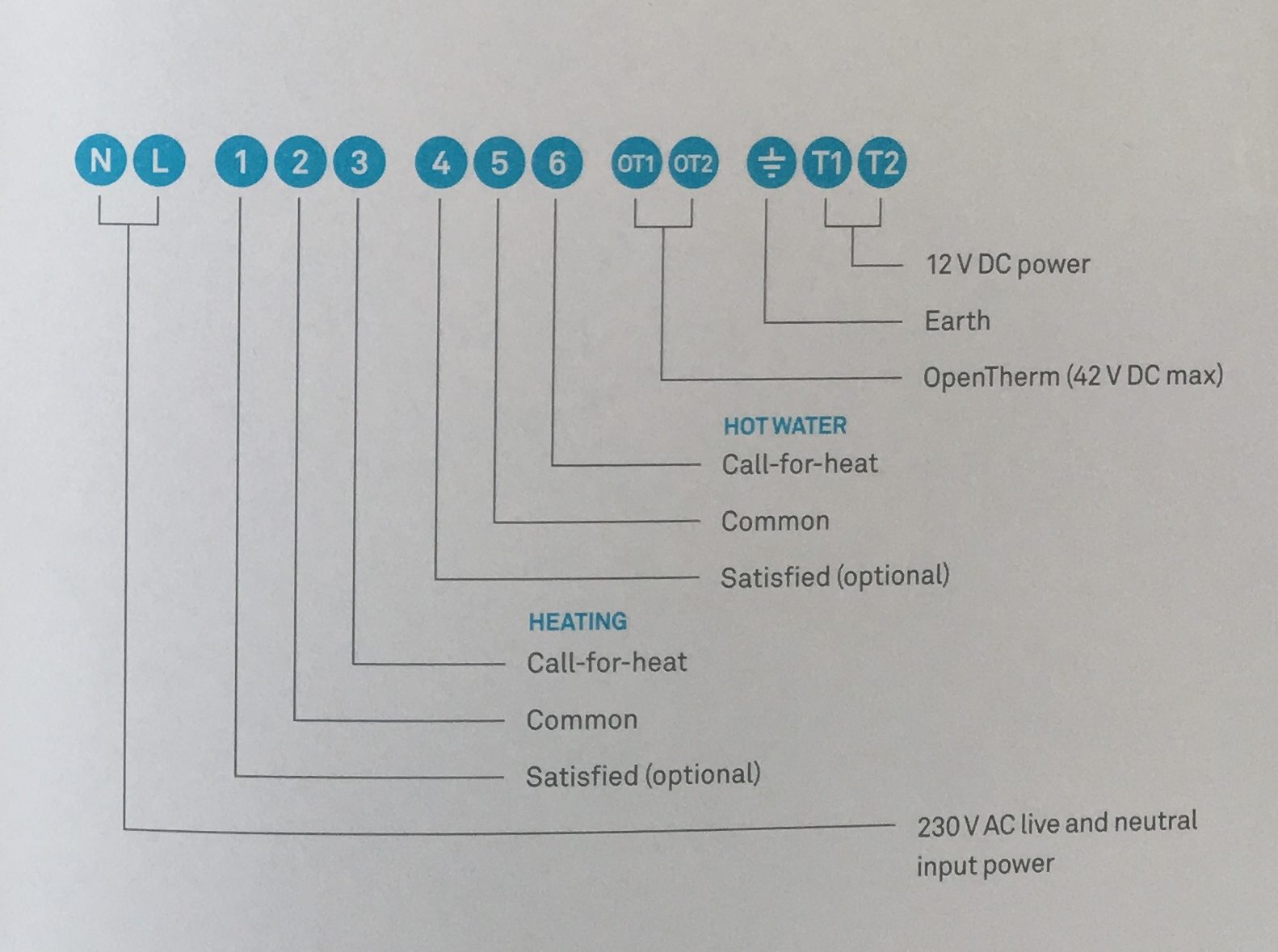

Heating Programmer Wiring

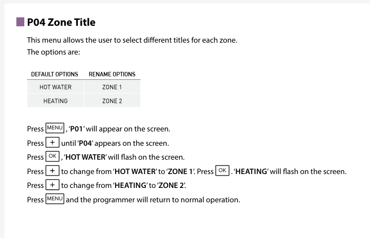

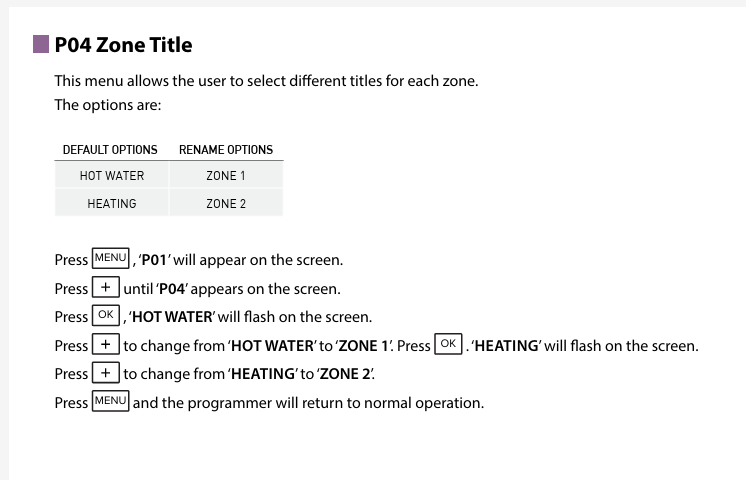

I have already told you -- You can change the labels to call them water and heating instead!. RTFM
Thanks for all your help with this. New unit installed and working as needed :)
