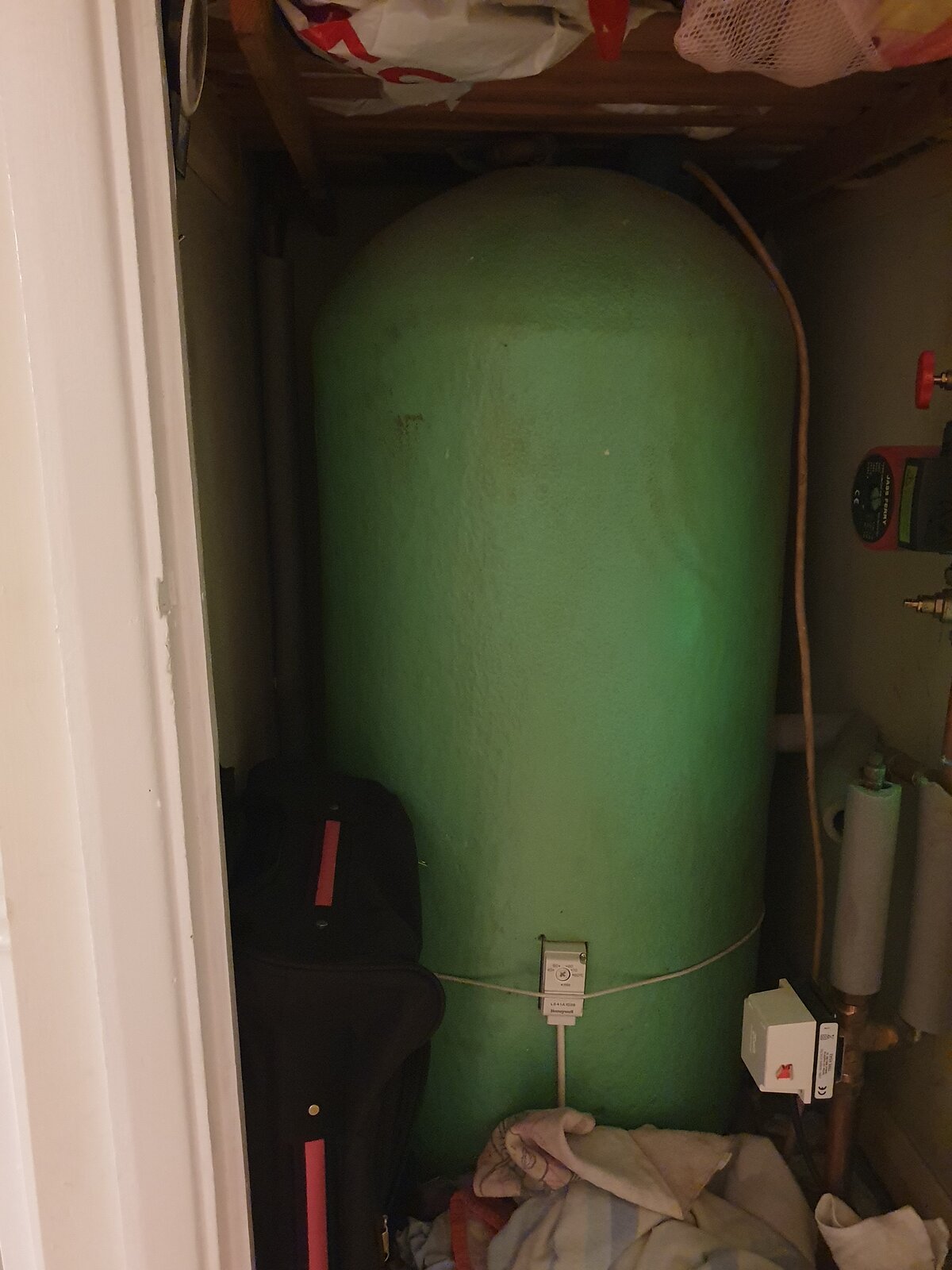

I have my heating on manual setting and hot water on schedule (at work all day so not needed all day) but the issue im facing is, the heating is working lovely and when the hot water starts on its schedule the heating seems to stop until the Hot water finishes heating.
I have an Ideal Logic heat 7 boiler (4yrs old. Serviced yearly) with a Hive thermostat, and a new central heating pump and 3 port valve (both 7 months old)
It has not really bothered me as we work around the issue. But with winter coming i would like to try getting the problem (if any?) Sorted before winter

Probably wired up as hot water priority, you need a heating guy to check and either rewire or live with it.
I think you have a hot-water cylinder. What colour and dimensions?
Subject to the above, a modern cylinder with a modern boiler usually heats from cold in about half an hour. This is easily dealt with, by setting the HW timer to come on half an hour before the heating. Or (subject to the above) if you set it to reheat during and after your usual bath/shower time, it will be hot and ready, so will not draw much heat next time.
With proper controls, once the cylinder is hot, it will stop drawing heat from the boiler so will not impact the heating. As picasso says, a modern boiler usually has enough power to heat the house and the boiler at the same time, provided it is plumbed and wired suitably.
"subject to the above" will also tell us how well-insulated the cylinder is, which tells us how long it should stay hot (might be two days or more) and the cost (might be negligible) of having hot water ready for immediate use.

@JohnD yes I have a green Hot water cylinder, its has a jacket (removed jacket to take picture) l add picture In post.
It probably does take about 30 minutes to heat like you said and then the Heating will start up again. We are at work all day so i have it set up (early morn, noon couple hours & few hours from 4pm for baths etc..) so it should not go fully cold.
As suggested I will get someone to take a look and make sure its all wired as it should be and maybe get them to suggest whats best if its already wired up correct.
Maybe the person who thought a pre insulated (green foam) cylinder needed a jacket also wired the system.

A jacket won't do any harm and will reduce heat loss still further.
I have one because I'd recently fitted it to my old cylinder when the new one went in, so I re-used it.
