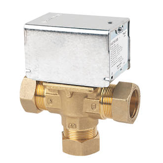

A Y-plan has a single 3-Port motorised valve, something like this:

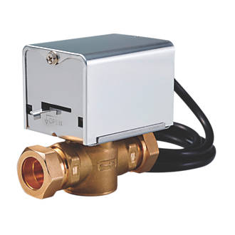

An S-Plan has two (or more) 2-Port motorised valves, something like this:
