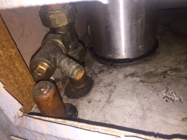

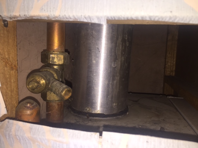

Op: some photos/description of the components you have in your airing cupboard would be the first things we need to assist you.
1 or 2 rectangular boxes sitting on pipe work with electrical leads going to them; a red or blue round metal object also with electrical lead and mounted on pipes... that really is in simple terms for you :)

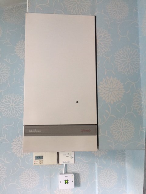

Hi guys
I have taken a few pictures of my boiler.
Hopefully I am looking in the right place!?
