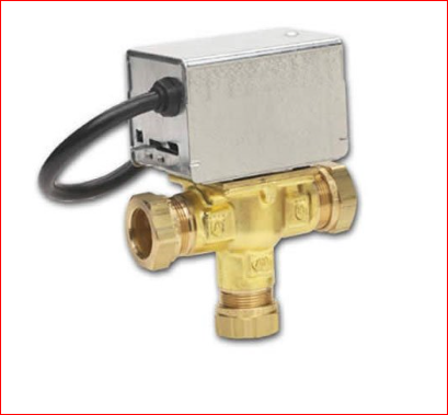

Got a three port valve or two x two port valves ? (should look something like this)
instead of your plumber turning your rad valves off why didn't he look at your diverter valve ?
