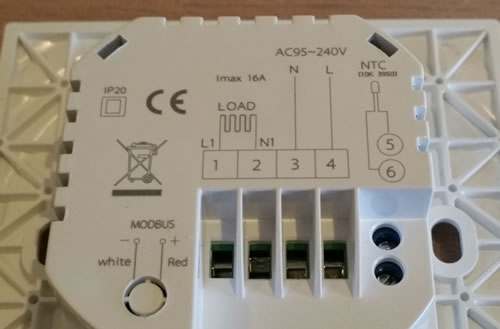

I'm getting a little stuck with what should be a pretty simple heating thermostat swap and wonder if anyone can help?
My very old thermostat had three wires attached: Earth, L (brown) and SL (blue).
We have no underfloor heating.
The thermostat I am installing is pretty simple, as displayed in the photo attached.
I tried Live to L and Blue to N, with little success.
I didn't connect the sensor cable, as it isn't needed due to there being a sensor on the front panel.
Where am I going wrong?
Bob
You've purchased an under floor heating controller. what you need is a room thermostat. (a two-wire one)
Nozzle
Thanks Nozzle, this is supposed to do both room and under floor :/
I figured the L and N on the right are for the central heating, and the Load L1 and N1 on the left are for the floor heating, which I left alone.
Correct.
Obviously.
Why did you think it would work with SL wire connected to N (Neutral)?.
Lack of a Neutral wire.
Wrong thermostat (even if it would work if you had enough wires).
That may be so, but it would need a permanent live and neutral to do so.
