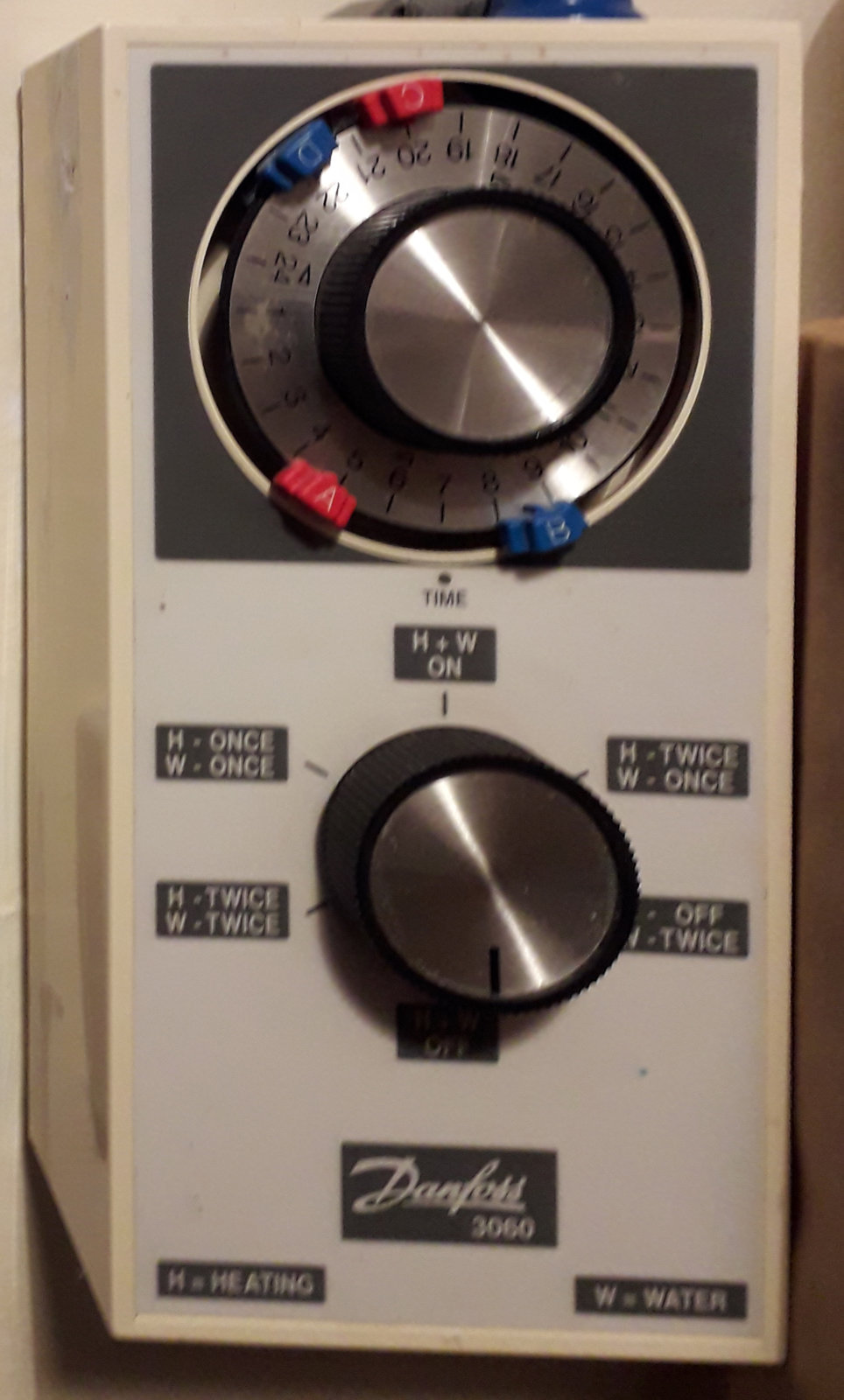

your new time switch will only control the heating if you have gravity HW it wont control the HW, what exactly are you hoping to do ?It's on a oil central heating gravity HW system
Look again at the pic of the timer and see if you can work out how I know it is not for electric
Was looking to have an easier programmer and to a have the ability to set it on for block days as in Mon to Fri - Sat to Sun different times as it now will come on same time everyday
I can only see in the photo a Sangamo 7 day time clock which is set to come on and go off early morning, then the same again in the evening. There could be absolutely anything attached to it, including electric heaters.
Nope no ideas, only clue I have is the x2 cables underneath.
What about your hot water, how is that currently controlled?
And the prize goes to @The Novice , the visible cables are not big enough to switch storage heaters

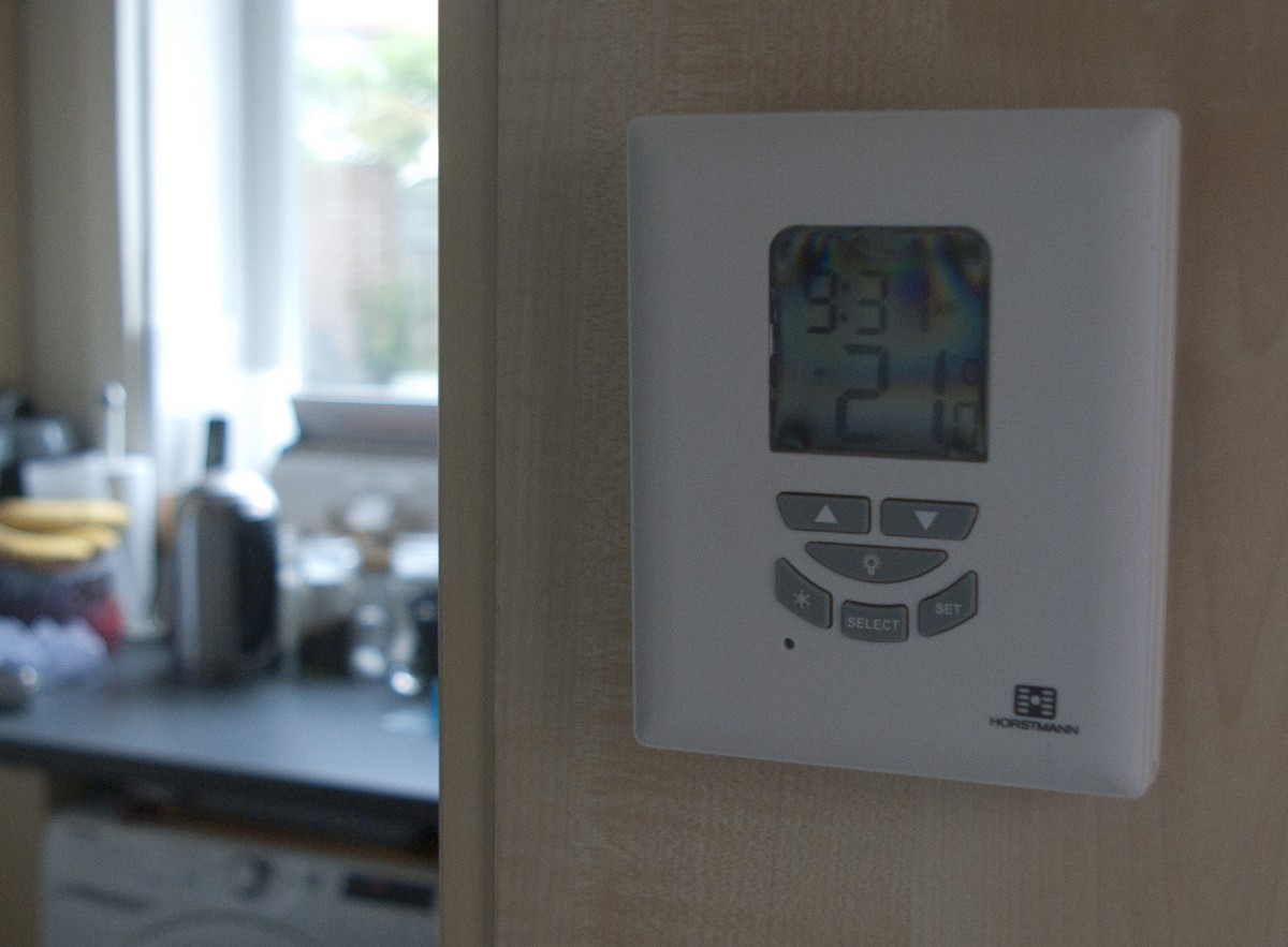

this was the first house, worked well, hard wired,
second house a failure, it lost its RF link after around 6 months of use, and caused the heating to remain on, it did have option of either 5 + 2 or 7 independent days, and last one
easier to list what Nest gen 3 will not do, rather than what it will do.
but all were better than the original time clock. So what do you want it to do? The advantage with Nest was you have two change over contacts one for domestic hot water and one for central heating and it can be wired how you want it, be it extra low voltage, or low voltage, and you can use with thermo syphon DHW without any tank thermostat or motorised valve, nothing is pre-wired, you can do what you want.You crack me upI noticed those cables, but there was no certainty that they had anything all to do with the time clock.. The cables exiting the time clock, go through the rear.
You crack me up
well who was correct ?You make assumptions..
