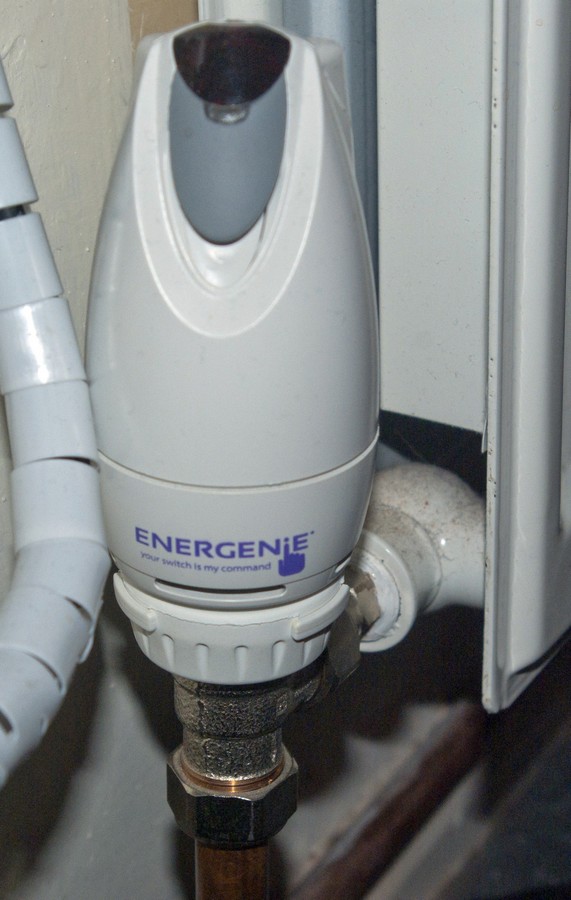

Having had a wireless thermostat fail, seemed better not to rely on them, so I bought a pair of Energenie MiHome electronic heads, IMGP8035.jpg hind sight not the best make, but two things, one the computer display TRV_report.jpg showed both target and current, so if current exceeds target close the lock shield a tad, and they worked well so got a second pair, and the other thing was, from my house I could see what temperature her rooms were.

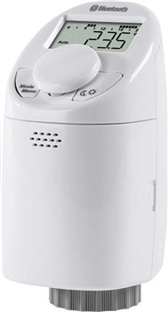

When she died the new owners did not want the electronic TRV heads, so swapped back, now the lock shields set, I found the mechanical TRV heads worked very well. Wanted better control in this house and Energenie seemed expensive so used cheaper EQ-3 Bluetooth Smart Radiator Thermostat.jpg eQ-3 bluetooth versions before brexit were £15 each. They only show target, so not as easy to set lock shield valves.
