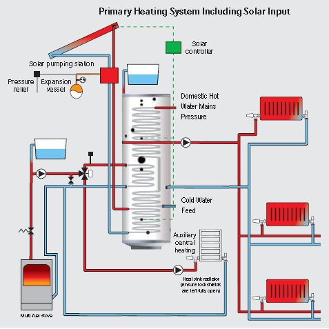

However we don't want heat at a set rate, so we need to store the heat. So we in the main use water. This Torrent pipe example.PNG is the basic idea, solar panels, wood burners, electric, oil, gas can all heat a tank of water, and the home then can use multi heat sources for the central heating and not limited to one fuel.
My brother-in-law had it with his last house, water solar panels are useless, so he had electric solar panels and the power from them ran immersion heaters to heat the water, this was enough so while house empty if could maintain the temperature at around 10°C so nothing in the house would freeze, and as the geofencing detected he was approaching home, it would increase the temperature so nice and warm when he arrived.
While at home a fire in the evening was on most days enough to warm whole house and heat the two large water tanks on his reinforced floor to take the weight and be above the fire so thermo syphon would ensure fire did not over heat even in a power cut, and should the solar and solid fuel not be enough he could use the LPG boiler, however that was rare.
It was installed when the house was built, and seemed an ideal system. However when he moved, he looked at installing in his new house, but looking at silly money to install, so he now uses oil like everyone else.

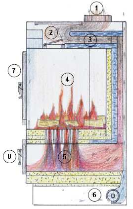

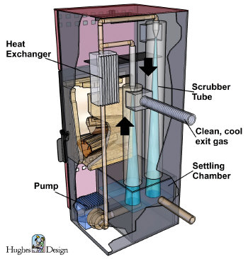

People with wood burners tend to burn what ever they can find, and some wood is not really good to burn, laburnum for example, plus lead paint etc. Instead of reusing pallets they are burnt. And finding a fire where the combustion air is taken from outside is rare, they are expensive. I looked at this Hughes Condensing Stove 2 small.jpg it seemed a really good unit, also this wallnoefer.PNG but both have one thing in common, they need electric to work, so I wrote to the manufacturers asking what happens in a power cut, I got no reply.

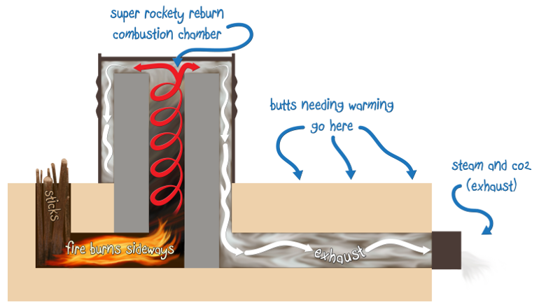

So this rocket-mass-heater-diagram.png the rocket mass heater, seems the best option, it does not need electric, and it gains the latent heat from flue gases, normally it has rocks which heat up when it is running which can keep the log cabin warm for a week it seems. However not sure if you could insure your house with a home made wood burner?
