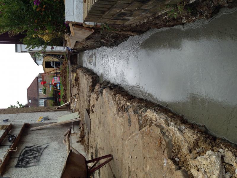

Height from top of foundation to existing dpc
Oops, sorry I read 690mm instead of 650. :oops: :roll:
So you need to tighten up 25mm, but still possible. Or its blocks laid flat for the first course.
Trying to cut 25mm of a concrete block is a bit of a chore. It's always best to try and adjust the height with thicker or thinner joints, or with a block flat or a tile to make up any difference.
If you are using a brickie, then he'll sort it. It's not a drama.
