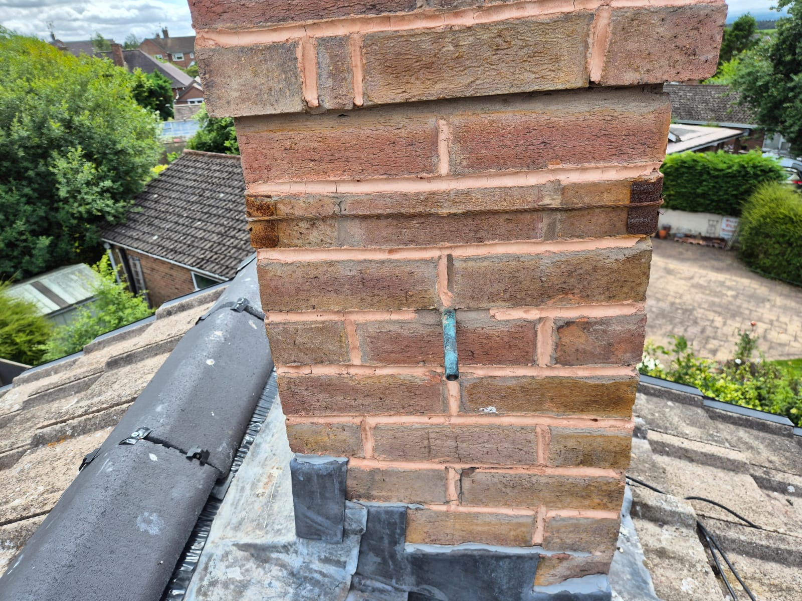

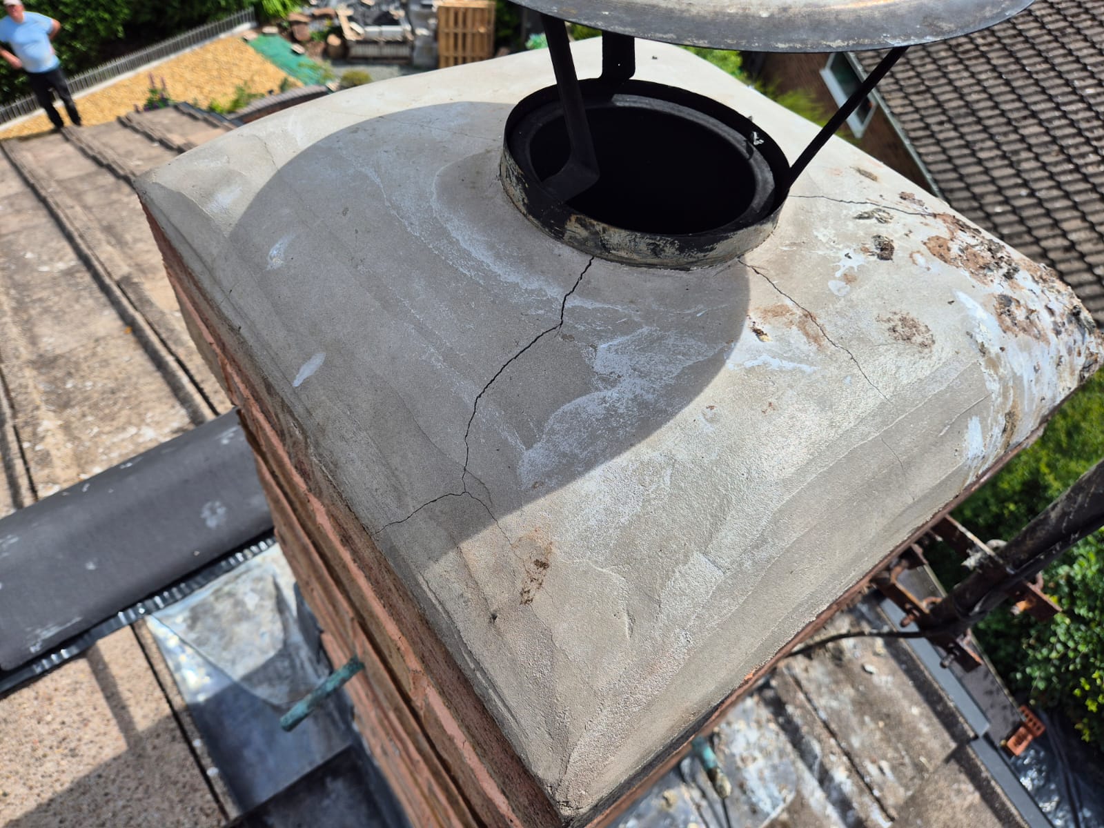

Chimney has been pointed with lime, no cement. Now cracked and coming away. Roofer was adamant due to age of property it needed lime. Is this right?

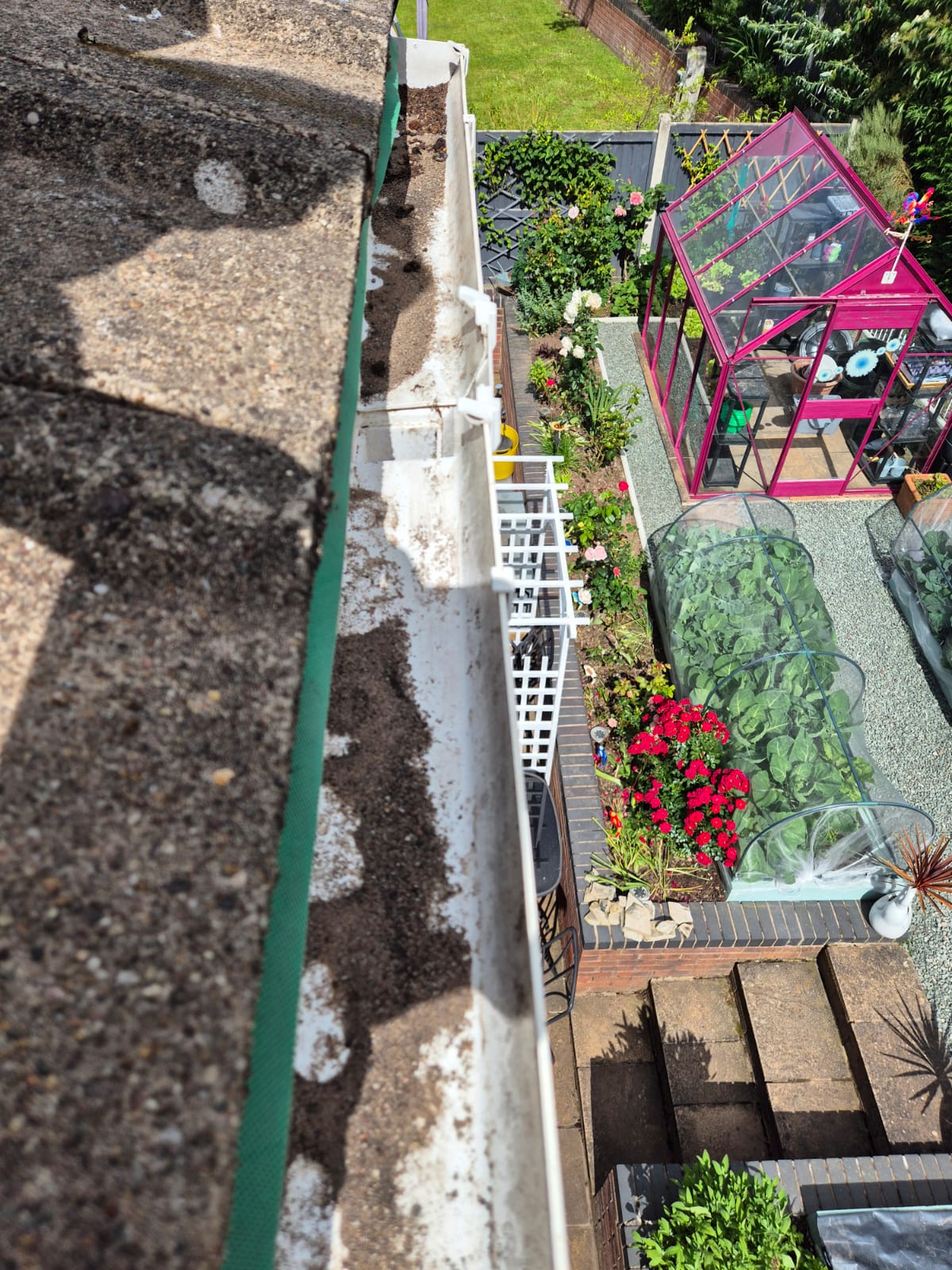

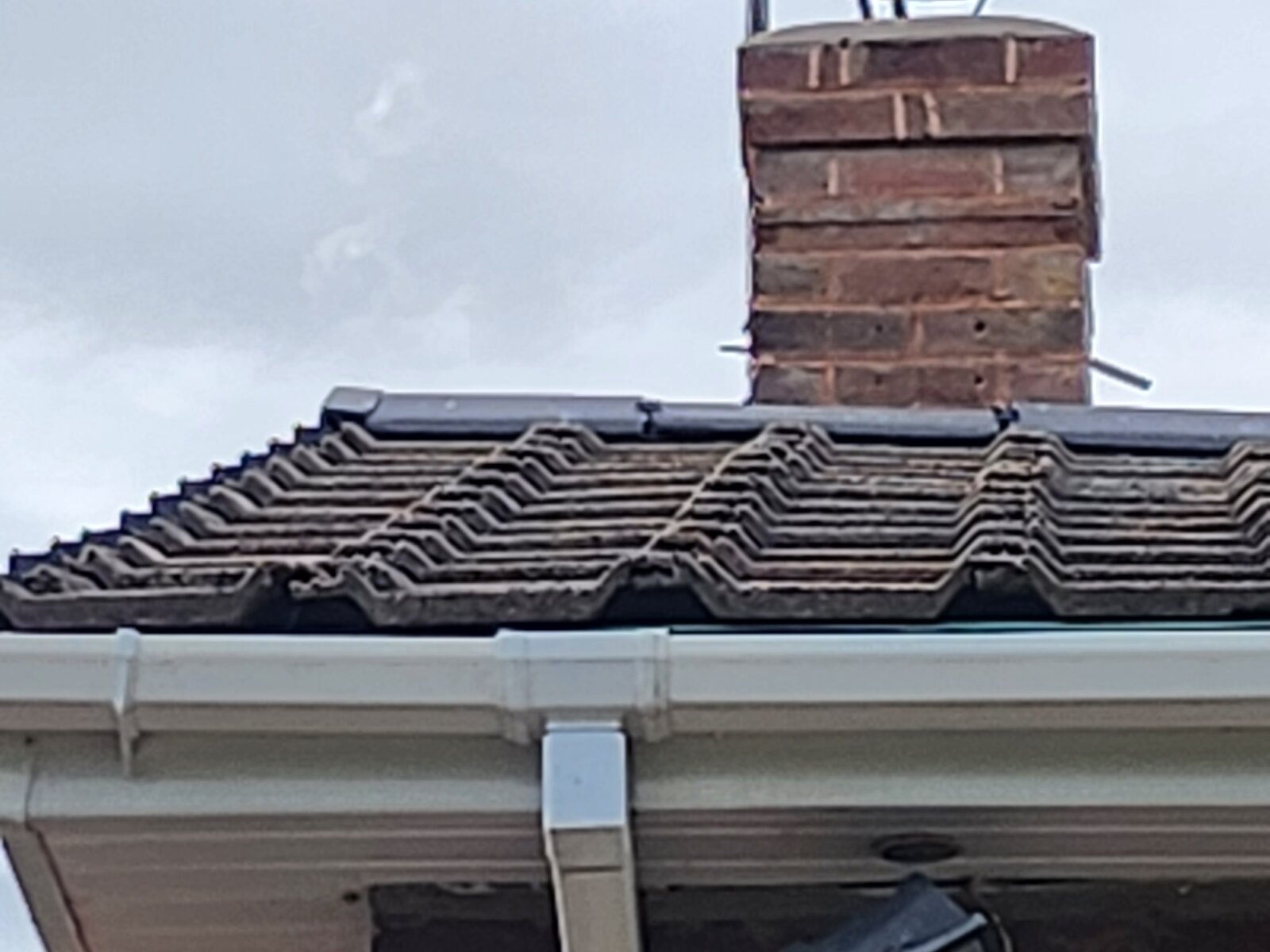

Dry ridge system is a cheap European Plastics universal kit, after he said he uses only quality products. Tiles are loose, misaligned and clips are coming out. Been in loft and battens are crooked, split and can find any braces/brackets on the battens.
Felt is hanging over the end of the eaves tiles even though we've had EPS fitted. He said it's the tiles that are too short.
Dry verge caps are crooked and loose and he said the roof extends too far as he can't get them straight.

These issues have only been noted when my gutters were cleaned last week.
