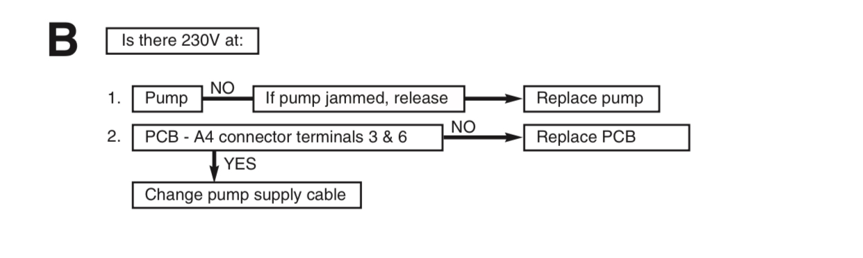

The manual troubleshooting takes me to section B which points to Pump or PCB.
Would I be correct to think that it can’t be pump just by the fact that I’m not seeing any of the diagnostics lights come up ?
Boiler seems dead other than the power LED being green.

Have you checked for 230 Volts at the PCB terminals quoted in the trouble shooting guide ??

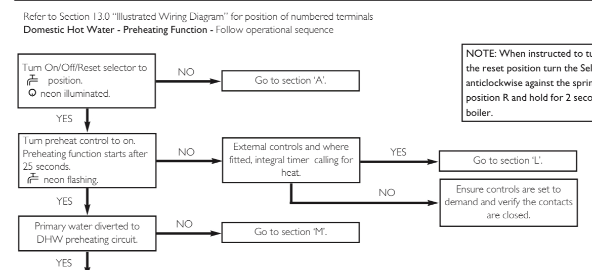

Maybe I'm looking at the wrong manual troubleshooter but the one I'm looking at for the 105E only goes up to 'K'??.
Unless OP is wrong, it’s an instant? So I looked in the manual I have for that, which goes up to M, oddly, the issue could be M as well, but mentioned no output from boiler other than led for power on (n)
