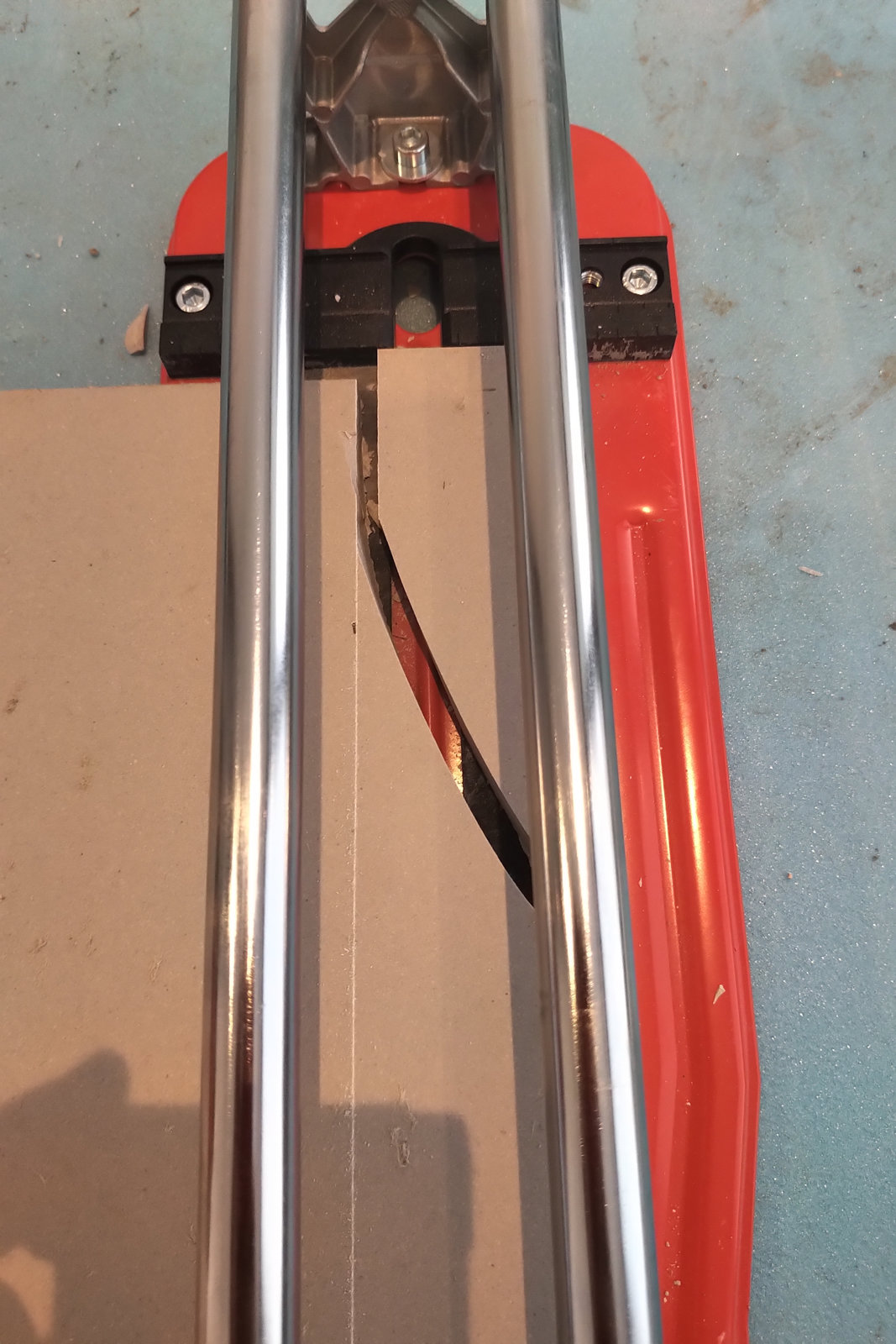

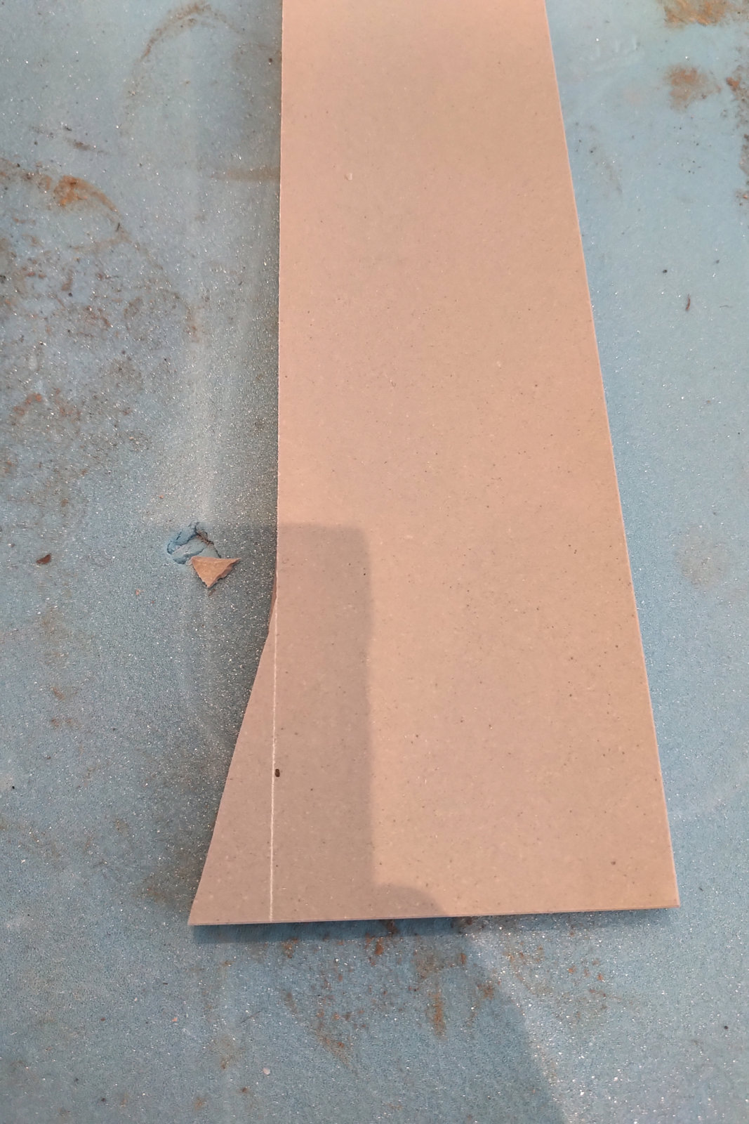

    Hi Guys,
    I'm tiling my floor, DIY job, around 45sqm to do.
    I've laid all the full tiles so now onto cuts around the edges.
    But I cannot get a good cut on the tiles, they either do a 90% great cut with bad ends, or the whole thing just goes wobbly, see attached pics. I have had a few good cuts but more bad than good, and I can't really afford to keep getting it wrong, they're not cheap tiles.
    I'm using a Rubi Pratic 60 tile cutter, I'm sure this is far from the best cutter, but having got some good cuts, I feel my issue must be more about technique rather than tools?
    I'm starting the cut by pulling the cutter back towards me for the first 30mm or so, then pushing it forward for the rest of the tile, with a reasonable amount of downward pressure in both directions, breaker then down on the top end (furthest away) and a sharp push down to break the tile.
    Any ideas?
    IMG_20191227_1247081.jpg IMG_20191227_1246580.jpg IMG_20191227_1246324.jpg IMG_20191227_1246120.jpg

    Your tile cutter is probably not up to the job. Method wise ,you should start close to you and push down,and forward ( I.e away from you ). Do you know what grade porcelain the tiles are? Is the scoring wheel new / in good condition ?
    The results shown in your pics are what I would expect if the scoring isn't deep enough ,coupled with flexing of the tile cutter ,due to its design construction not being robust enough.
    You would probably be better off with a wet cutter / diamond wheel. You can hire one for a day relatively cheaply.

    I bought the same tile cutter and have had similar problems with 9/10mm porcelain tiles. A lot of the time it has cut ok, but I also got the last inch broken off or only part breaks. I think the problem is as mentioned already, these cutters are pretty much maxed out trying to cut porcelains of this thickness. The base is too flexible and only has one strengthened point underneath where the breaker can press.
    The tiles that have the last inch broken off are waste unless they are to be further trimmed or can be used at a later point when the broken bit can be cut off and the rest reused. The ones that did not snap fully I finished off on a wet cutter, but I had to buy a proper porcelain blade for that to make sure the cuts were clean.
