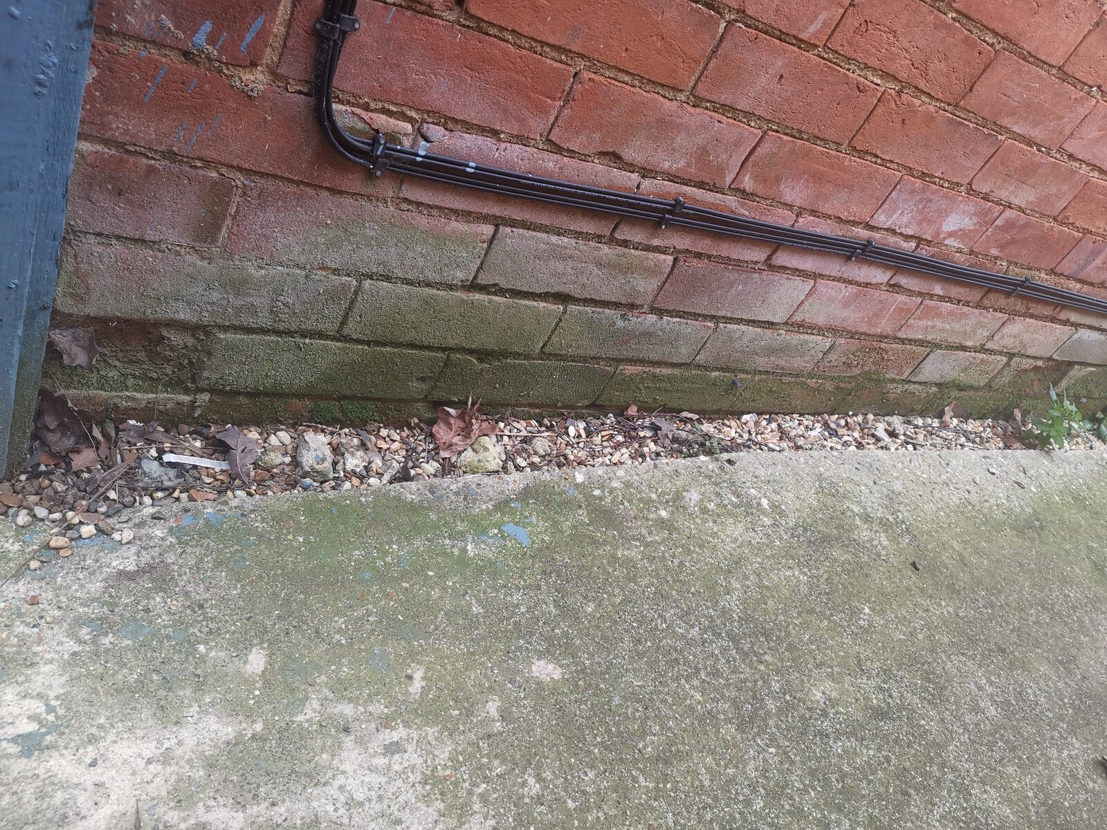

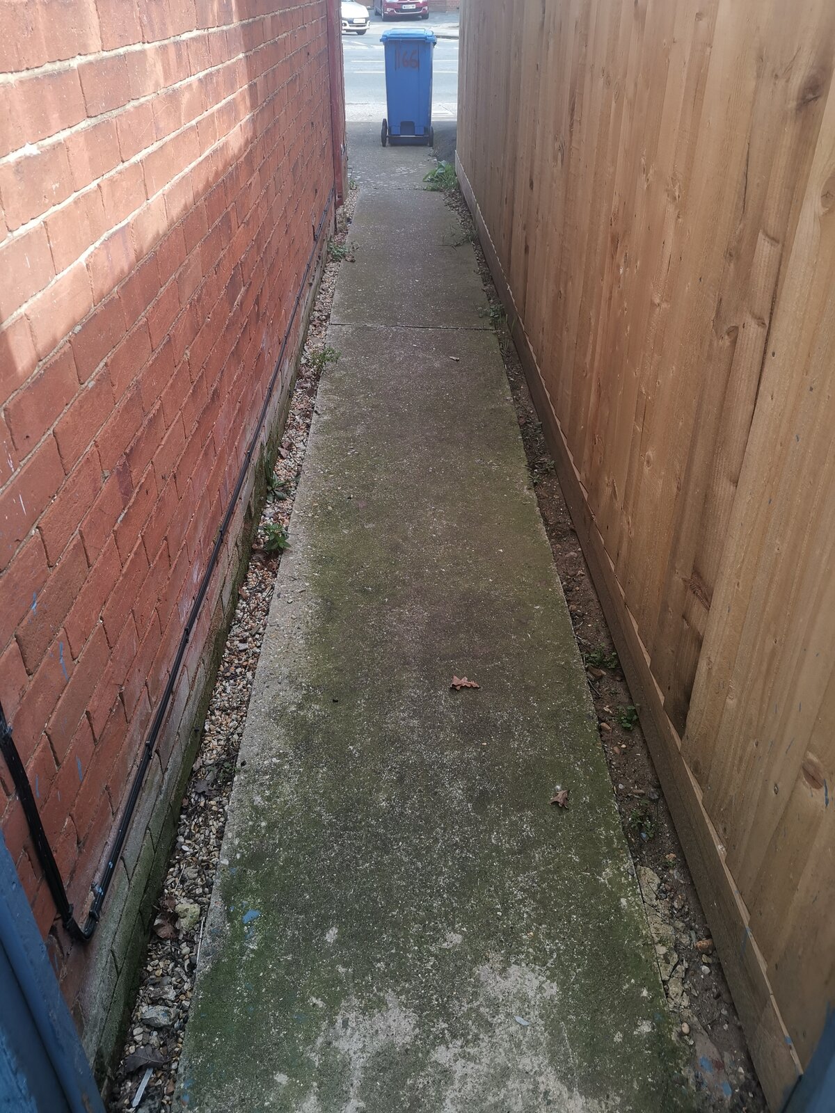

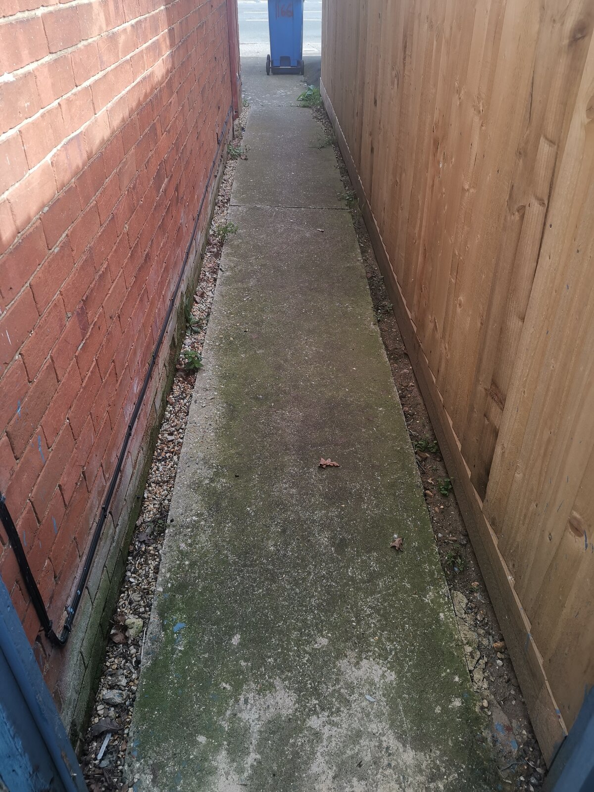

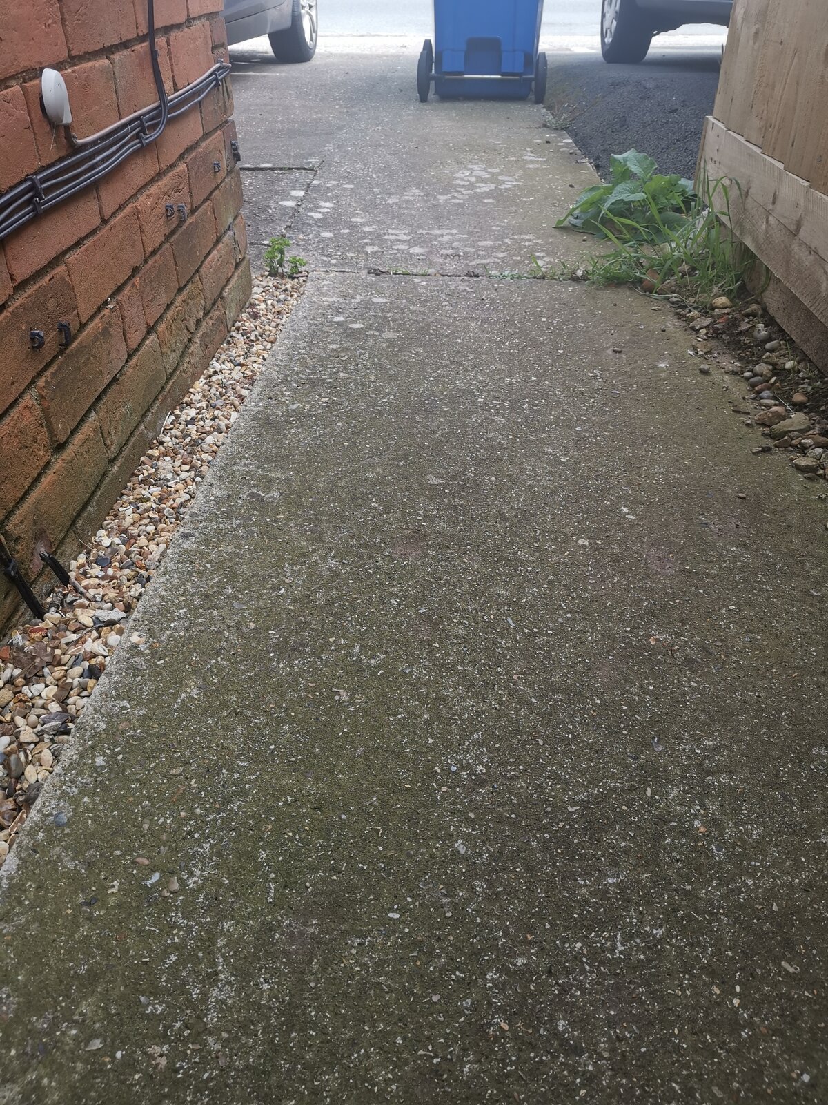

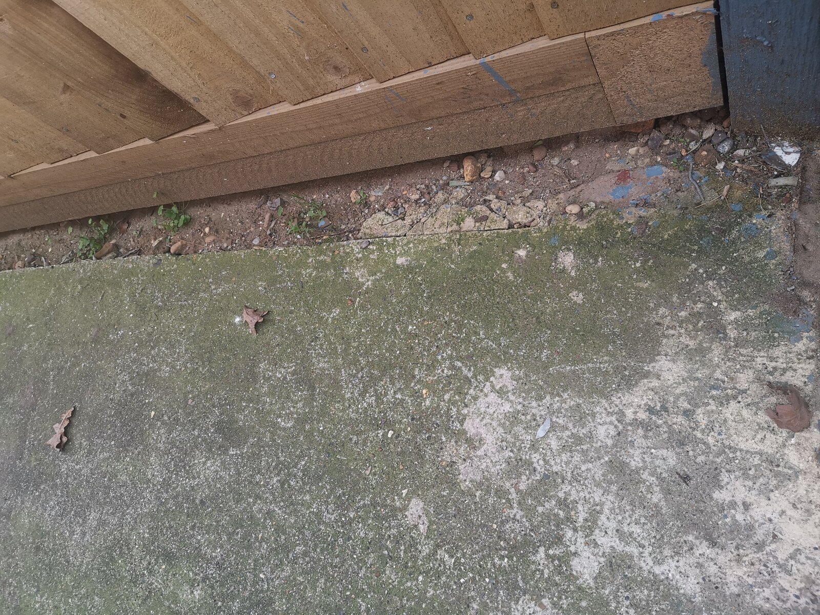

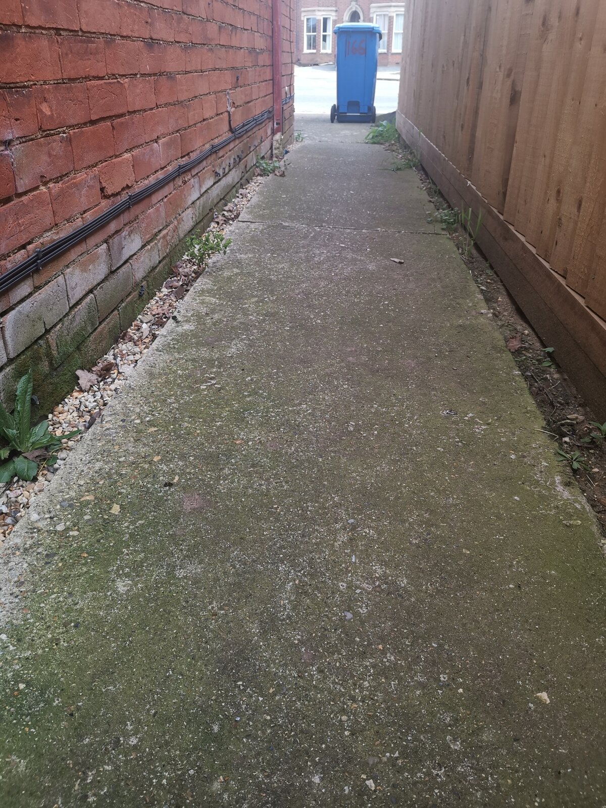

Side surface is like in the pcitrues. It's sami detached house. In the picture left hand side is my house where I have damp and right side is my neighbours raised backyard and driveway can be seen in attached pictures.
Neighbours are nightmare and not helpful.
Is this riased level in neighbours property cause damp in my house?
What are my options?
How can I overcome damp situation?
Please help.
Thank You

I don't see the raised level you refer to, maybe you mean the path slopes towards your wall. Whatever, you need to check where your dpc is in relation to ground floor level, ideally around 150mm above it. And that it is not damaged so as to allow damp in. The gravel should help absorb any run off.
I can see some of the slope of their front drive, and I would think it depends on the slope of the rest of the drive. I would expect it to mainly drain toward the road, rather than your driveway. If that is not the case, and there is excessive water draining on to your driveway, I suggest you contact the appropriate department of your local auhtority. I understand it's an offence to drain one's surface water towards a neighbour's property.
It would epend on the amount of surface water concerned.
Basically., all of the above refers to the slope of their backyard. It all depends on the amount of surface water concerned, and the direction of the slope of their ground level.
As above.
I cannot see anything wrong that your neighbour has done. The pathway looks pretty old.
Again, as above, bricks below the damp proof course will be wet regardless of what your neighbour has done with their garden.
