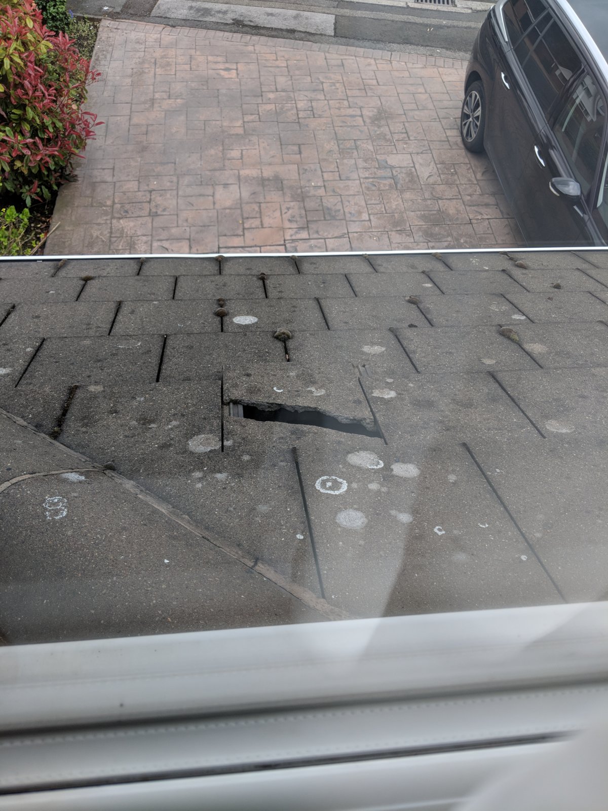

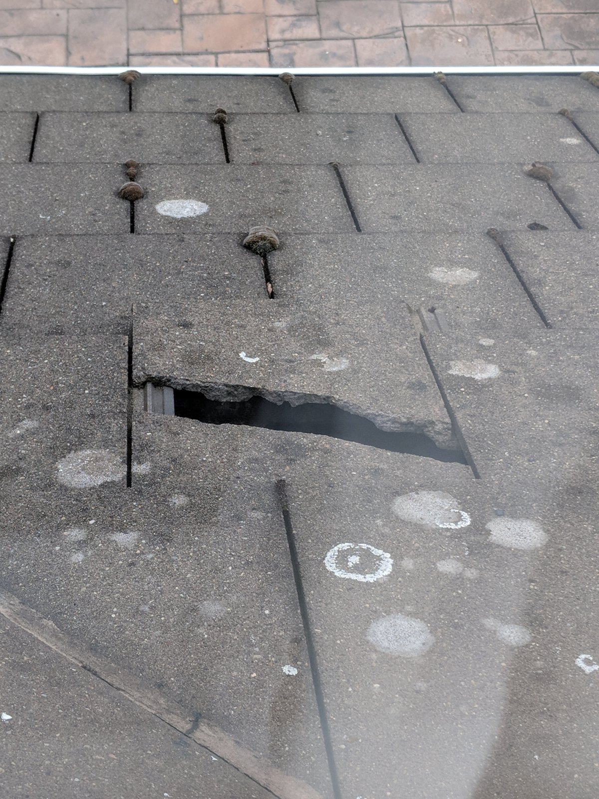

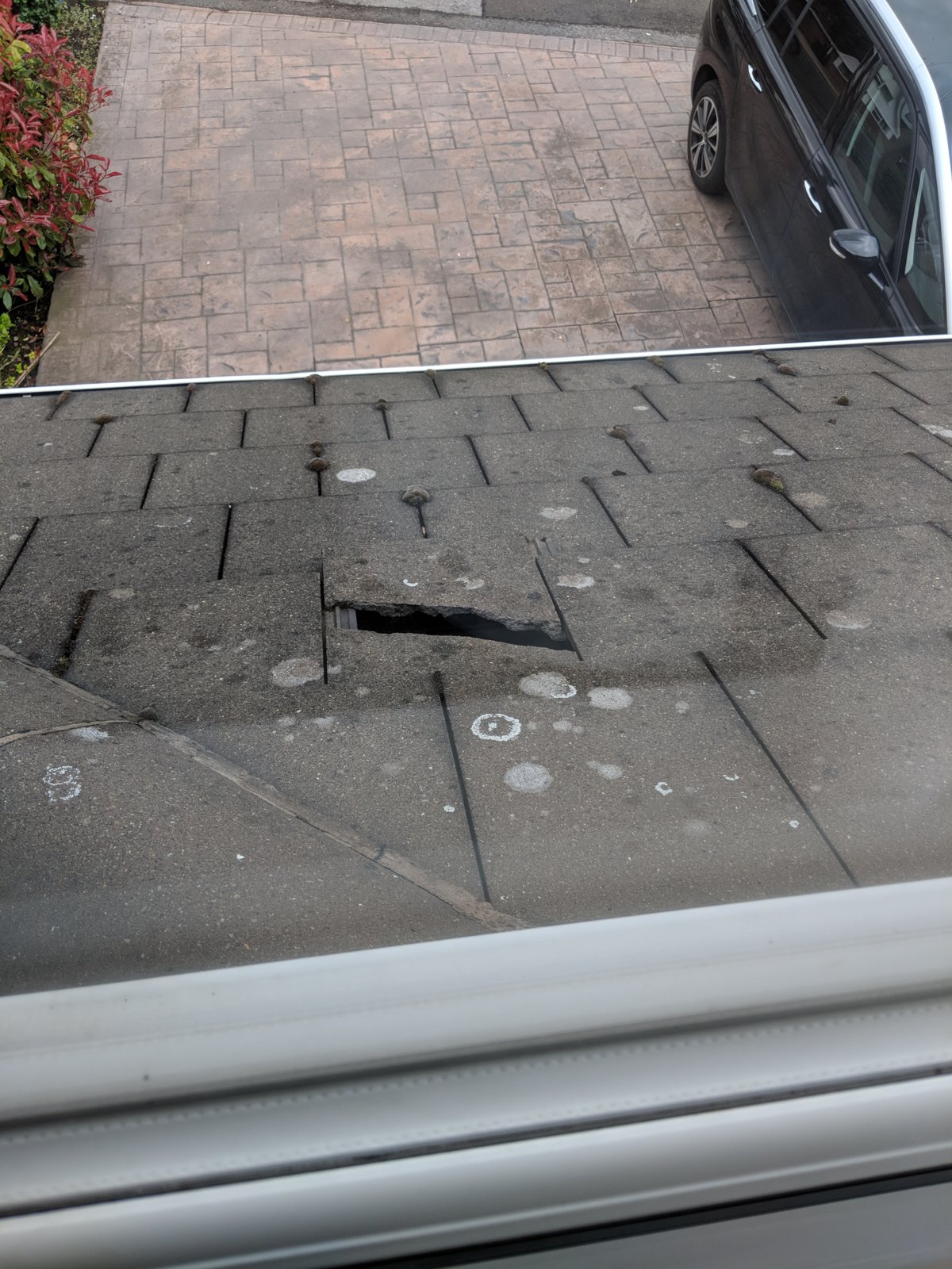

I need to replace 1 roof tile
is this a Marley Modern tile? are they all one size?
Please see attached
also to fit do i just slot it in?
Thanks!

I think it’s a modern. The roof tilers on here will know. Yeah just slide up the one behind it to make it easier to fit the replacement in.
modern, all same size
Slide up the two tiles above the damaged one
take out the bits
drop in new tile
pull tiles back down into their original position , a trowel might help here.
Hell have a job, there's a mortared hip above.
You may have better success removing the neighbouring tile and slide your new one in sideways. Otherwise you may have to remove a couple of ridge.
Are they deffo not (Russels) Grampians?
the hip Wont interfere.... you push the two that will go up .. Straight forward two min job.
