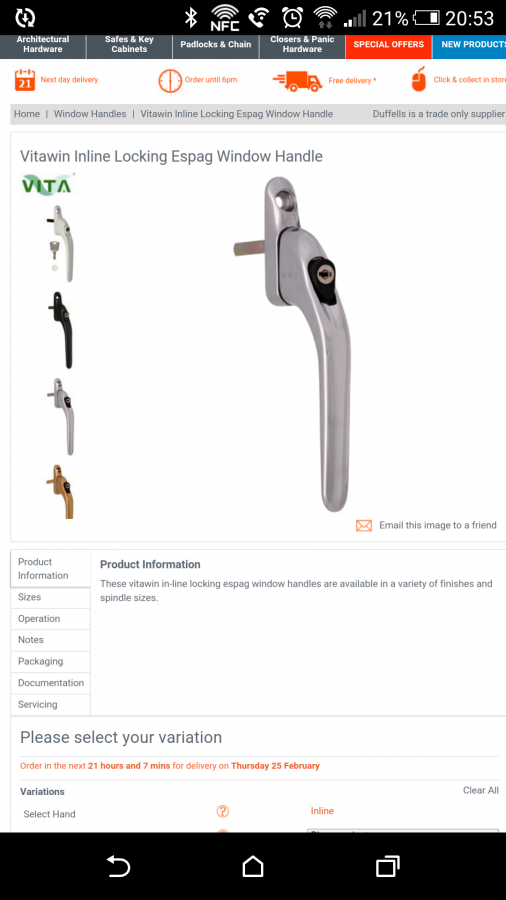

    Thanks guys - looks very similar to the one Rignall posted :)

    Any espag handle will do then if your going to replace them

    Would the Espag key work with it? If I bought just a replacement set of keys?

    Which espag key? Which handle?
    Every different make of handle will have a different key from another make of handle, if you've had a house full of windows all from the same people then all your handles will use the same key. If you've lost all your keys then you'll need to change all your handles unless you can put your hands on one key then match it up using the link I provided but if you have no keys and are looking at changing all the handles then why are you trying to get a match?

    Hi Crank,
    I think you misunderstood me. I don't want to change the handles unless I REALLY have to. I want to buy 2 keys, if I can so that the new buyer has a couple. I am trying to do it as cheap as possible as there is no point sinking more than I have to if I can just find 2 keys (ie replacing 2 keys is cheaper than all the handles in the house).
    What I was told by a UPVC guy, was to send a photo of the handle to find out who made it then buy a key as they are 'universal' to that make... so if they aren't, then that is what I need to know :)

    Send your pictures to dg supplyline in Essex. They will have the keys if still available
