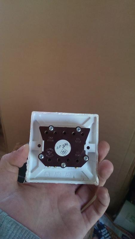

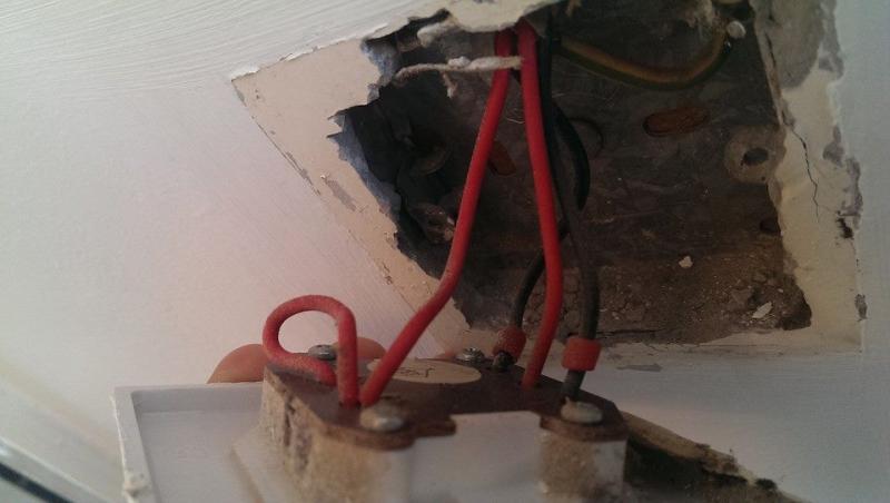

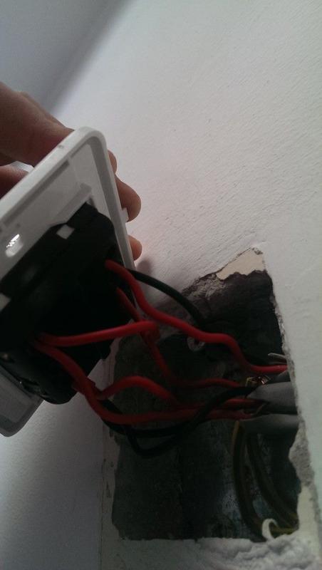

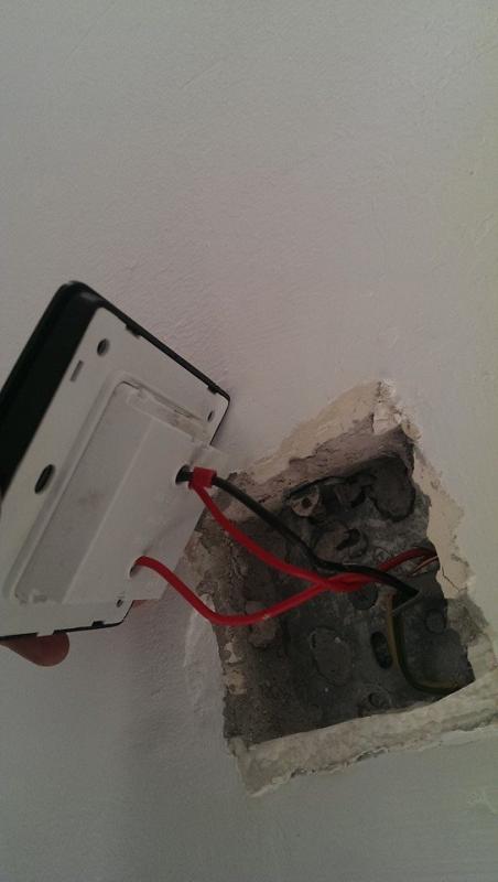

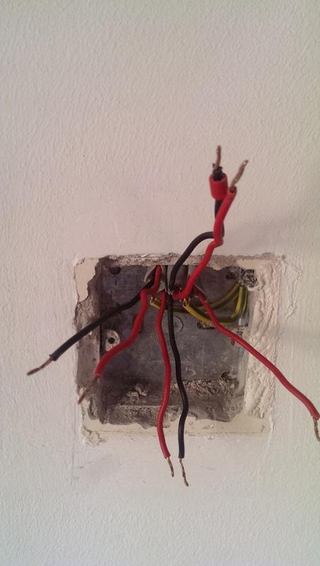

im baffled at to how to wire this switch, iv attatched as may photos as posible hopefully someone can point me in the right direction...
there a 2 hallway lights which are controlled by 2 seperate switches 1 on a 3 gang a 1 on 1 gang.
there is 1 hallway light controlled by 1 switch on the 3 gang and 1 switch on a 2 gang upstairs.
i have attached photos of how 3 gang was previously, previous 3 gang switch terminals, new 3 gang switch terminals and wires in backbox, 1 gang 2 way switch, 2 gang 2 way switch

The black with the red piece around it are your switch lives, which should be wired to the live in the light fitting so when you switch the light on the red (Live) joins to Black (Switched Live)

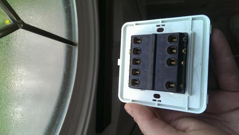

i have tried to wire this up the same and it does not work correctly that is why i started this post have tried a bit of trial and error also but no good.
i have attached a picture of the new switch it has no COM but just L
pics could do with brightness increase or flash using.
Use L as COM.
Did the other lights which were 1 way work ok ?

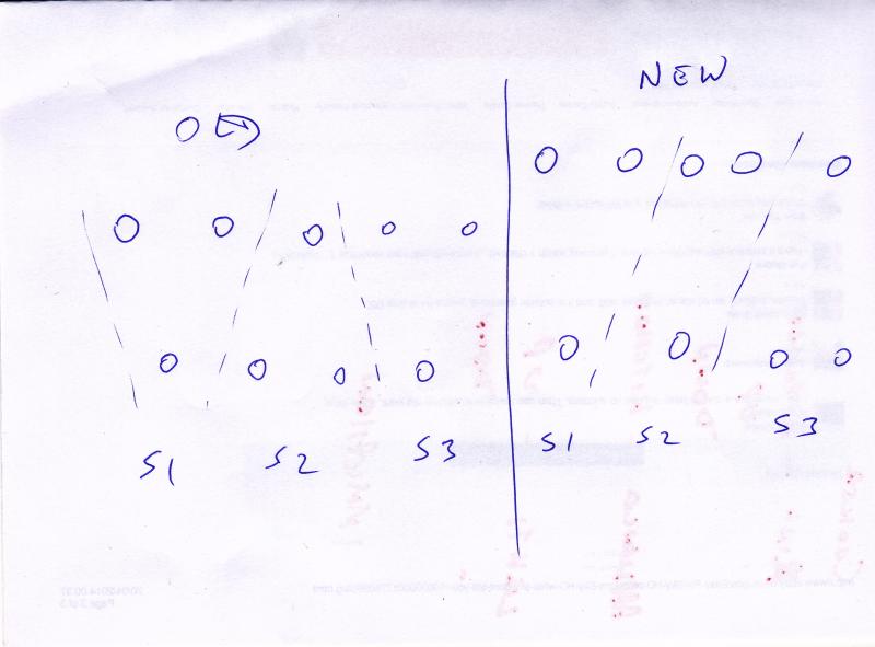

I think I can see why you are having problems.
The two switches are laid out differently. In fact I have never seen such a cock-eyed layout as the new one.!!
The following skectch should help. I cannot see the terminal markings from your pix but hopefully you can work it out from here?
ok so what goes where though because i understood the layout of the terminals but as it happens i have been putting single live to L and bridging over to another L then for twin iv put red L1 black L2? got 2 lights working with the 3 gang but the other switches for the same light dont work it?
am i missing a bridge to the 3rd L? dont see how i could though as there was not 1 there originally
There are many ways that switches can be terminated when a two way function is required, the key things are
*Note down terminal points and mark-up conductors prior to removal/replace
*Familiarize yourself with the corresponding formation of the terminals on the switches
*Failure to do this would then require identifying the permanent live/lives, and the switch lives of each lighting point, some times trial and error is required
*If the above is not possible then electrical testing of the circuit is required
*The above stage would require test equipment that can test for continuity, polarity and voltage, and someone who can perform those tests

2 way switching will always require a wire in the COM or L terminal to work. It's normally a red wire.
If you have run out of wires, yes you could try bridging over another live connection to the COM L terminal and see what happens.
It might work.
Other wise if you do have 3 wires avaiable for the 2 way switch, you probably have the red wires mixed up between L1/L2 and COM L
