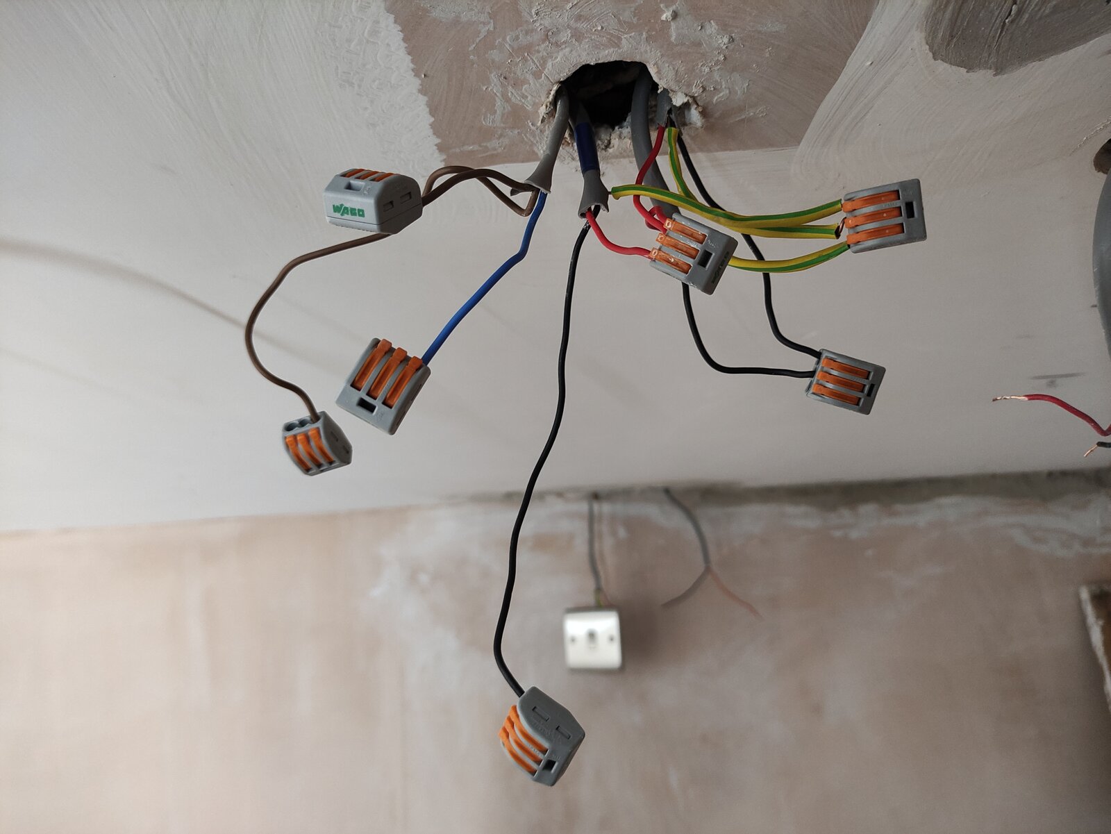

Have attached picture showing current wiring with wagos following your guidance

Have you worked on any other light fittings / switches ?
Your last pic appears to show wires loose to the right side ,and a switch hanging loose ?
Also re check that the wagos are clamping onto copper wires not their insulation.
The switch hanging loose is because I threw away the pullcoard, I just connected the switch so I could do this test to find the switch live.
The plan was to connect to that wire using wagos and a new wire to move the switch to a new location but I've left that for now.
The new lights would be 3 downlights connected to that switch. They were working yesterday but then all of a sudden it all stopped working and have been messaging on here since.
Thankfully the earth wires are now longer showing live.
I shall double check the wago connections on the wires now but they all seemed like they were fully clamped in, should the copper be quite exposed for the wagos?
Yes ,around 10 mm of copper should be stripped to go into wago.

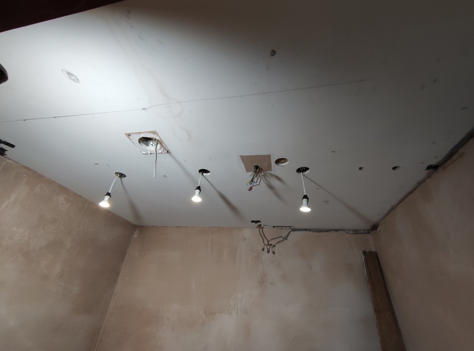

Okay apologies, so the room used to be a bathroom and we've had the wall knocked out to join the kitchen
The main bathroom light and extractor fan have been removed along with the pull cord light switch
The main light had 3 spotlights on it and a transformer I think. I didn't take a picture of how this was wired when I removed it. The kitchen lights wouldn't work after removing this.
Since removing it I had a fiddle with the wires by connecting them with wagos and managed to get the circuit back up and running, this was the first picture I sent through. I started to prepare the new downlights as previously mentioned but randomly the kitchen lights then stopped working so I stopped.
Picture of the downlights working attached.
I have since abandoned this as the kitchen lights are more important.
