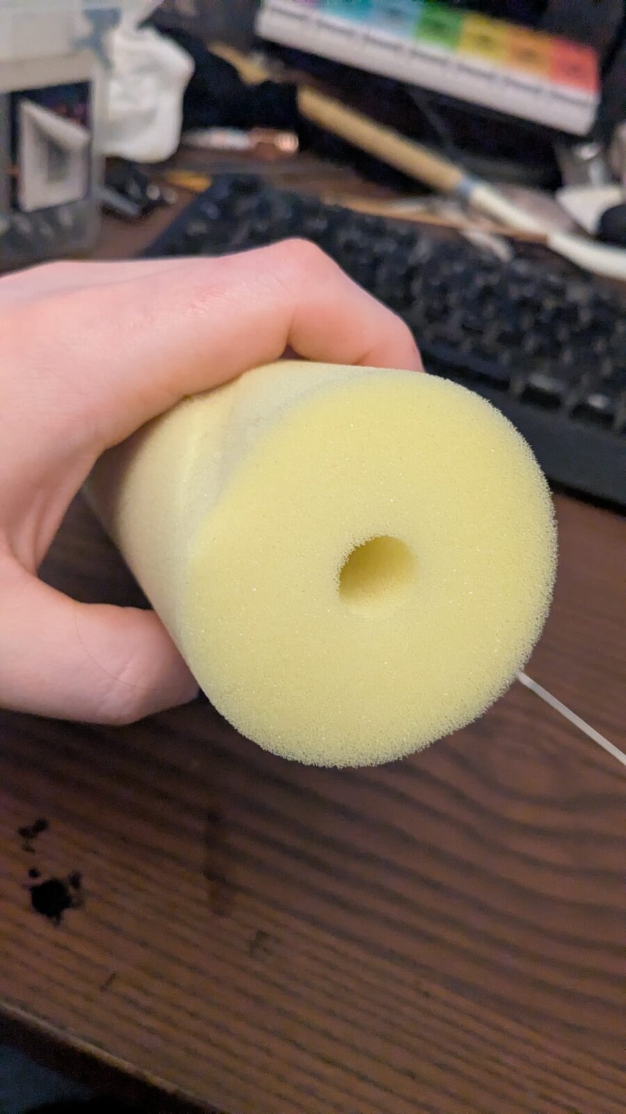

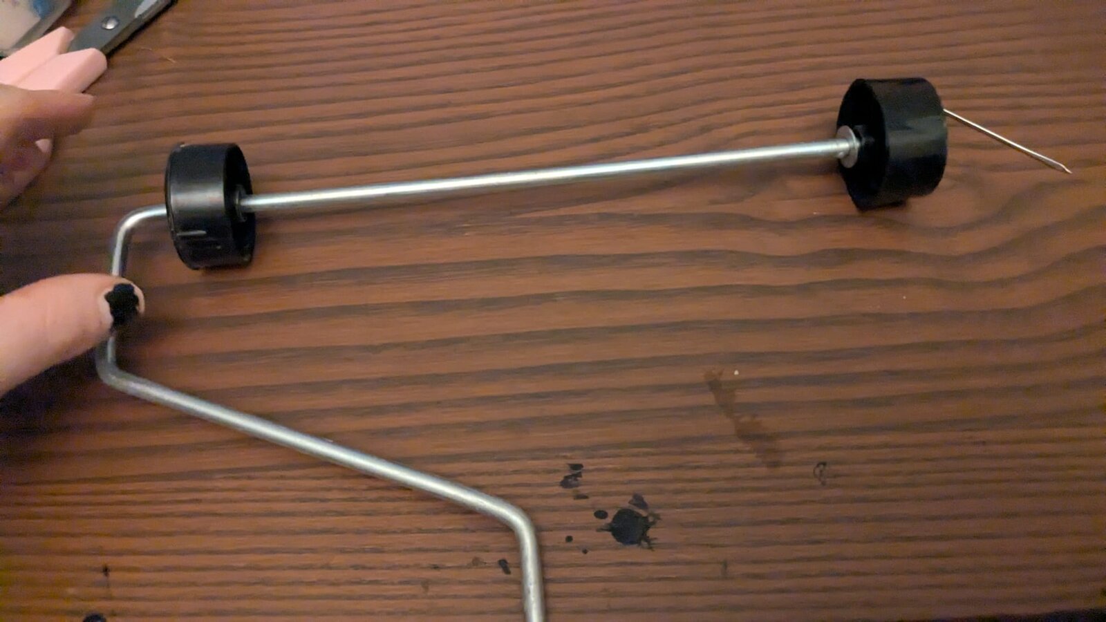

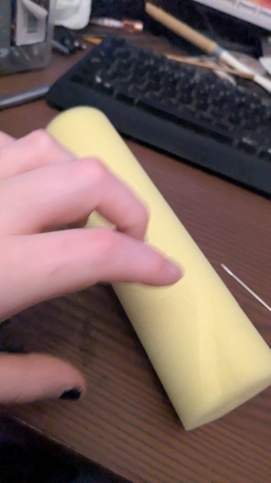

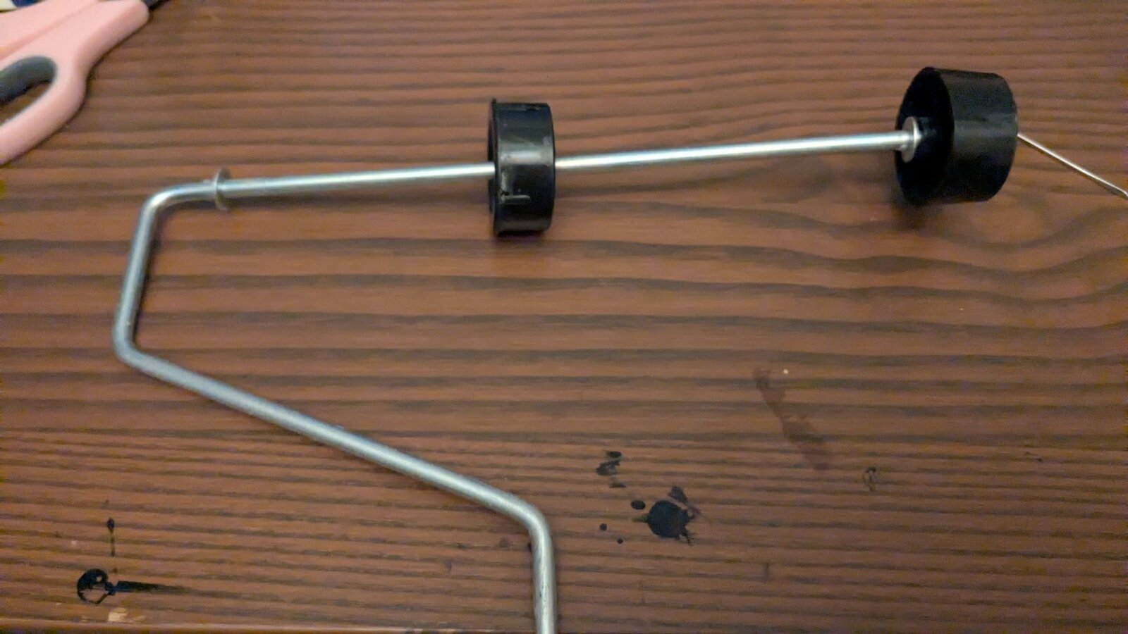

i have been silly in past months, buying tons of paint rollers and frames sort of at random, because i falsely assumed it would be all standardised, now i have several 9 (226mm) inch parts that don't fit together
i have these foam rollers, and no frame that fits them. External diameter 57mm, diameter of inner hole is 12mm
completely foam, soft, no hard parts
and i have frames like this, diameter of the end caps is 37mm, one of them slides along the rail
I'd like to first find a frame for the rollers, because i have quite a few of them and they are currently useless
and i'd also like to know how to find rollers compatible with the other frame
are there any standards or proper names for this stuff? what should i search for

Your roller frame in image 1 is an extremely cheap one.
They are horrible. They flex whilst you roll and if you decide to use an extension pole, you can only use one with a push fit bayonet. I have seen the frame fall of poles in the past and if they don't fall off, sometimes they twist whilst you are working
Additionally, they only accept 1.5" diameter (internal) roller sleeves.
Pro versions use 1.75" sleeves and the frame is often screw based (when connected to a poll).
You can get a 9" Purdy frame and Colossus sleeve for just over £20. My advice would be to bin the foam roller sleeves that you have. I have been a professional decorator for over 30 years. I have never understood why anyone would buy one. The only reason that I can think of is to apply wood stain, which is so thin that the air bubbles in the finish burst immediately. They are not suitable for emulsion.
