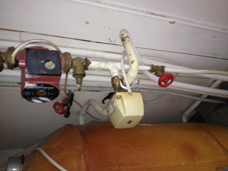

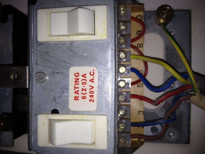

is this a fully pumped system or gravity fed

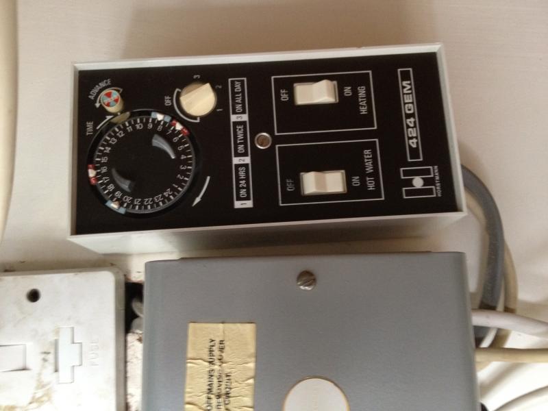

I am wanting to fit a new digital time clock to control heating and hot water
many thanks

from the picture I would say it was fully pumped

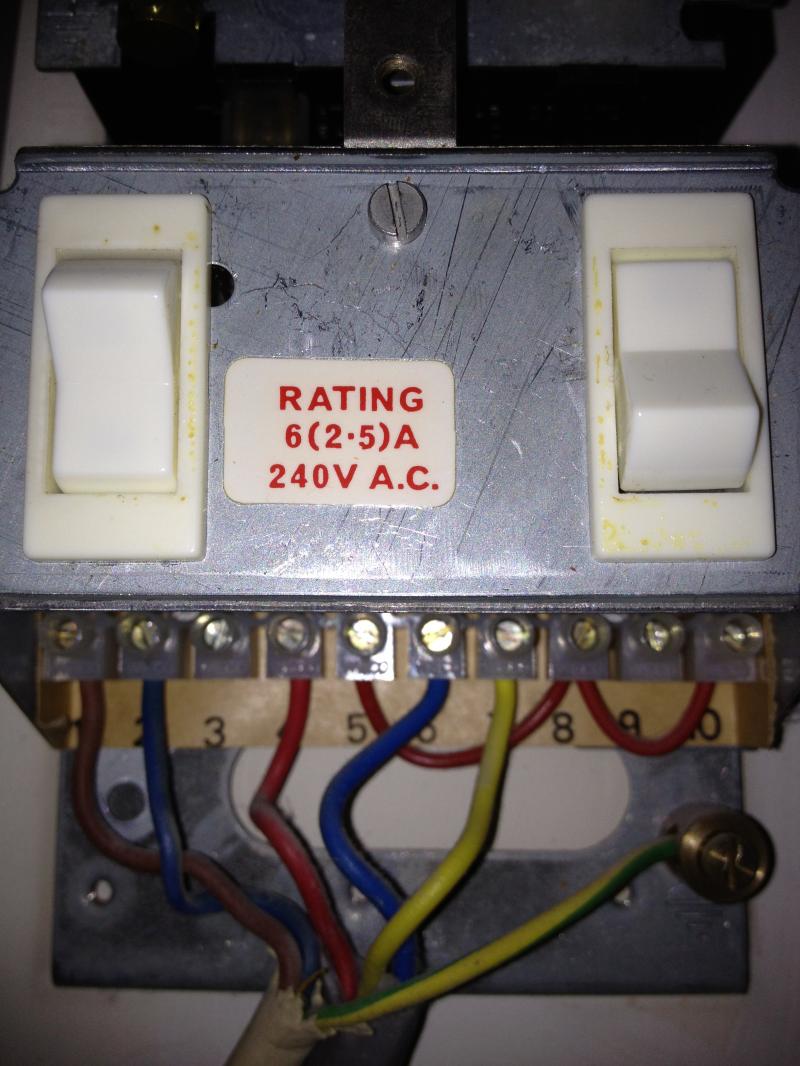

To put a new timer in the you only need to swap the old time clock wires into the new one.
From what i can make out
L-R
1)Brown=Live
2)Blue=neutral
4)Red=HW on
6)Blue=HW off
7)Yellow=heating on
The 2 red loops can be disregarded as they were there to link the common lives together, modern timers do this internally.
There also appears to be a link missing between 1+5 but it doesnt matter.
cheers for that i have wired that way but it won't allow me to control water on it's own. I can only set program with central heating and hot water. I can use the boost button to give 1 hour of hot water?
any ideas?
