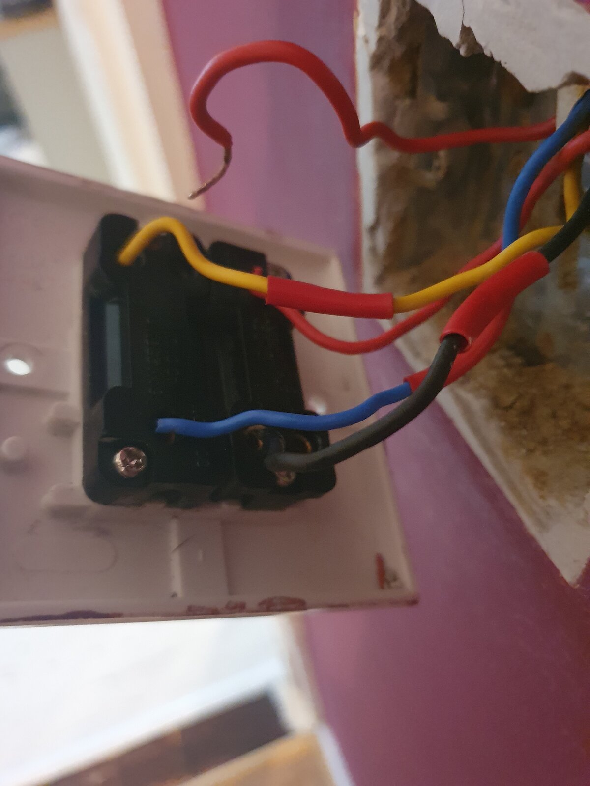

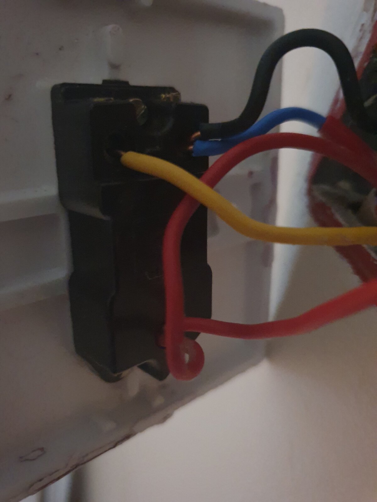

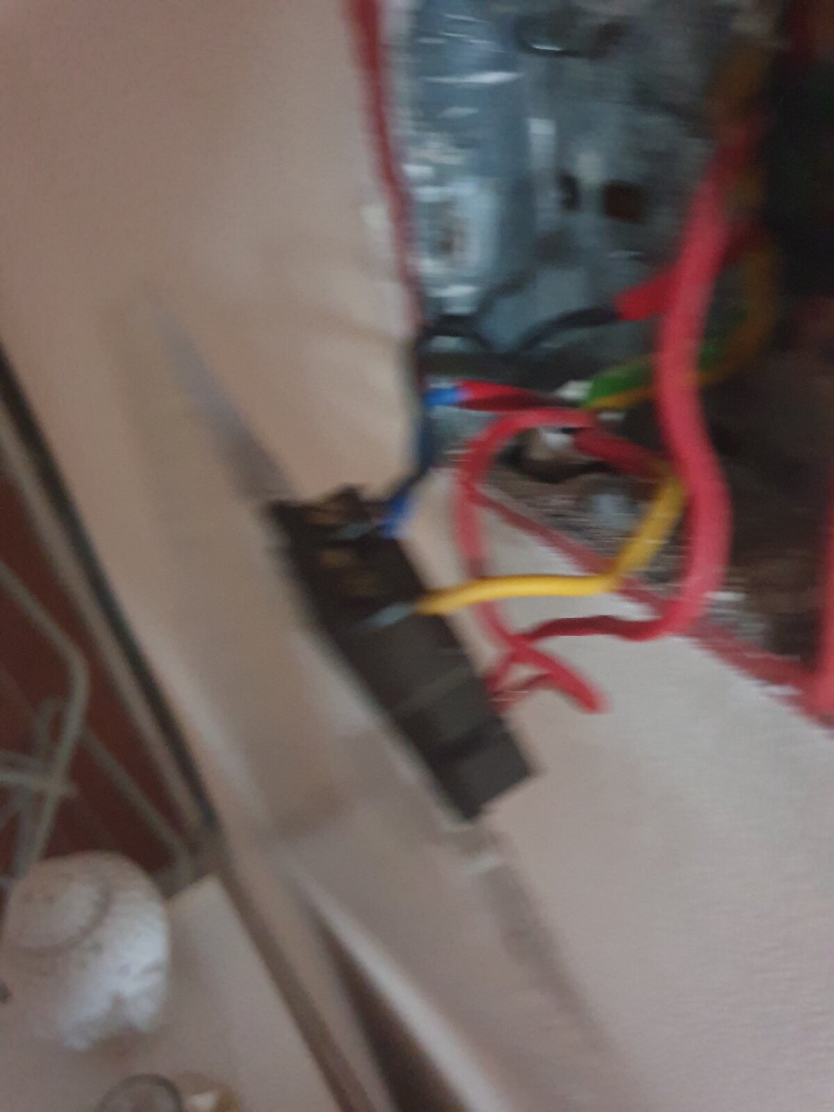

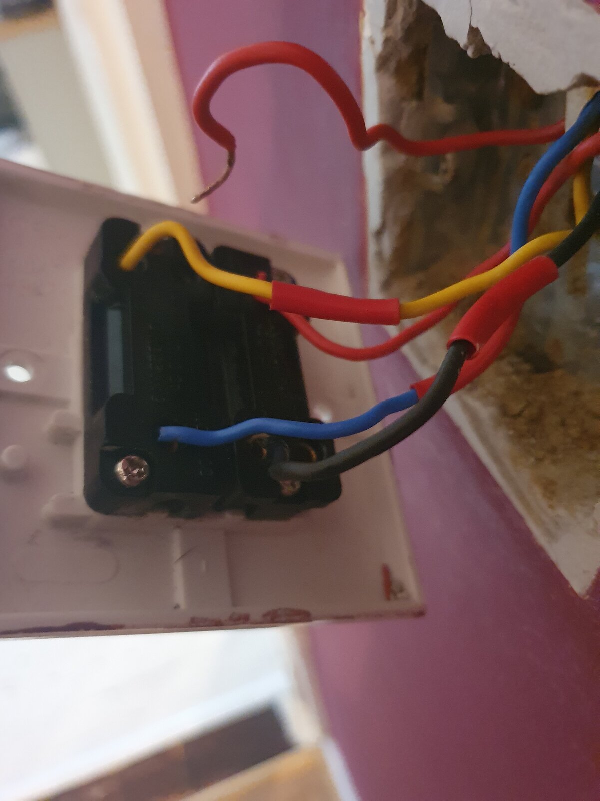

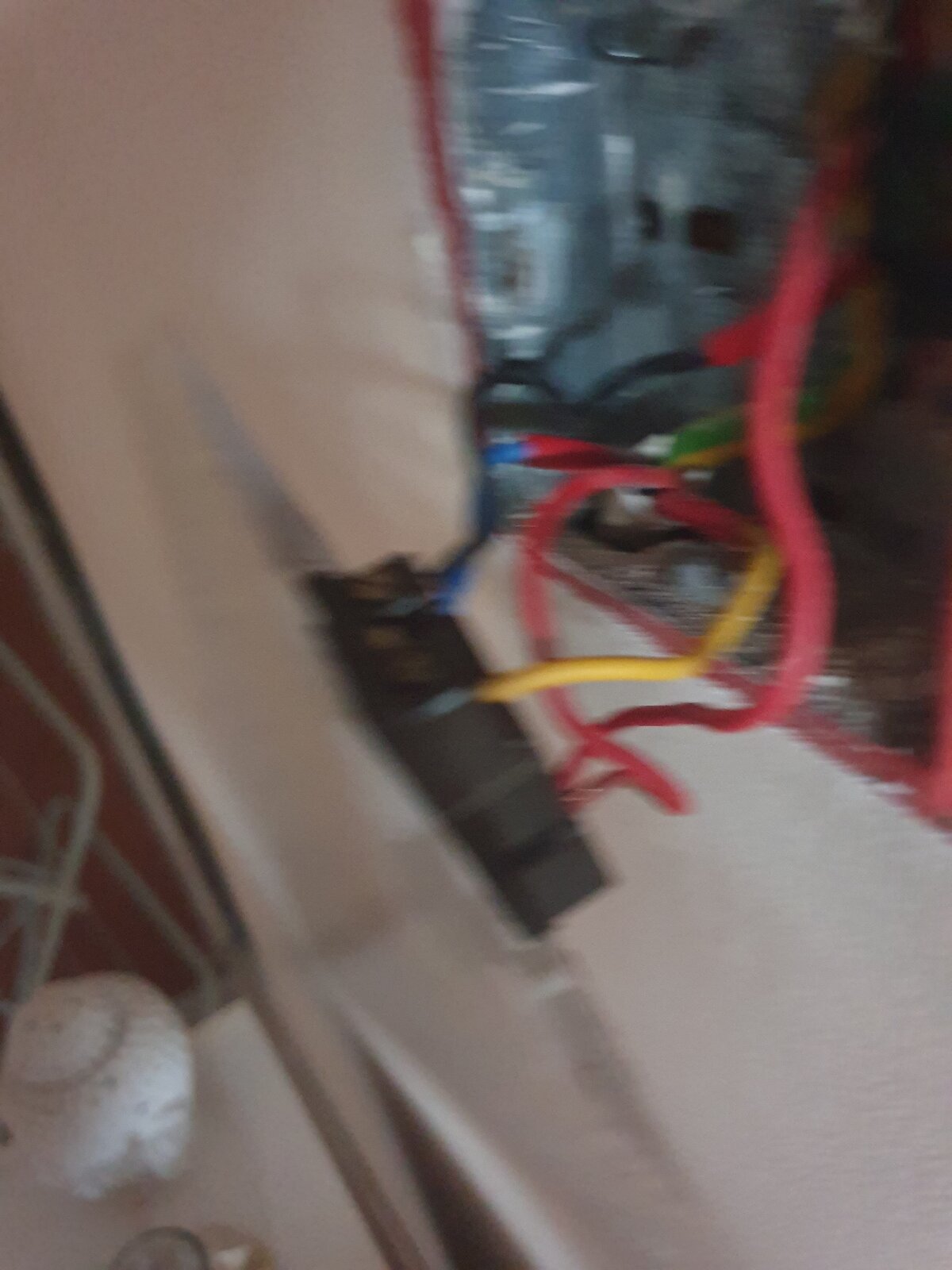

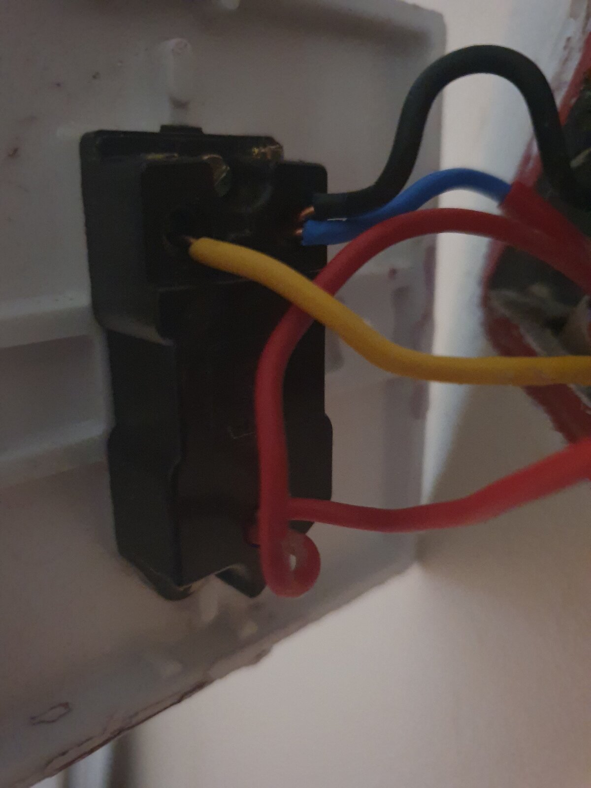

I've got a 2way switch downstairs that does the kitchen and dining room... and does the landing light as well... like a idiot I forgot to take pictures before I replaced the switch... no I'm totally lost as how to rewire it back up... one cable has red blue and yellow and one cable has just red and black... 20210919_180846.jpg20210919_180827.jpg any help would be greatly appreciated

does this help
showing the old wire colours - just post back colours and the code on terminals - COM/L1/L2/etc
http://www.lightwiring.co.uk/two-way-switching-3-wire-system-old-cable-colours/
They can use any of the colours - so may not be the same way
looks like the yellow maybe the `com in your case - BUT check
So the upstairs light has
Yellow COM
and then BLUE in L1 or L2 and also with a black wire from the 2nd cable
and then the RED in L2 or L1 and also a red wire from the 2nd cable
if so then on your NEW switch
you just need to use the same colours in the COM, L1 and L2
Then the 2nd cable will be for the other light - diningrm
and that would be just
com to L1 or L2
only issue will be the switch may work the other way round , so just change the L1 to L2 or if you used L2 then L2 to L1
sometimes new switches dont have the COM marked as COM
so post back what you have

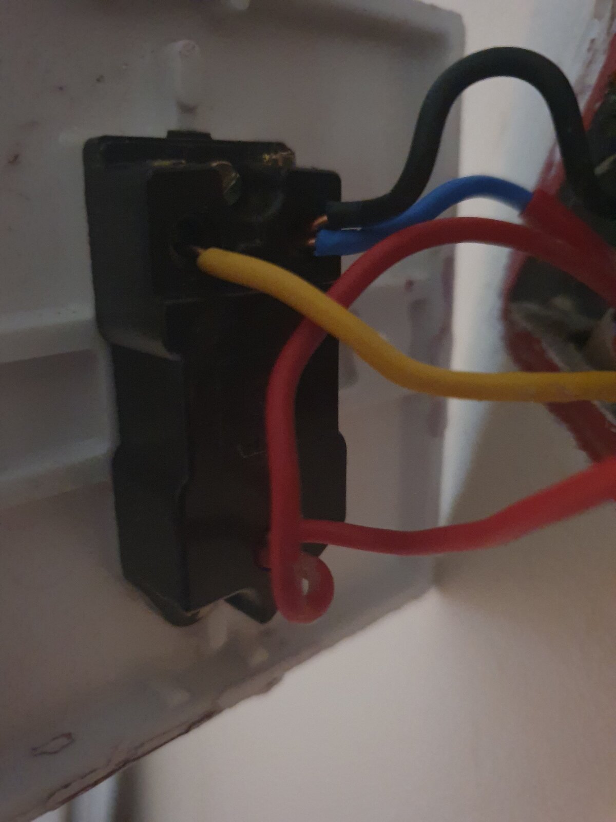

View attachment 244530 this is the upstairs switch....
Upstairs
So out of the grey sheath are a red and black wires. Put one in the top left and one in the top right. Doesn't matter which way round.
Then the 3 core &e cable red/yellow/blue.
Put red is the same top terminal as the other red.
Put yellow is the same top terminal as the black
Put blue in the bottom COM terminal.
Then downstairs, put the red into that empty top terminal.
The important thing is the the COM terminal has the same coloured wire both ends, and no additional wires.
