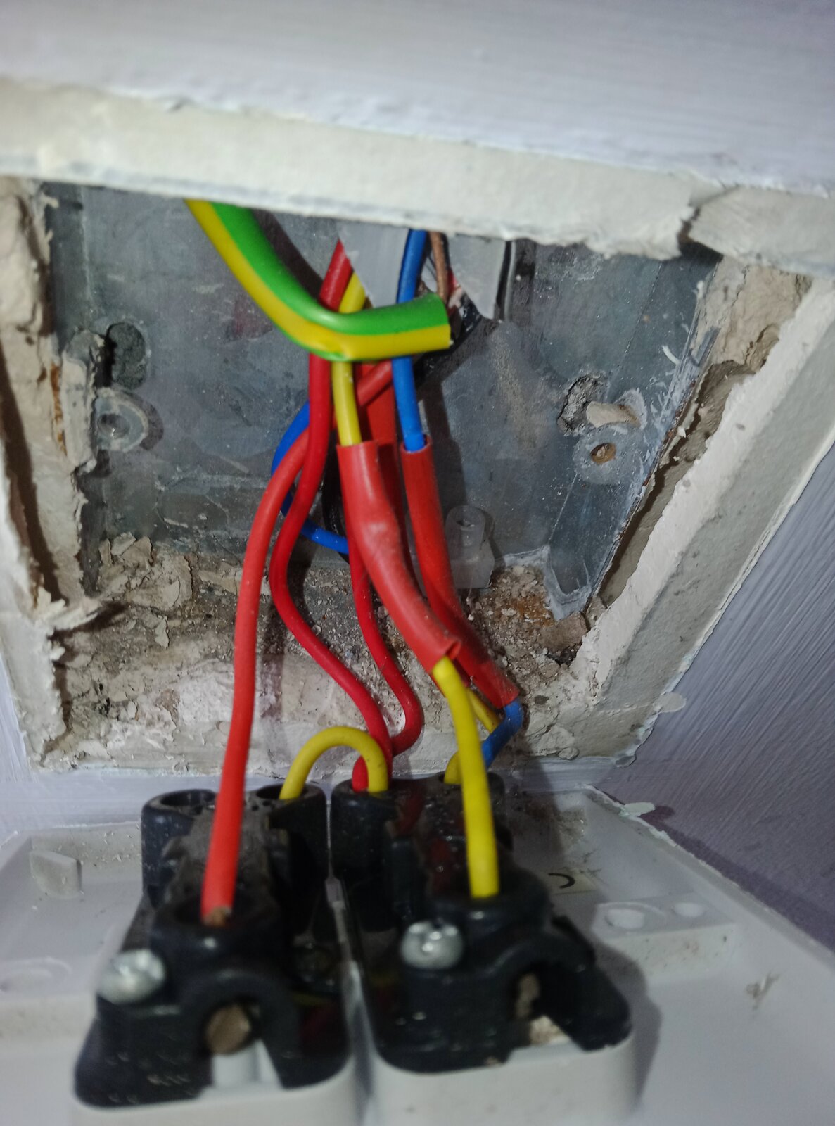

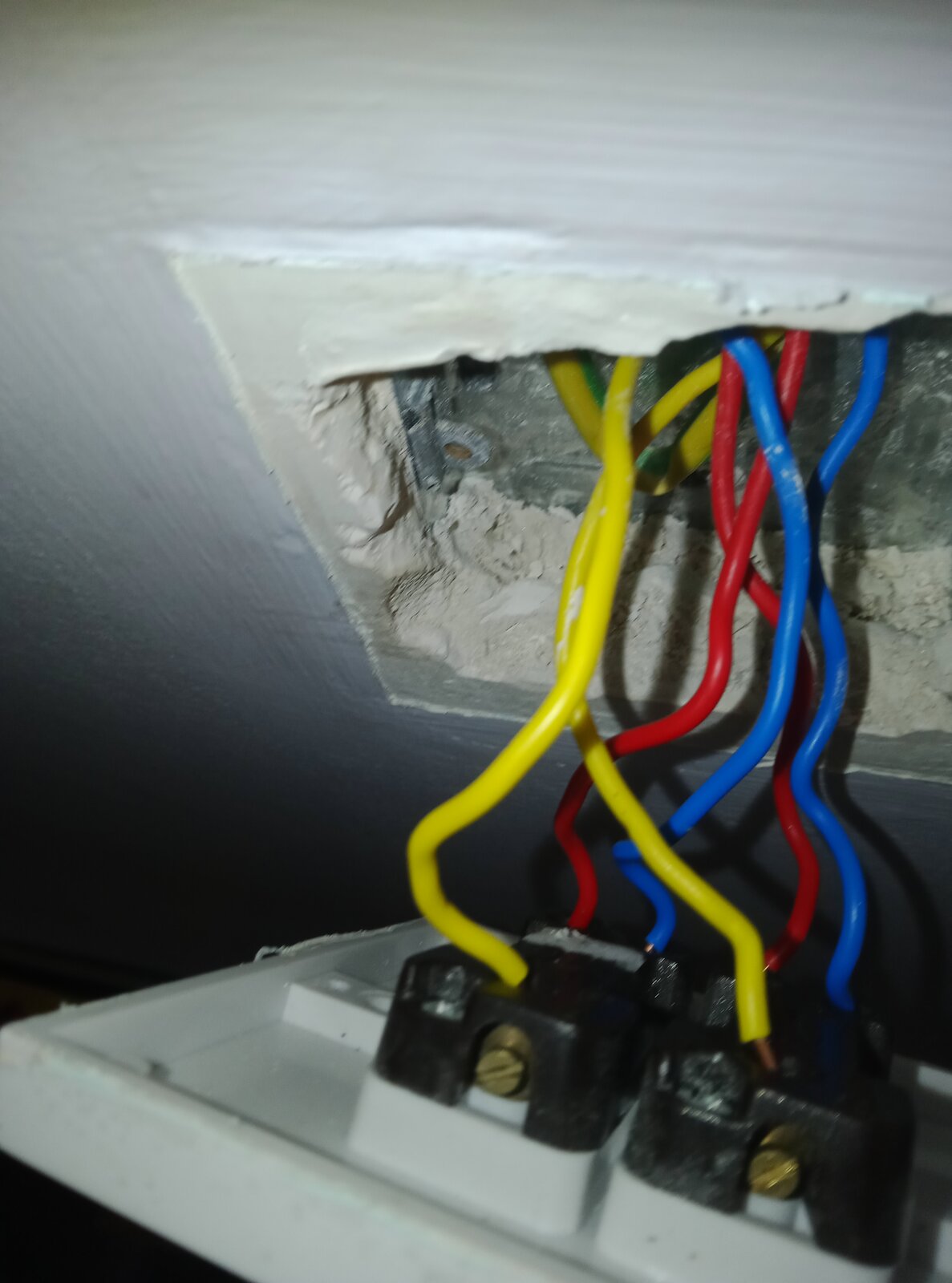

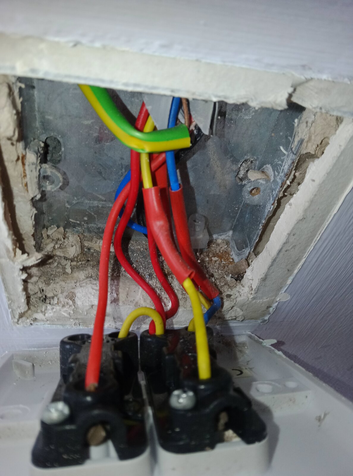

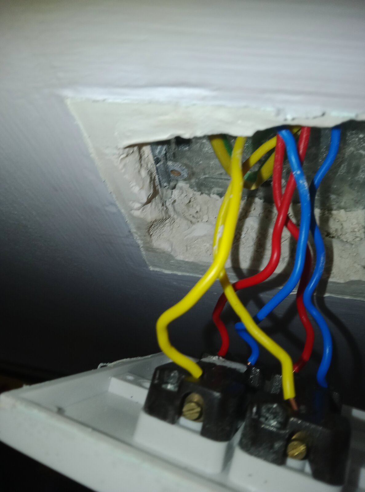

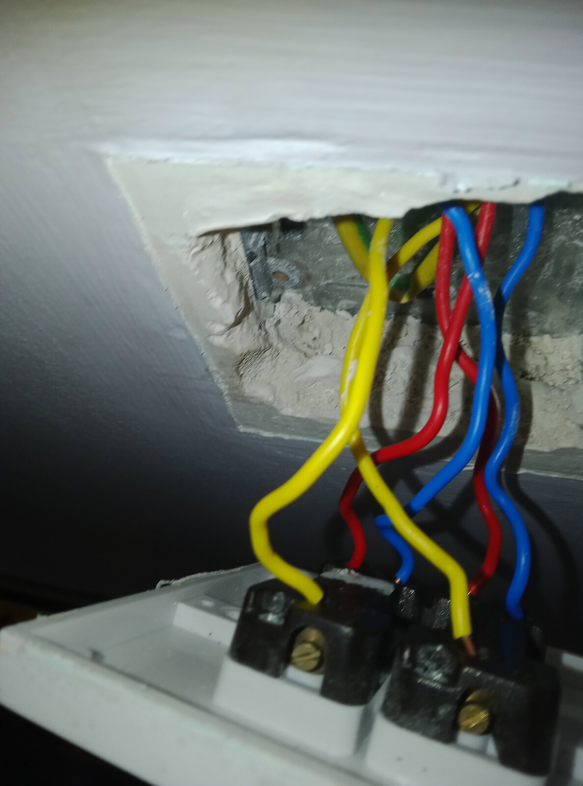

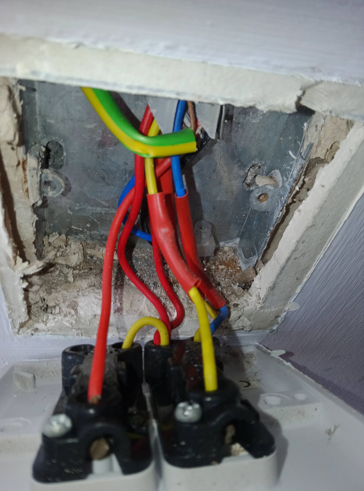

Hi, I'm trying to install 2way and 1 way smart touch light switches, but the the house is fitted with 3 core cable in the 2way switches with UK common cables being yellow I'm lost how to wire this type of cable to 2 way switches can someone tell me how to wire the switch using this setup of common yellow cable and sleeved red yellow cable please. Both pictures attached are based in a hall
Pic 1 non red sleeved controls hall and landing light
Pic 2 sleeved controls hall and outside light
Id like to have a 2 way switch fitted to each

You don't have a neutral wire at that switch position. Your smart switch requires a Neutral connection so it can't be fitted there.

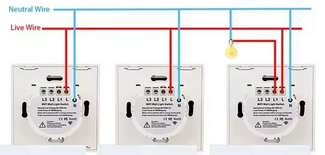

Each smart switch has its own wiring diagram, often sold in pairs
in this case the one with LED's is master, the single switch is the slave. Again for one shown this 1739710162975.png is the wiring diagram. However, with a smart switch, there is no need for two-way switching, by using a remote, the button shown here

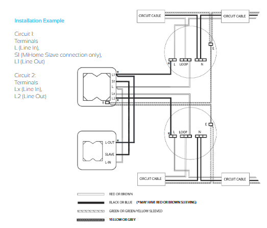

also they use only one feed, which is the same with the TP-Link (Tapo) switch, one needs to be careful with landing lights, as often a two gang switch has two feeds from two independent circuits, which must be kept independent, or it will trip any RCBO's fitted.
Picture ending 221 of yours shows two slave switches, picture ending 611 shows a master two-way, and an on/off switch. So likely the 1739710525740.png smart switch would replace the switch shown in picture 611, I have a mixture, smart switches both Energenie and Tapo the latter replacing failed Energenie which to be fair are around 8 years old. But I also have a smart relay in my landing lamp lamp-landing_1.jpg it allows me to have 1, 4, or 5 lights on, the centre one is a smart colour changing one. And also a load of smart bulbs, with a smart bulb, turning the light switch off/on will turn it on, but clearly if switch left off, smart commands don't work, but hey google turn on outside lights will turn on all 6 outside lamps, very handy, as not even connected to the same abode, some supplied from flat, and some main house.

If you want an easy life then forget it.
It is possible, but it takes a lot of time and understanding. You need to learn how lighting circuits work, how 2-way switching is configured and identify the correct products for the job - many smart switches just cannot provide 2-way switching. You may need a specialist product, such as Litewave, and be prepared to undertake some additional and/or reconfiguration of the existing cabling.

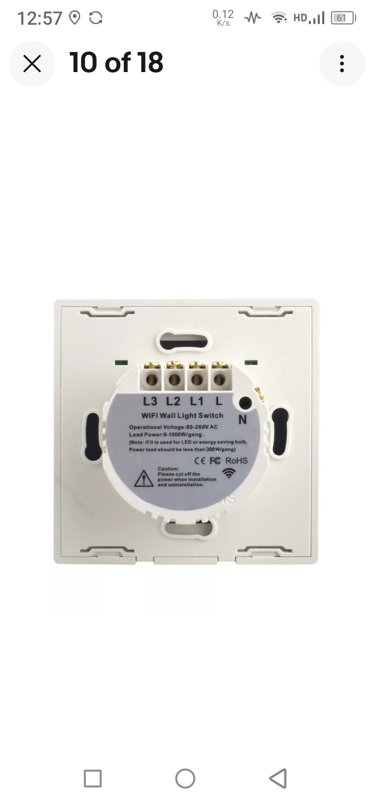

Hi how do I wire this switch (the one showing terminals.)
Brand is tuya 2 gang
The wiring Is as follows
Yellow = common
Red = L1
Blue = L2

The new switch needs a neutral and you don't have one so I dont think you can.
