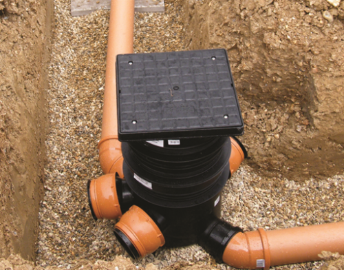

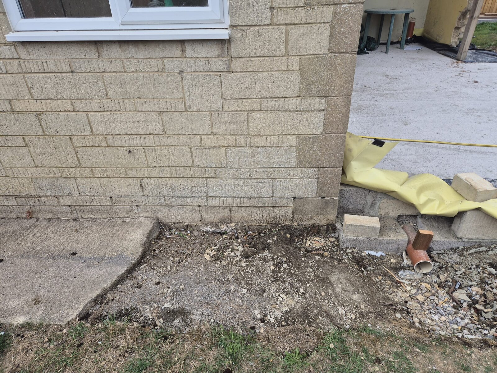

Hi
I have a 110mm pipe coming out from my half done extension that is only 8cm under the level of the intended patio (from the top of the pipe). The 110mm will carry kitchen sink and dishwasher waste via a standard 40mm waste pipe through a hole under the window.
I was going to fit this inspection chamber tomorrow with a roddable bottle gully but the inspection chamber would stick well above the intended patio and the gully is so deep it would be going uphill to the inspection chamber.
I then looked at a hopper and a p-trap which is shallower than the bottle gully at only 5cm from grid to top of outlet pipe, but i would still have inspection chamber well above patio.
I found a 3 inlet inspection chamber at Travis Perkins (I can't find on their website but it is like this) that i can cut down. It has a lid which would stand 10cm above the inlet pipe. This is the narrowest I could find, and i could use with the ptrap and hopper but would require a big bend radius pipe as the inlets are on the back.
Has anybody got any other ideas please? I really after a very slim inspection chamber including lid with a left side 90deg inlet.

Look at 'Level Invert' chambers, these will accept the incoming connection at the same level as the outgoing, which will keep your drain run lower from the chamber. Osma version for your needs is part No. 4D918. May not need a Riser, just drop the cover straight on the base. If you need a gain a bit of height to accommodate the Gully, a concrete Gully surround could allow you to sit the gully slightly higher than the finished patio level.
Provided the Trap fitted to your sink has a suitable seal depth, (75mm), then you can make a direct connection to the drain if preferred.

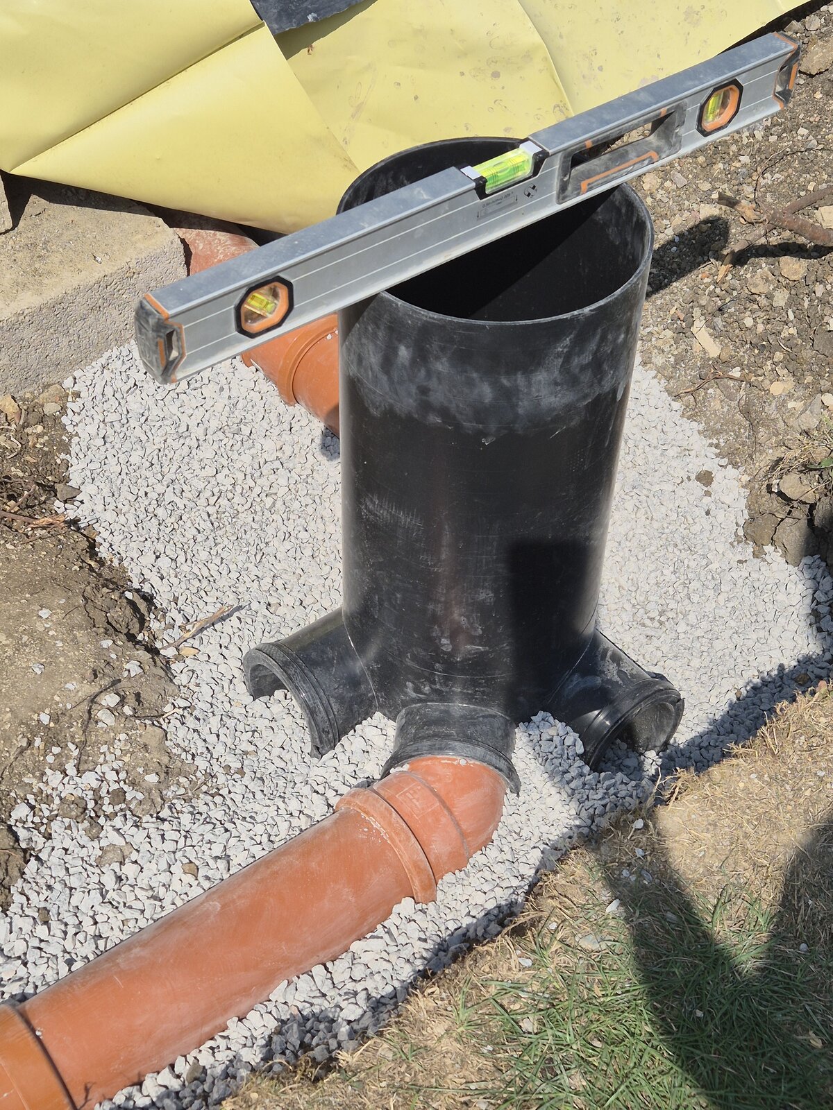

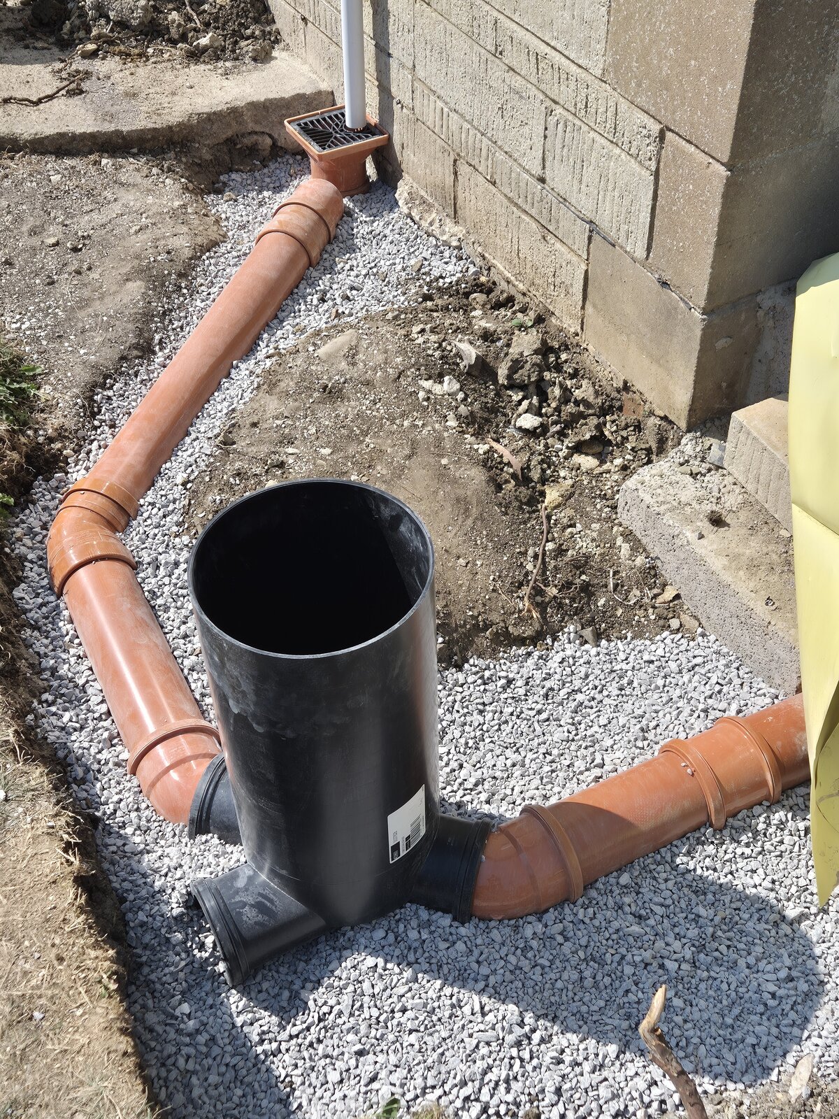

Went with the 4D960 and 4D961, with a Screwfix P-Trap and Hopper.
I need to dig out under the pipe a bit more and then fill with 10mm to support.
Is there a preferred way of concreting/slabbing over the pipe? sand, plastic covering, or just put concrete/muck and slab straight on top?

Can I just ensure you've got the chamber the right way around? Cant quite tell from the photo, (will depend on internal shaping of the through channel).
I would bed and haunch with peagravel, if you are able, although if really shallow then concrete haunching is perhaps the better option to protect the pipework from accidental damage. I'd set the chamber on a bit of semi dry concrete too.

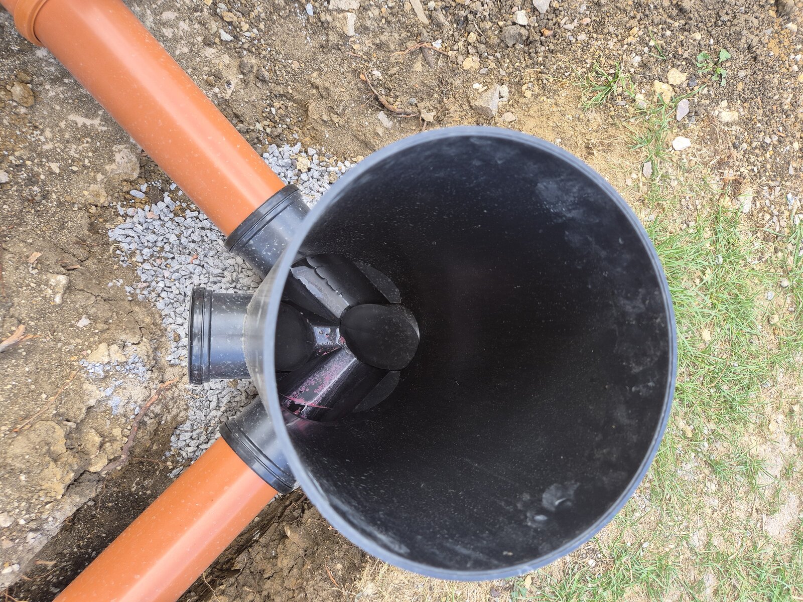

Well yes I was hoping this would be ok. The channels arent that deep in the chamber and the water flows fine.
The three inputs are at 135, 180, 225 deg. Not only would it take me away from the p-trap i would have to use a 90 bend. I thought 45's were easier to rod. I suppose i could use 2 x 45s but thats more joints.....
Take a photo of the chamber, looking in, that'll tell more.
The position of the unused 45 connection raises concern, that should be angled in the direction of flow. Wondering if you've got the wrong handed chamber, there may be Left and Right Handed versions. Although, if you're happy with the flow through, it probably wont be worth worrying about, as long as water/waste isn't holding in the chamber.

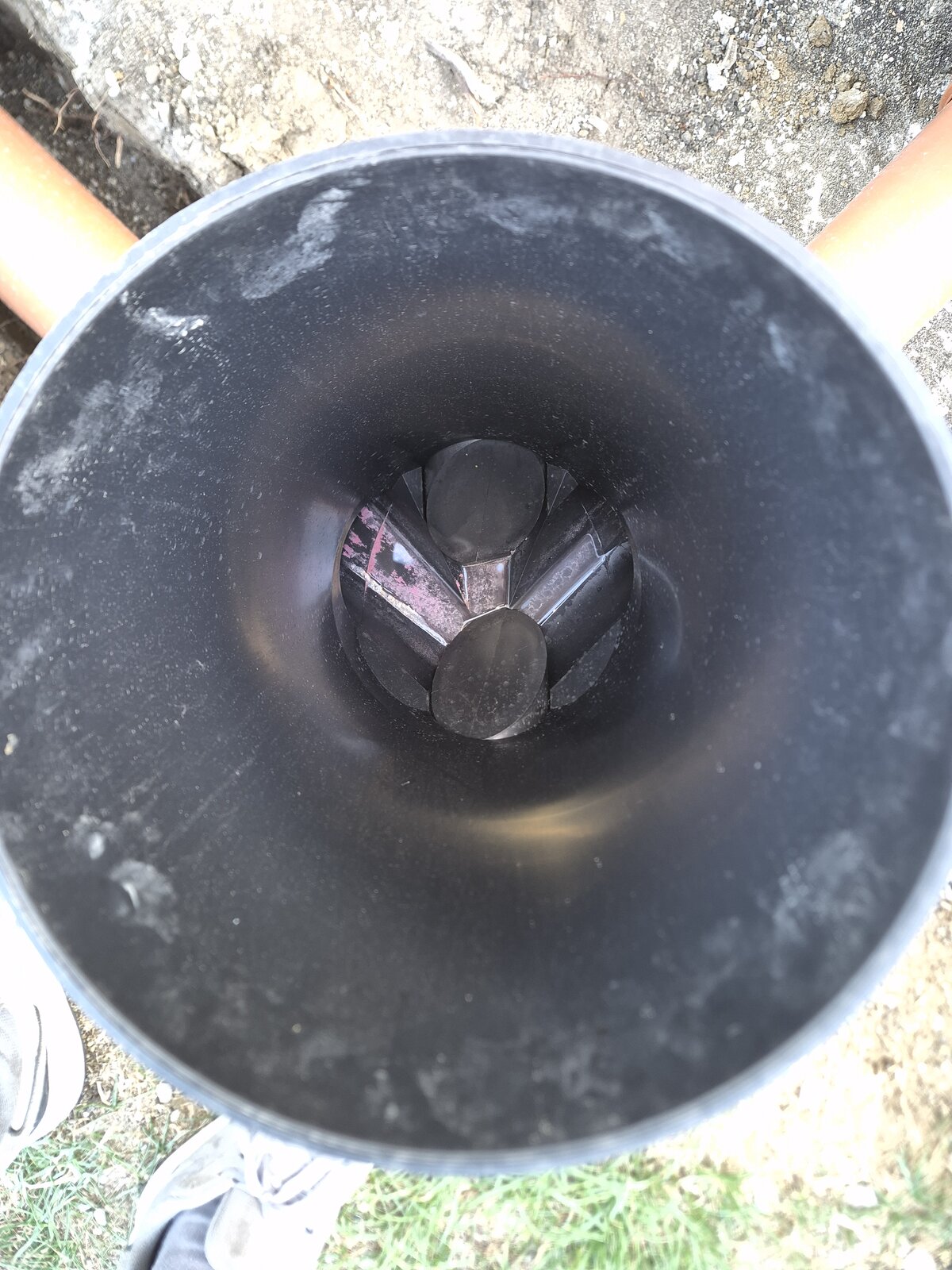

Hi,

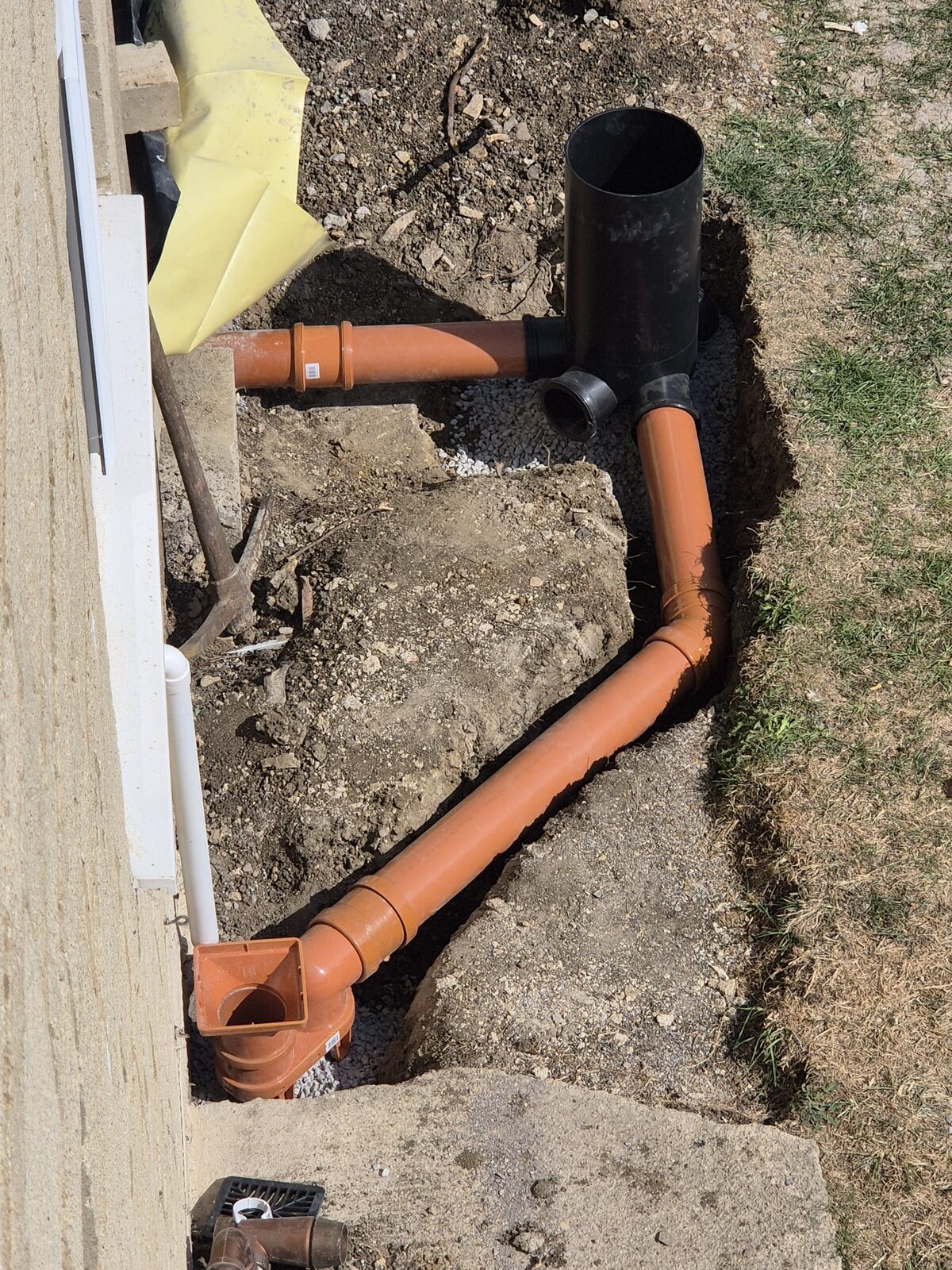

Basically I've turned the chamber around so im using the 145 and 235 inputs.
I need to dig the trench a little deeper under the pipe so waiting for a 1/2 bag of 10mm clean to arrive. Nothing is set in stone yet. Or concrete.
If i need to use the i45 and then a 90 bend connector I will but this was easier and used a 45 pipe connector.

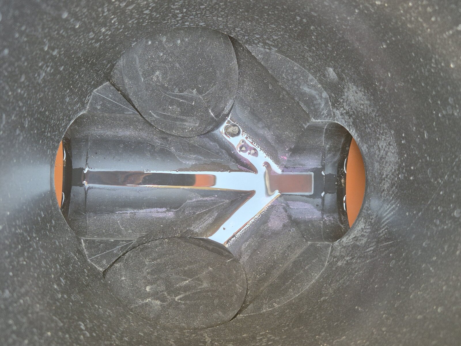

Inside chamber
As I suspected, its the wrong way round. The Outlet is on the right, you've bunged it off, the chamber is designed with a through channel and 2 entries at 45º.
I really would suggest you refit the chamber the right way round, and use either a 45 on the inlet or 2x 22.5º bends one either end of the through channel, to line it up as its designed to be. If the Gully is taking kitchen waste, I can see detritus building up in the chamber over time, and it blocking. The blanking plug is going to collect all the fat, grease and rubbish going, you need a smooth flow through to keep things clean.
Picture as a guide.

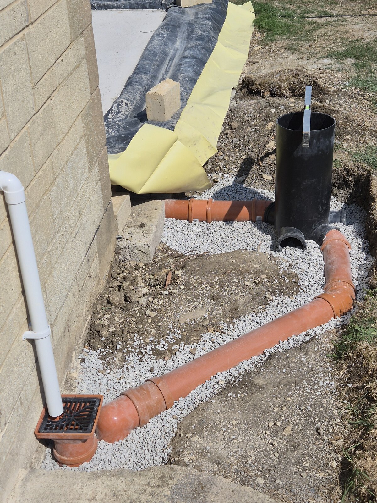

Hi @Hugh Jaleak
Thanks for your advice on this.
Just need to pour some concrete over and stick a few patio slabs on to my desired level.
Cheers

Looking at that last photo you could have gone in the side 45 entry and omitted a bend, sorry I couldn't work out the angles from the initial photo in Post 6 to suggest that, but it doesn't matter now, looks a tidy job, well done.
